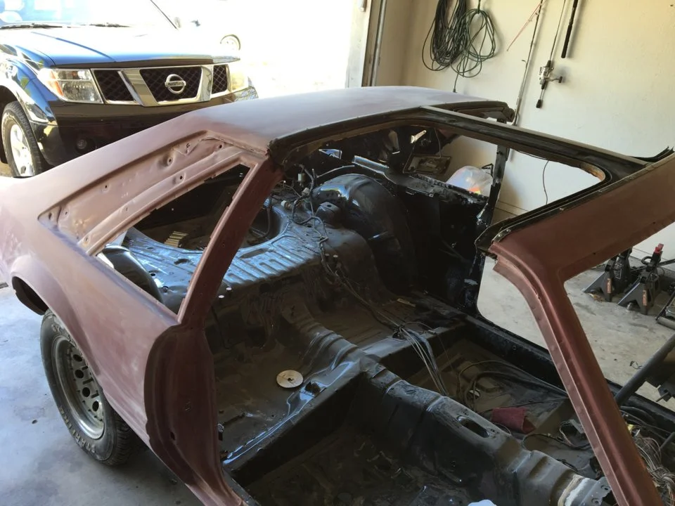

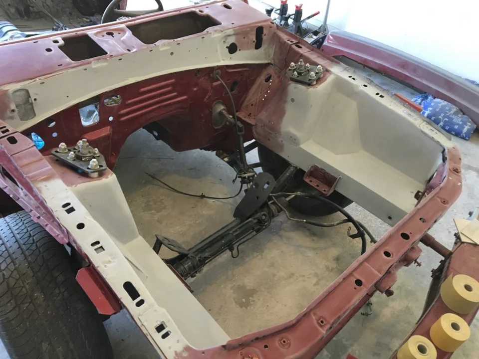

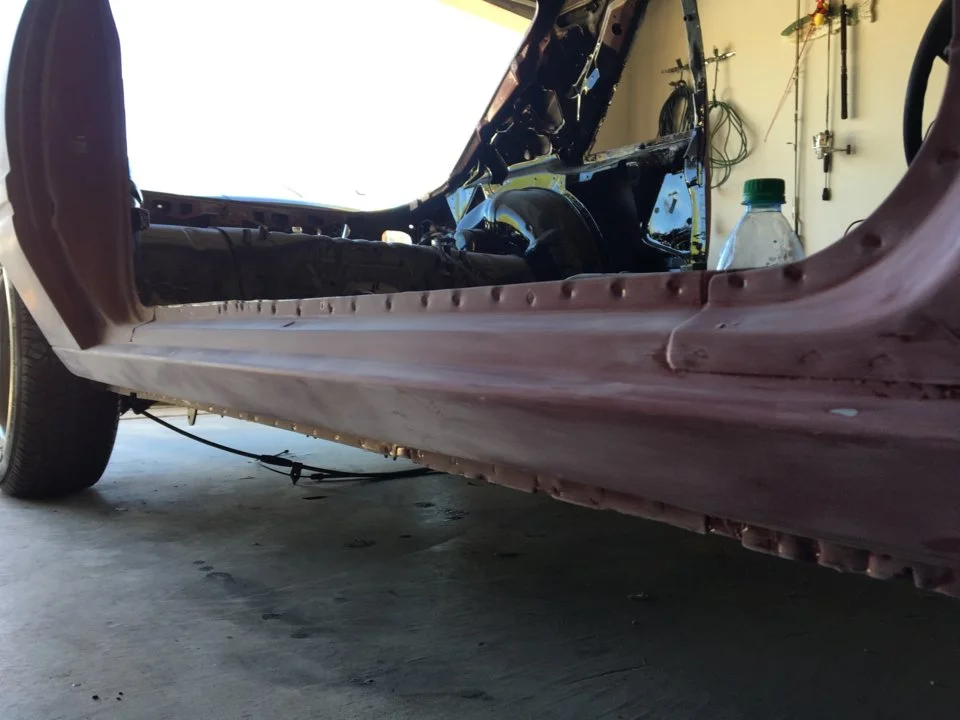

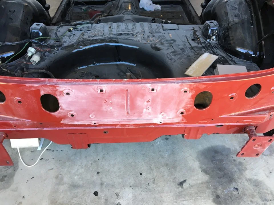

So, been prepping more. The car is completely blocked out now, I'm including a picture of the right rocker panel just because it's so damn straight! My brother is a body genius. I still have some of the edges to finish sanding, I'll probably finish that tomorrow morning.
I soooooo can't wait to paint Doby! This final blocking with 800 grit has made it incredibly flat and smooth. I won't be laying out any sealer outside the engine bay. Less of the heavier viscosity coatings, the less orange peel.
Now I have a car that is prepped the best I can do, and I have some of the best paint out there. It's all on me now. Dang I love painting! I know what this will look like. I'll be painting the engine bay Thursday night, so no sun pictures till Saturday after I shoot the body.
Today's progress:
The last picture just shows the license plate area, since it'll be seen, I blocked it flat as well.

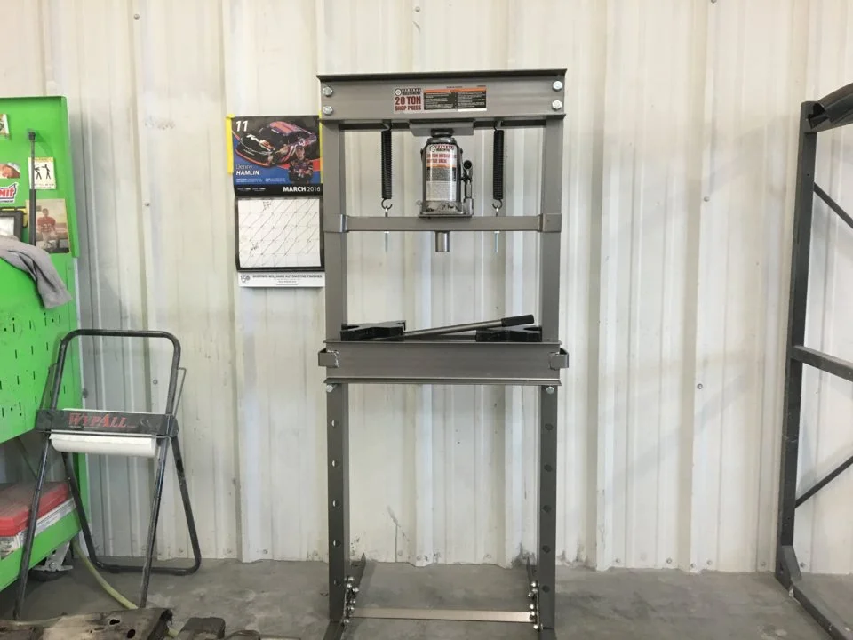

New toy:
Looks like pressing hearings on my pinion gear and differential just got a lot easier. I've got to press on my c-clip eliminator kit on my axles as well.
Reactions: skyline247 and A5literMan

Nice. Been wanting one of those for years. Space is the primary problem

Davedacarpainter said:
New toy:
Hey, if you want a tip from a millwright, unless you've used it already... Don't use that press. You are more likely to damage the cage that way. Get a cookie sheet, throw some foil on it and put your bearing in the oven at 245 degrees for 45 minutes. Then, using clean gloves, drop it on the pinion. Make sure it's seated all the way, and let it cool. Don't heat it much past 250*, you'll ruin it.
Even with a sleeve pressing on the inner ring of the bearing? Good tip on the pinion gear bearing though, I'll try that tonight. I assume that would be fine for everything else as well, differential bearings in particular.
Me too, that's why I took it to work instead of my garage.
Maybe I could use the press to crush my beer cans?
Anytime you can put a bearing on by warming it it's better. This keeps you from cocking it, and tearing up the fit while forcing it on. Usually when it is being started is when it cocks, then the sleeve slips and hits the cage resulting in said damage. You can heat a bearing with an induction heater, (expensive tool) or in an oven. Never put a flame on a bearing. The shock heat stress relieves the rollers and ruins them. The press is a great tool for removal, and sometimes just has to be used for installation, but great care must me used to avoid damage.
