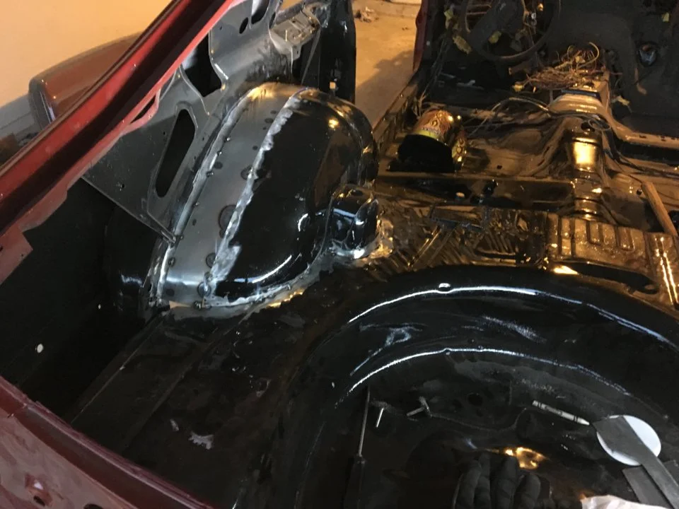

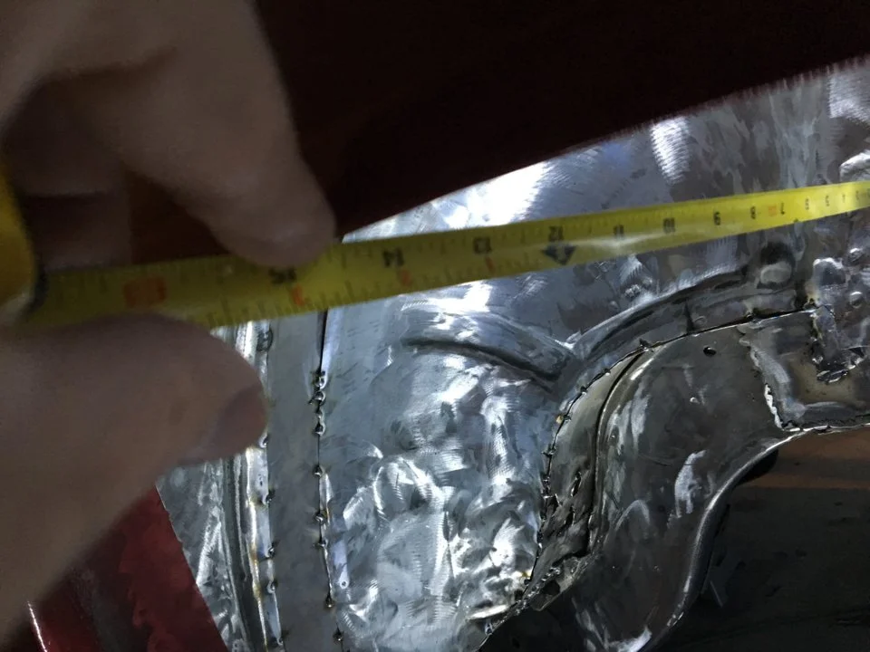

Davedacarpainter said:
Before you go getting too saucy:
Looking good Dave.
Now that one tub is almost done-was it anywhere as bad as you had thought?
Reactions: Davedacarpainter
Davedacarpainter
SN Certified Technician
Nov 28, 2015
11,833
11,633
203
Discordia
Apr 19, 2016
#1,324
  • Apr 19, 2016
  • #1,324

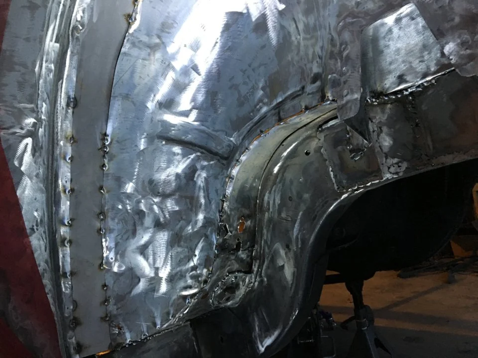

RaggedGT said:
Looking good Dave.
Jeez Chris, it's gonna be so freakin' hot!
So, with a 2" mini tubbing and a 2.5" narrowing of the rear end, I think that (without measurement) leaves me with a 6" backspacing for wheels! That sure opens up a lot of wheels for me to choose.
Before the tubbing, I had to get a 4" backspacing, tough to find a hot wheel cheap with that.
The tubbing was FAR easier than the engine bay smoothing, glad I'm doing both though.

Meh,...That's why I'm saying that Dave has magical powers. He just makes everything he does look easy. (And all while cooking pancakes, and drinking craft beers.)
I'd say that between the two, they both are a huge pain in the ass. The mini tub goes much better in a hatch than it does in a notch because everything has to be done pretty much with your head in the quarter. otherwise. Unless you have a plasma cutter, cutting away all of the old inner structure that is attached to the inner frame rail is nasty, dirty, hot work.
We did have a plasma cutter, didn't we Dave?
Welding the filler/spacer strip into the really thin, galvanized inner tub requires skill with a MIG, and there's a future 3 alarm fire waiting on you unless you completely strip the inner side wheel tub of the old rubberized undercoating first.
Dave did that as well.
Conversely,..Engine bay smoothing is tedious for most of us. Using the stock front aprons, and filling the holes, then smoothing those things out as opposed to just cutting them away and replacing then with "Scott" panels is a bad idea.
I'd say the part of the bay smoothing that causes the most dread occurs immediately right after you put the MIG down, and realize that now all of those welds have to be ground smooth. And then there's the never ending nit picky sanding regimen.....
Personally, If I was handed my choice of having to do both jobs as the lesser of two evils, It'd be a tough decision.
Reactions: RaggedGT and Davedacarpainter
After watching you guys do the tubbing in coupes and monsters, I have to say it really was much easier for me.
I have sat inside the vehicle for a good portion of the time for cutting, cleaning and welding. That would be almost impossible in a coupe (I'm over the 2'3" height requirement for that).
Still, I'm really not even half done yet. Though what I learned on the left side will make the right side a quicker mod.
I kind of dig the whole getting dirty and cutting, grinding and welding thing. I'm almost getting nostalgic for this build and I haven't even finished the mods!

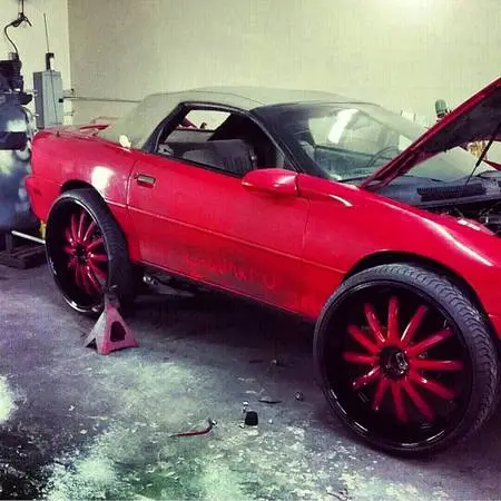

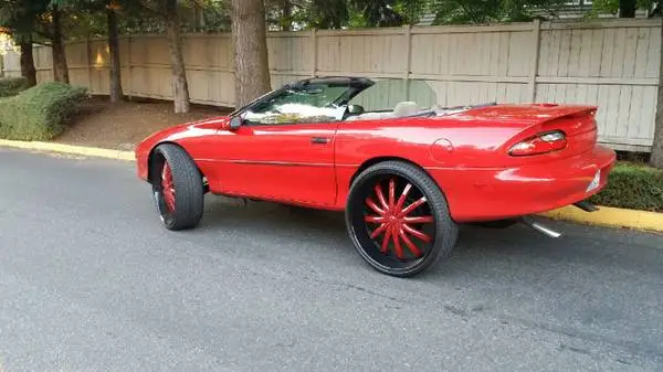

jrichker said:
19" wheels - do you like the Conestoga Wagon Wheel look?
or maybe this more contemporary look...
Baahaahaahaa!
Well, of course they look like hell on a camaro........

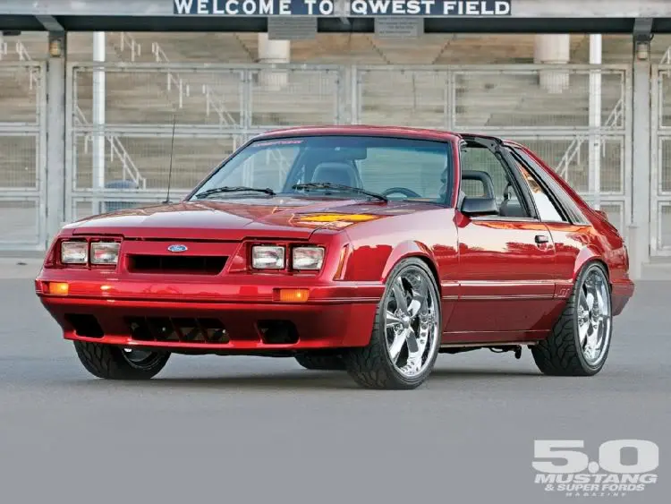

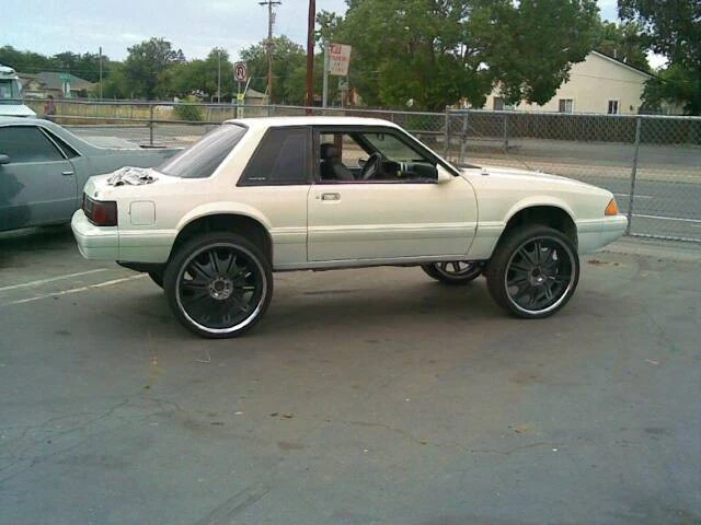

Dont look like this guy
17" max with the early wheel wells for sure
Yeah, well.....I guess my whole "mini-tubbing thing is a waste of time now that I've seen that!
Reactions: 89oem
