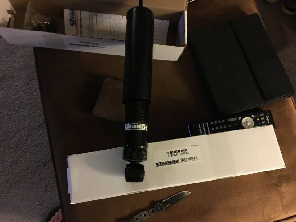

Got my rear shocks in today, thanks to @Boosted92LX and @Noobz347 for your help with the photo.That's the last thing I needed for the rear end, I guess you could say I have my rear end in hand now
WOW! remote controlled shocks. What will they think of next...........
ONLY the best for me

That. Is cool.

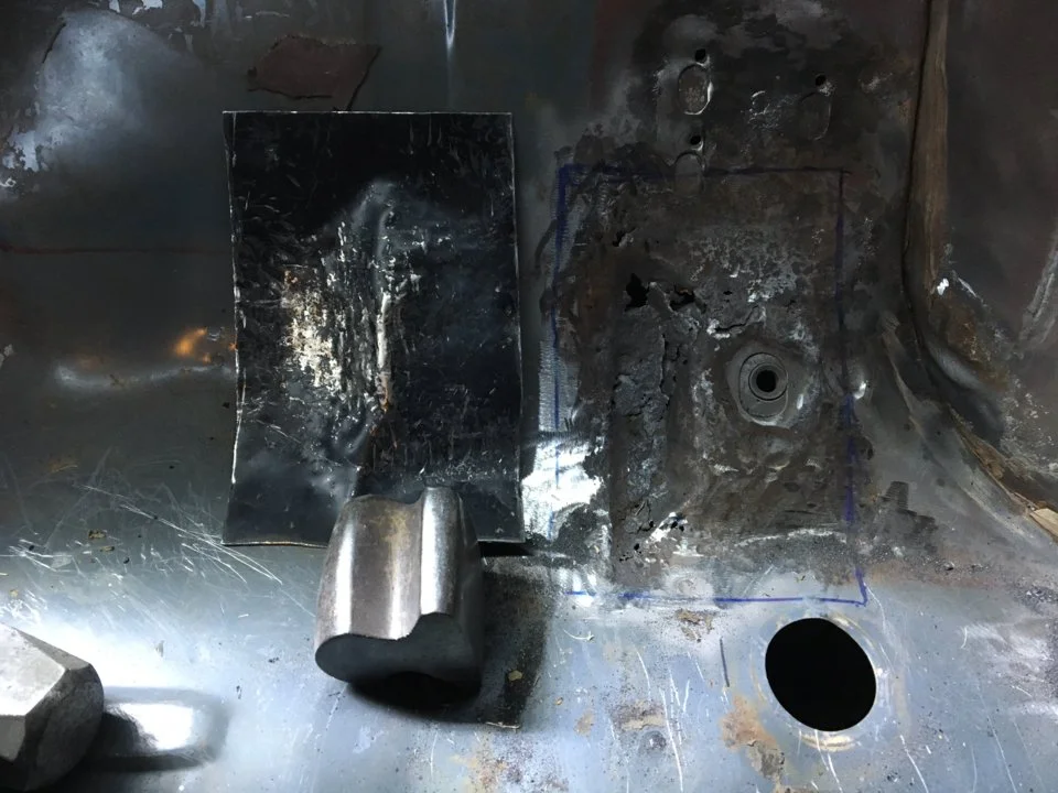

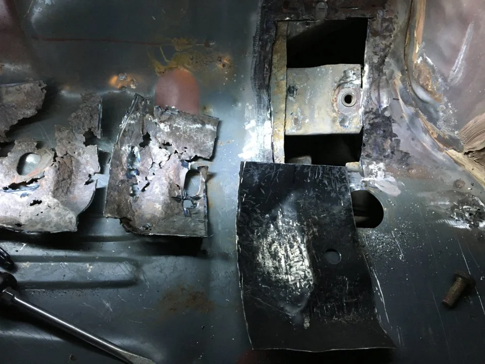

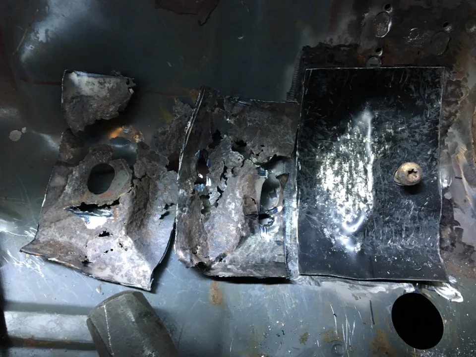

So, for tonight....
I cut out the rot by the driver's side rear seat belt buckle. I thought it was much smaller till I started grinding around it to find good metal to weld to. It ended up being almost the exact same size as the passenger side.
I beat a new patch panel into submission, got the hole drilled out for the seat belt bolt and got in and showered before my wife got home to complain that I'm working on the car again!
Anyway, here's some pictures:
Tomorrow night I will drill four holes to weld to the seat belt bracket and zap that baby in place. we are supposed to be in the sixties this coming weekend so I will spray some acid etch paint on all the bare welds, and seam seal while I have a chance for things to dry up. BTW, the rot on the left is from the passenger side, the right is the driver's side rot. I took one picture on a white countertop so you could see the Swiss cheese holes better.
