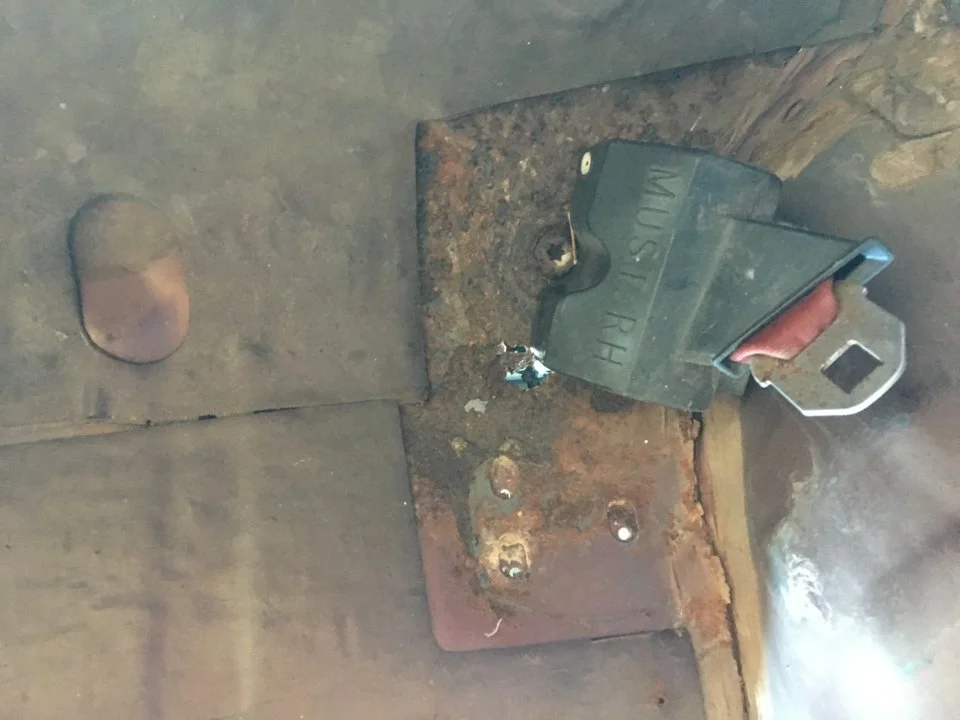

Started scrubbing the interior floor, I've got rot around both rear seatbelt to floor bolt areas. Does anyone know of a replacement panel that can be ordered? Do I need to fabricate this piece instead? It's not an overly large area, but it is around where the seat belt bolts down.

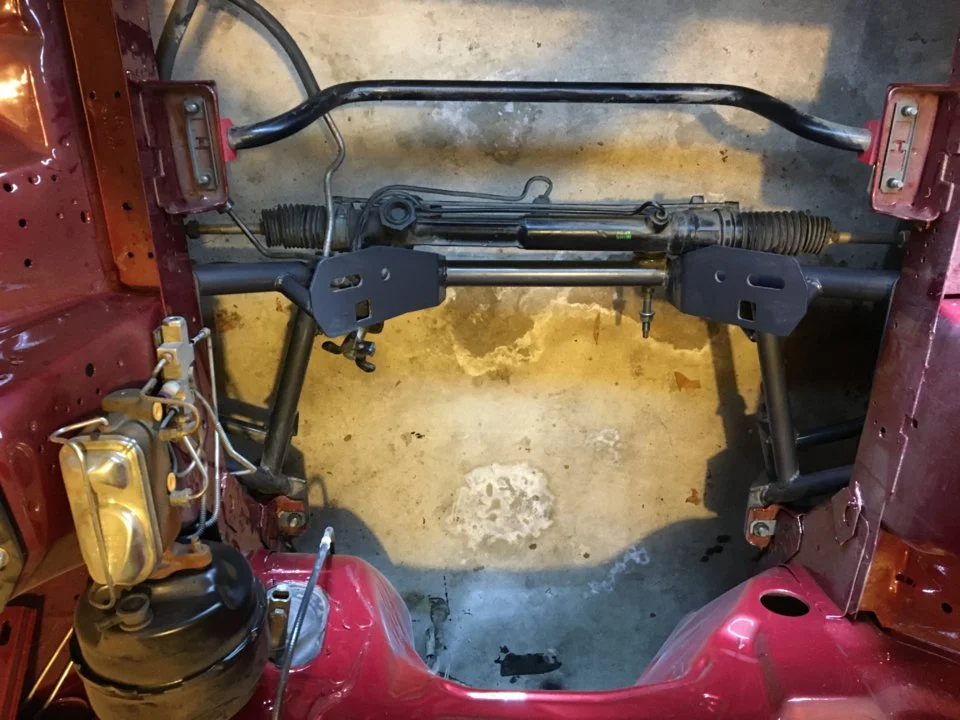

Installed the UPR k-member this morning. Didn't think about needing shorter steering rack to k-member bolts, ordered them from LMR. It would have been nice to go with a MM k-member and suspension, but I got this set with k-member, control arms and coil overs for next to nothing, just right for my budget! I might get steeda's bumpsteer Kit, what do you all think of that product?

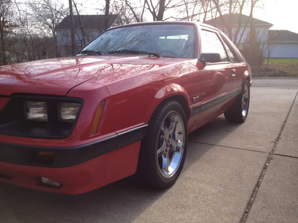

I had an '86 T-top for about a year, and sold it to get my '11. While I had it, my wife would not stop talking about how she didnt understand what I liked about it. She said she thought Mustang II's even looked better... Some people just dont have an appreciation for them, but I am with ya. I used to favor the aero nose in my younger days, but side by side now, I do think the four eye looks more aggressive.
While the previous owner(s) had made it pretty "unique," I had already gathered parts to restore it back to mostly stock with only aftermarket wheels. That was until I drove a coyote car. It was easier to afford a new car payment than to shell out the money for a coyote swap in the '86. It was a nice car though, wish I could buy it back now, but dont have the garage space nor an understanding enough spouse.

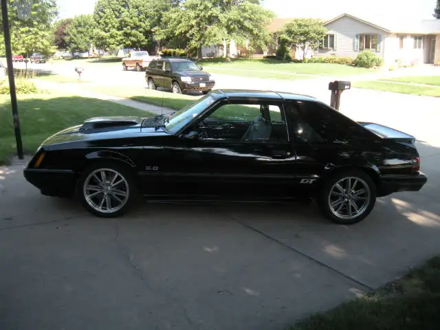

I understand the lure of the newer mustangs. They are beautiful cars. I was intending to buy a 2016 GT this coming fall myself.
What a nice car you had, I understand the regret of selling it. The newer mustangs have so much to offer in upgrades though, kind of hard to beat starting off with over 400 hp when you are just beginning to upgrade.

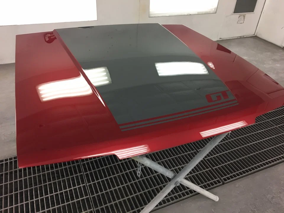

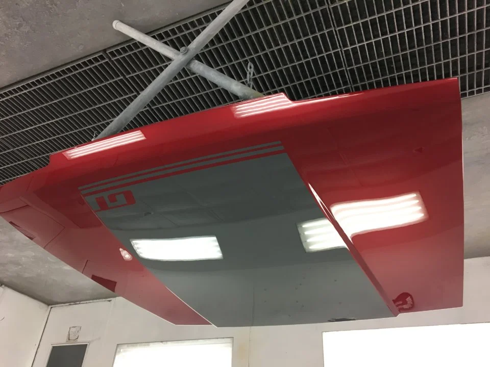

Got the hood painted today, It will go into it's nice warm storage upstairs until about May or June now. Next week I'll get the fenders shot. Speis Hecker clear coat is extra sweet. Week after, the doors get shot and then finally I'll paint the body! Then I can start putting all of those new parts on the car. BTW, the weird spots on the hood are spots of clear I got on my phone's camera lense, they aren't on the hood.
