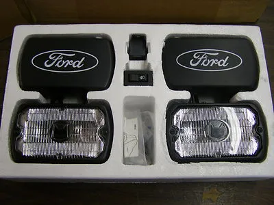

Learn me, marchal (sp) foglights?
He's talking about these Marchal (sp) fog lights...

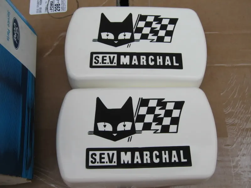

And if you need to be real retro,...you get these covers..
See the S.E.V.?
It's a Fox Mustang staple acronym .....
It means Same as Every Vehicle.

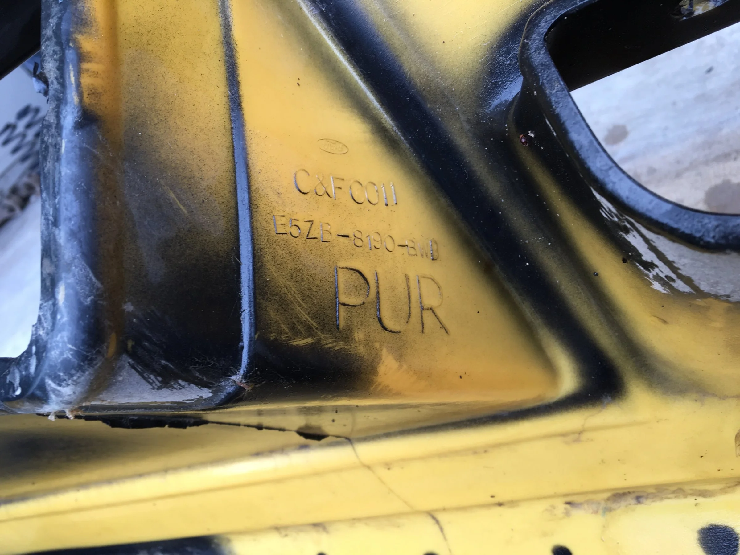

I was washing their dirt off the new bumper and it hasn't been painted. It's just ecoat on it. Can anyone tell me if this looks like the correct ford markings. I may have gotten a real ford part that was hardly used.

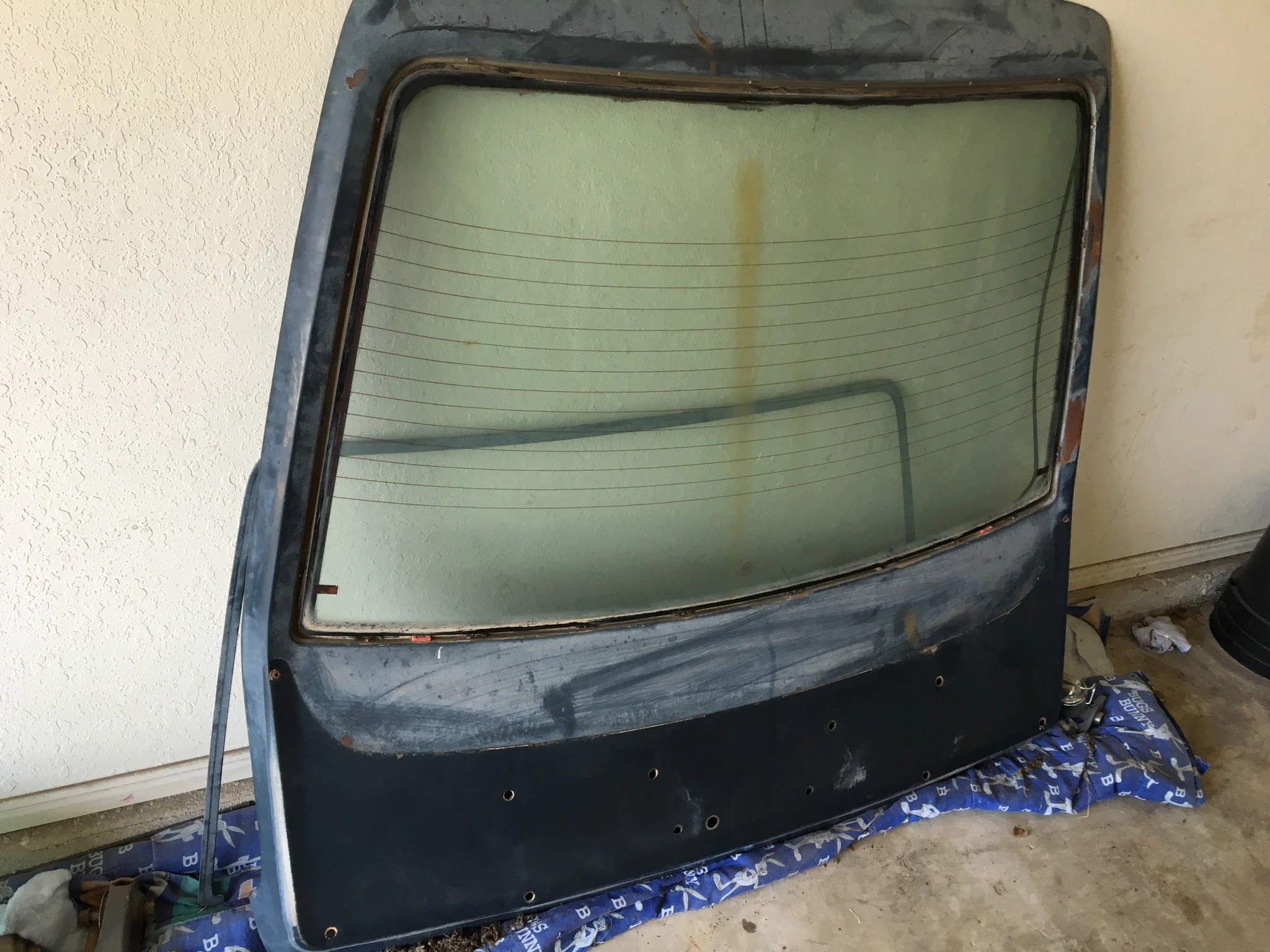

Ok, got the hatch torn down now.

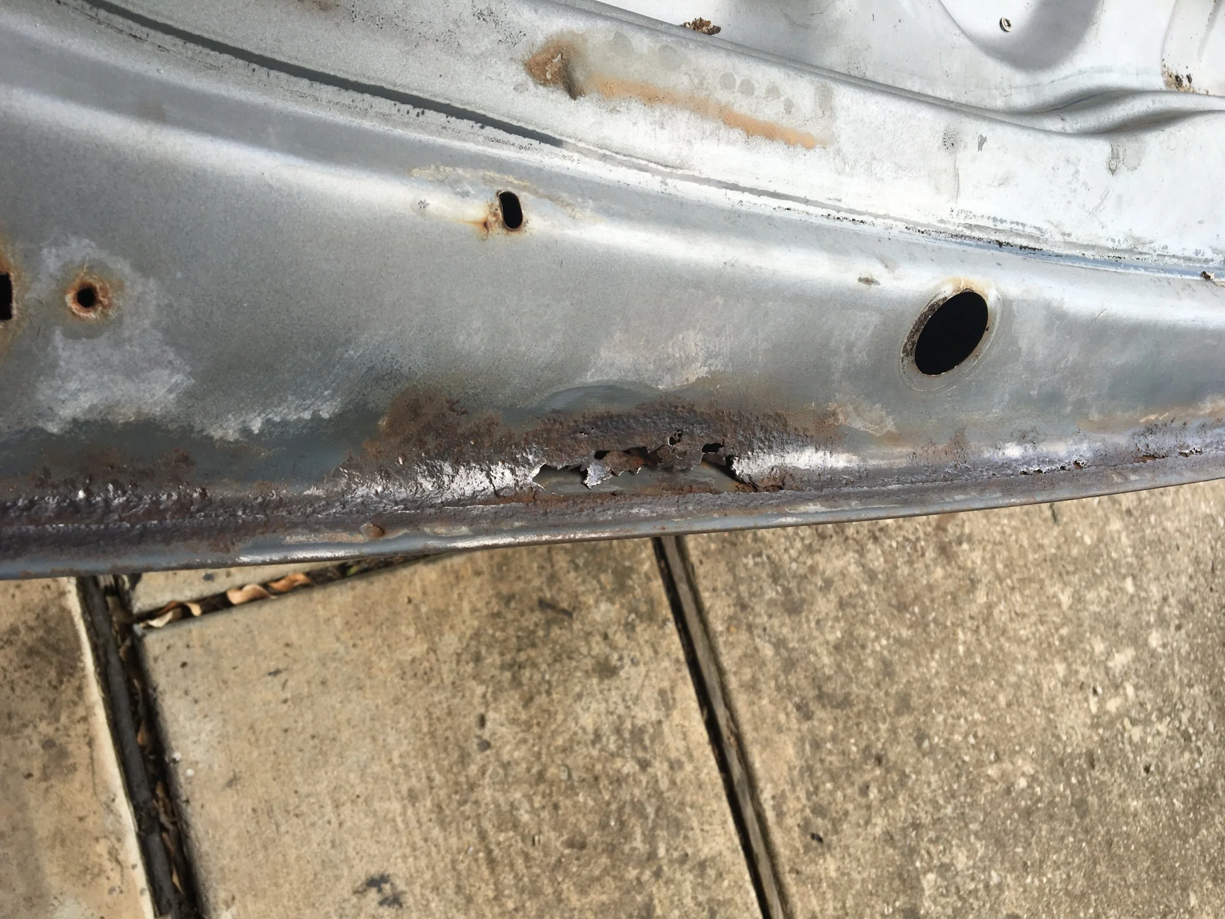

I would repair the rot spot now if I had extra thin metal for that, got to look around. I wonder if the old inner fender panels would be too thick?
The top side looks amazingly straight.
I have to take it to work on Tuesday to get the glass guy to pull the glass out. BTW, the glass is heavier than sht!
Could you cut the rot out and fiberglass it?
I could if I wanted to wear my stupid sign more frequently.
I've reread this Chris and I realized I sound like a dick, sorry.
If I had an aftermarket hatch made out of fiberglass, only then would I use a fiberglass repair.
Those type of patches on metal are very shoddy. You need to maintain fairly equal structural integrity in a repair. Fiberglass eventually pulls away from metal through the regular movement of the vehicle.
I wouldn't do this to my car or anyone else's that I would work on.
That's a ford engineering part number on there. Looks legit to me

Do you know much about the new ones being sold from original ford tooling? Wouldn't those molds be required to have the ford logo and part number wiped before they could make bumpers?

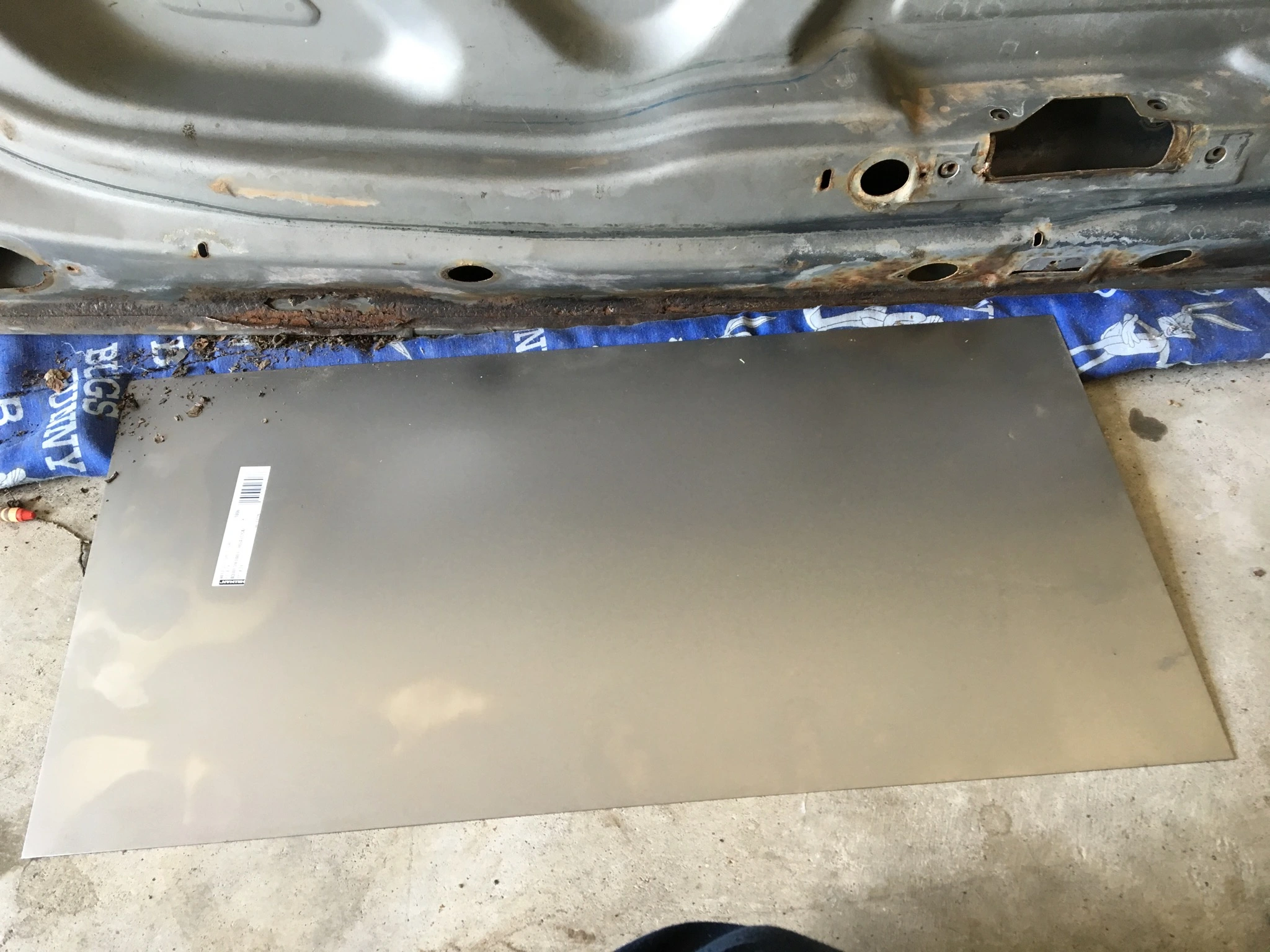

So I had to go buy an official fox body mustang hatch repair kit from lowe's.
I'm simply going to cut out the three spot welds, roll back the edge from the outer panel, cut out the bad stuff, clean up and fit in a piece from this sheet I bought. Then tack it in similar to the engine bay panels, grind, mud and primer and it'll be fixed.
It's 22ga steel, that's what the hatch seems to be made out of.
