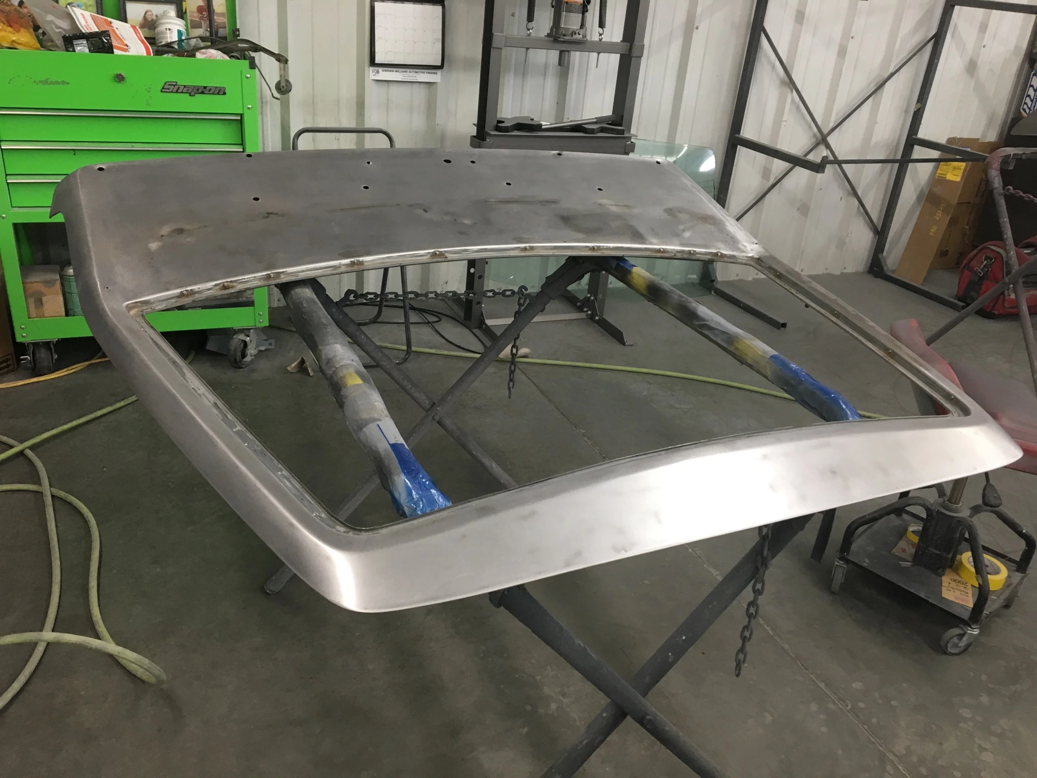

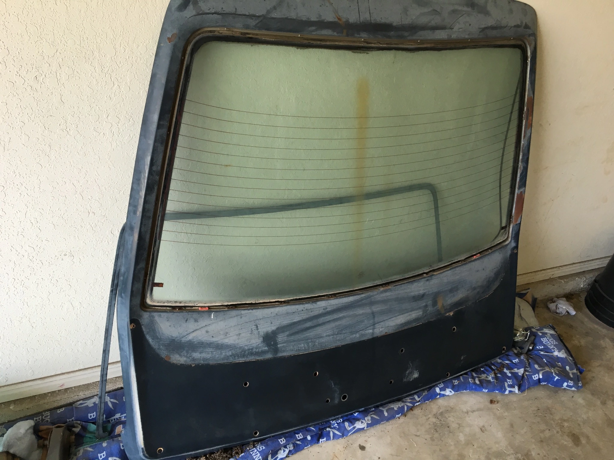

So, here's the hatch before:

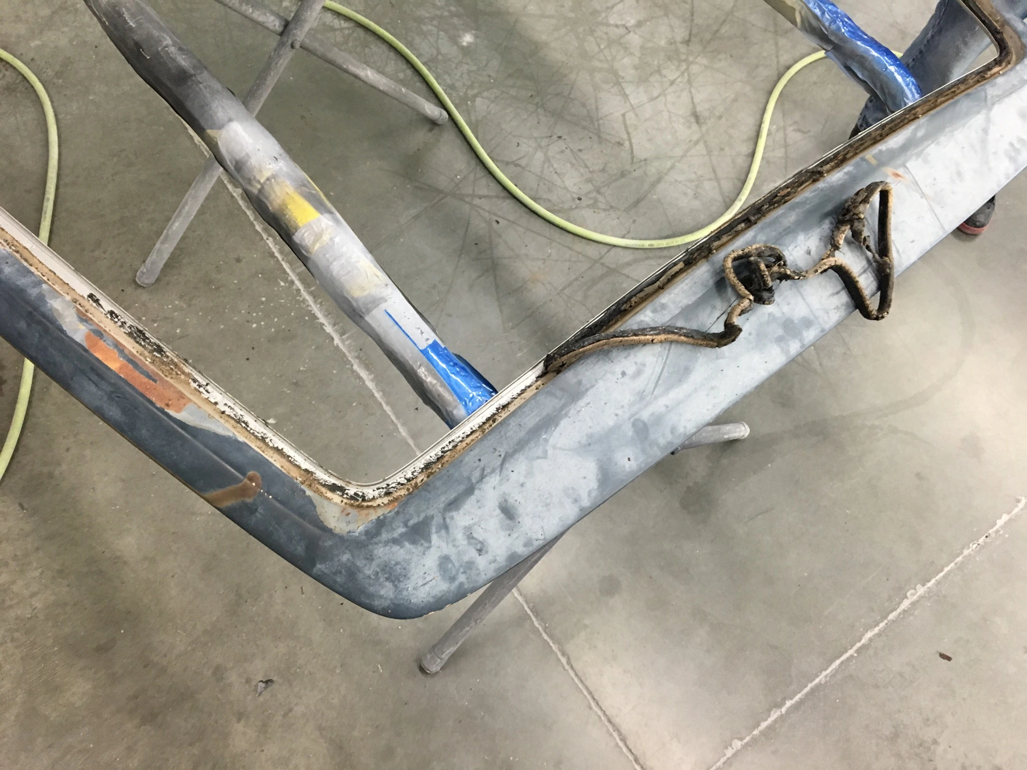

And after stripping it:
Bondo work tomorrow.
As an interesting note, I found rust all over this hatch under the blue paint. It wasn't bubbled up though, it would soon.

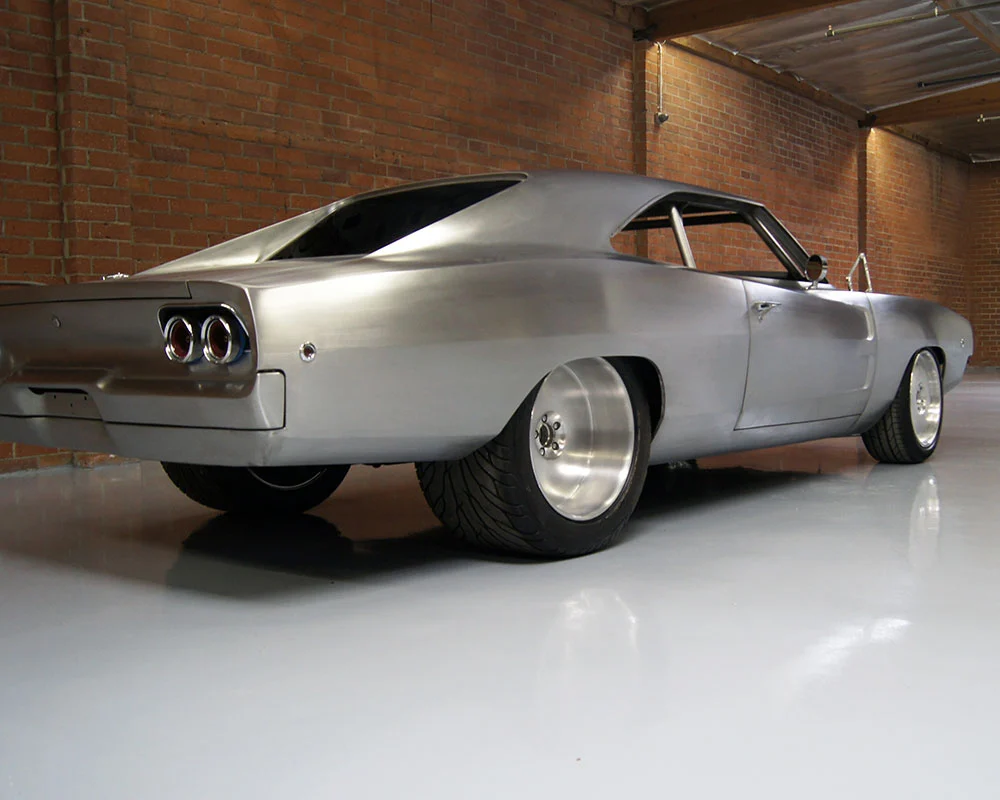

You gotta give it up to Chrysler.
Back in the 70's, the Mopar contingent was few and far between. Ford and Chevy were the only brands that generally was considered "popular".
Yet there was always "that guy". The one in the 70 road runner,...67 GTX, A 71 'Cuda, or in the case above, a 68-70 Charger.
We made fun of the build quality, laughed at the stupid sounding starter, and joked about how More Optional Parts Are Required.
All the while they built these super hot, complex bodied behemoths, knowing that one day some deep pocket collector (that probably was one of the guys making fun of them) would dole out over a million dollars for one of them with a Hemi and a soft top.

I brought my stripped hatch back home to do the body work this weekend. I remembered the bondo, sandpaper, even my da so I could start stripping the spoiler. Smart boy, right?
I forgot my blocks. smh.

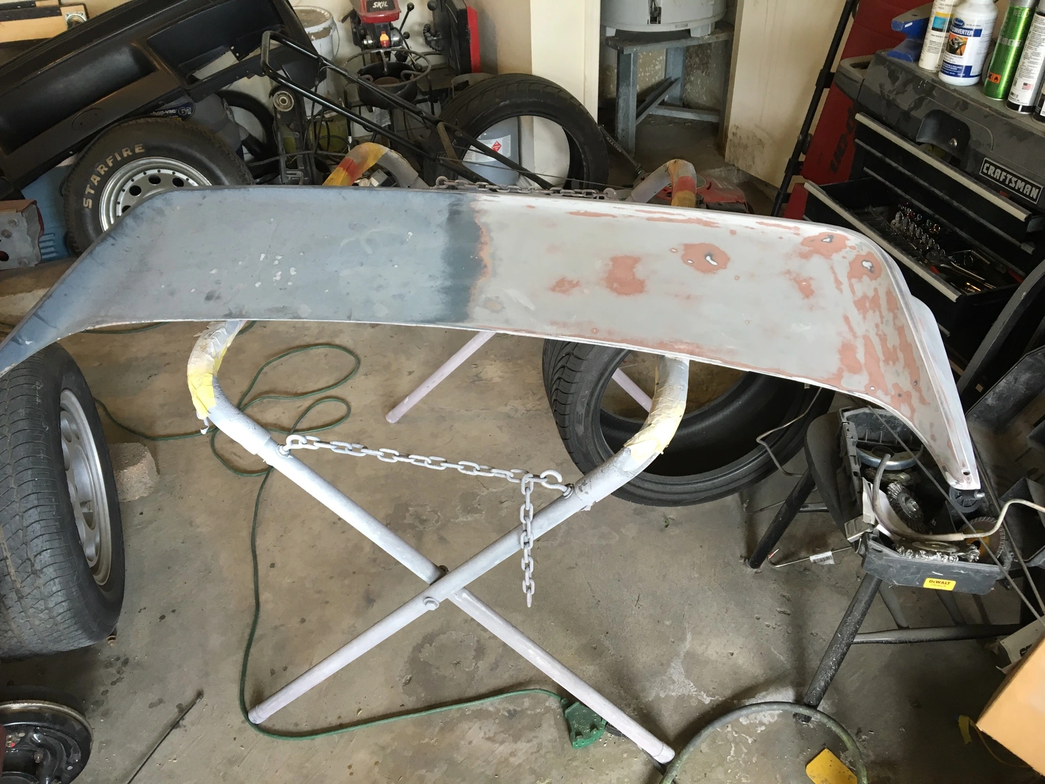

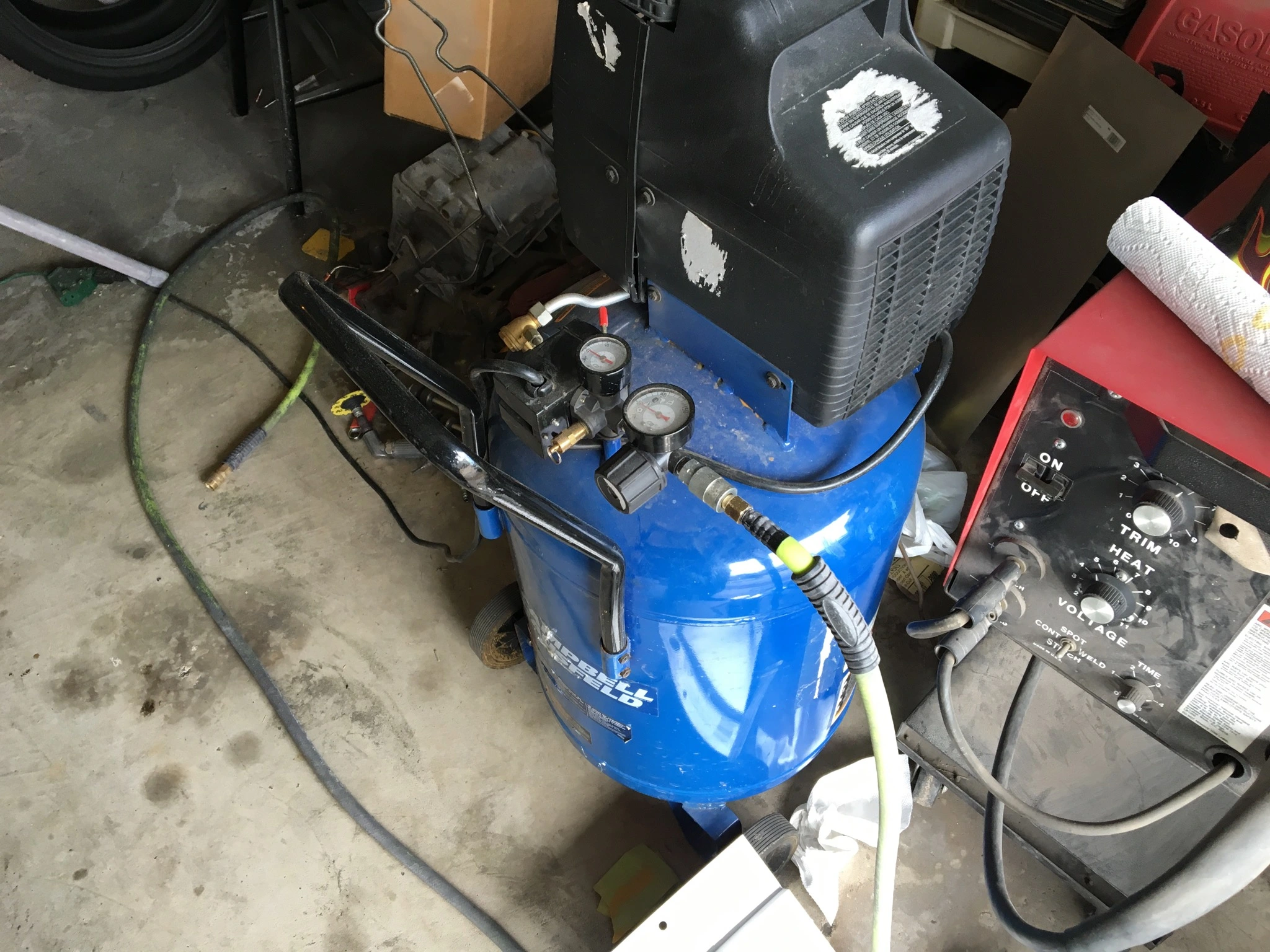

Anyhow, my little compressor will run my da, but very slowly....Which is good while I strip the spoiler though. It takes a lot longer, but I don't round off anything that shouldn't be.
Kind of stagnant other than that. I'll paint my bumpers and spoiler this coming week, then they go upstairs with the doors, fenders and hood.
I'm going to try to get the hatch in primer by Tuesday, then I'll let it sit for a couple weeks and let the primer shrink back.
