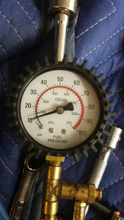

Ok did the check for code 19 and everything checked out. Power at both pins and the injectors. Plugged it back in and no code now, still runs like garbage. So this is what I am trying to convince my self is the problem. Testing the fuel pressure I get 34 - 36 psi running with vac line disconected. Now today I was re checking with some help and noticed when pressure gage is at 0 and the key is turned on it jumps maybe 5psi and jumps about 5-6 psi every time the key is turned on. Also it drops 1-2 psi each time as well. With the gage at 0 and turn key to run its jumps to 5 psi then turn to start it rises very slowly, it takes 5-10 seconds to reach 35psi. The car starts at about 20. Does this sound normal? I mean really it has 36 psi when it's running so does anything else matter?

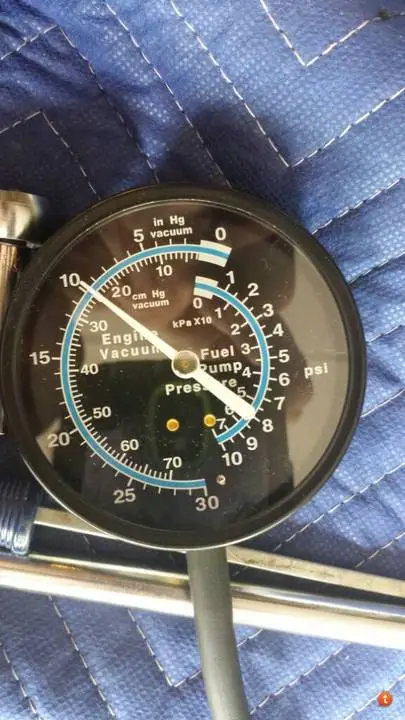

Look normal? Seems to me vac should be a little higher at idle.

this is with it running. It takes about 4-5 key cycles to prime to 34ish. Also takes about 5 seconds to build up when it starts. I pinched off the return line and was able to get it to 50psi. Thing is it will build the pressure up but I don't think it has the flow.
