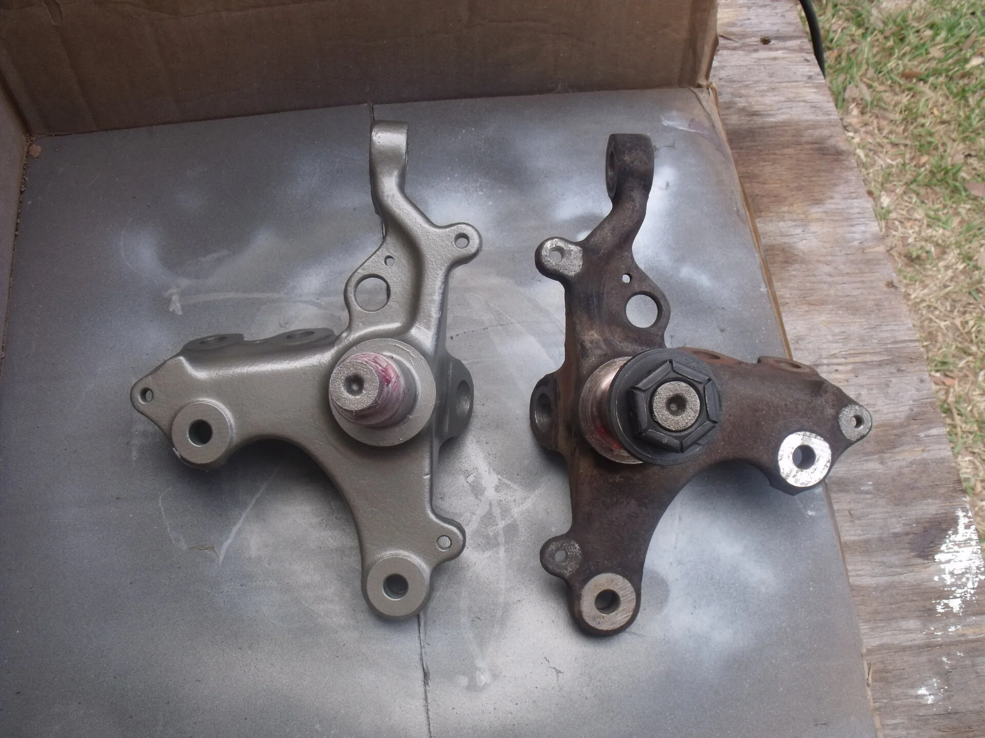

I wasn't sure which way I was going with the 5 lug conversion, but after I found and purchased SN95 spindles, that made it much simpler..
Here is a pic of the spindles, before and after cleaning, wire wheeling and paint....
These were in the local WY.. I paid $70 for the pair... I used Cast Iron gray color.....

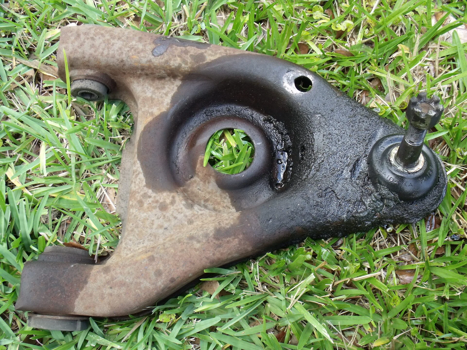

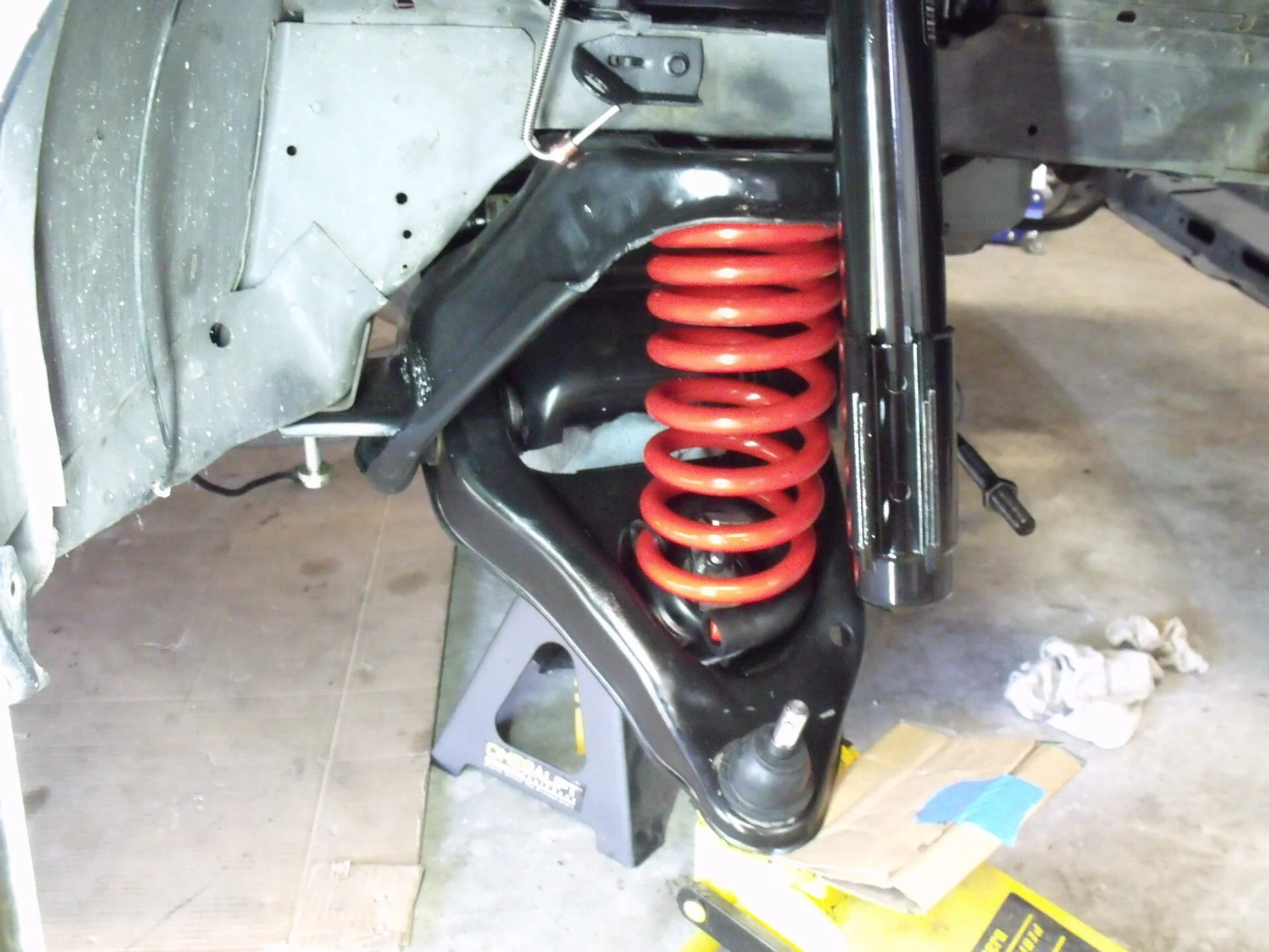

I reused the front lower control arms ( Original to the car) using new pressed in rubber bushings and a new SN95 ball joint.. My understanding is the Sn95 ball joints are shorter and you do not have to use any washers? to take up the space... Mine fit fine....
I used rubber control arm bushings as I have used Poly's in the past reusing the outer shell of the old bushings.... I had clunks and groans that I contributed to using Poly bushings in some previous cars in the control arms, and decided to go this direction.... I will use poly bushings on sway bars and struts though......
Not sure how the "new" control arms that come with the bushings and ball joint already installed are quality wise, but they would save ALOT of work and hassle using those.... A negative would be having to use washers/spacers on with the ball joint that comes on them..... I think it would be pretty much a push in cost too..

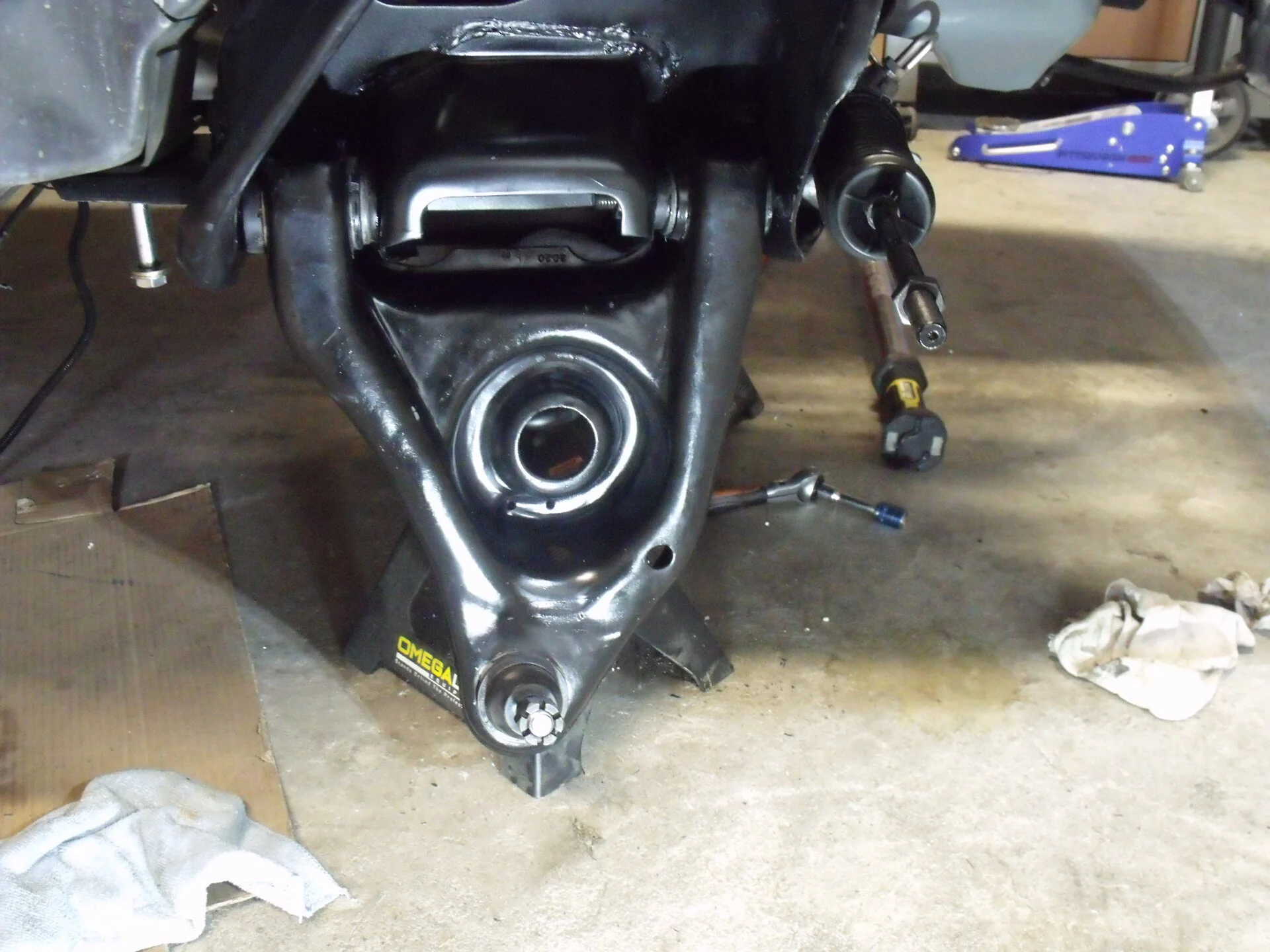

Before and after installed on car.. Do not tighten the two bolts that hold the control arm until it is setting at ride height... I took up all of the slack in the bolt threads as they are easier to get to now, but I would not even call them "snug" yet.....
DO NOT install your steering rack before you install your lower control arms..... The forward bolts that hold the control arms will not go in without the rack being off... I really enjoyed reinstalling my steering rack more than once .... LOL
Just black satin rustoleum paint on the control arms over a very light coat of etching primer and regular primer....

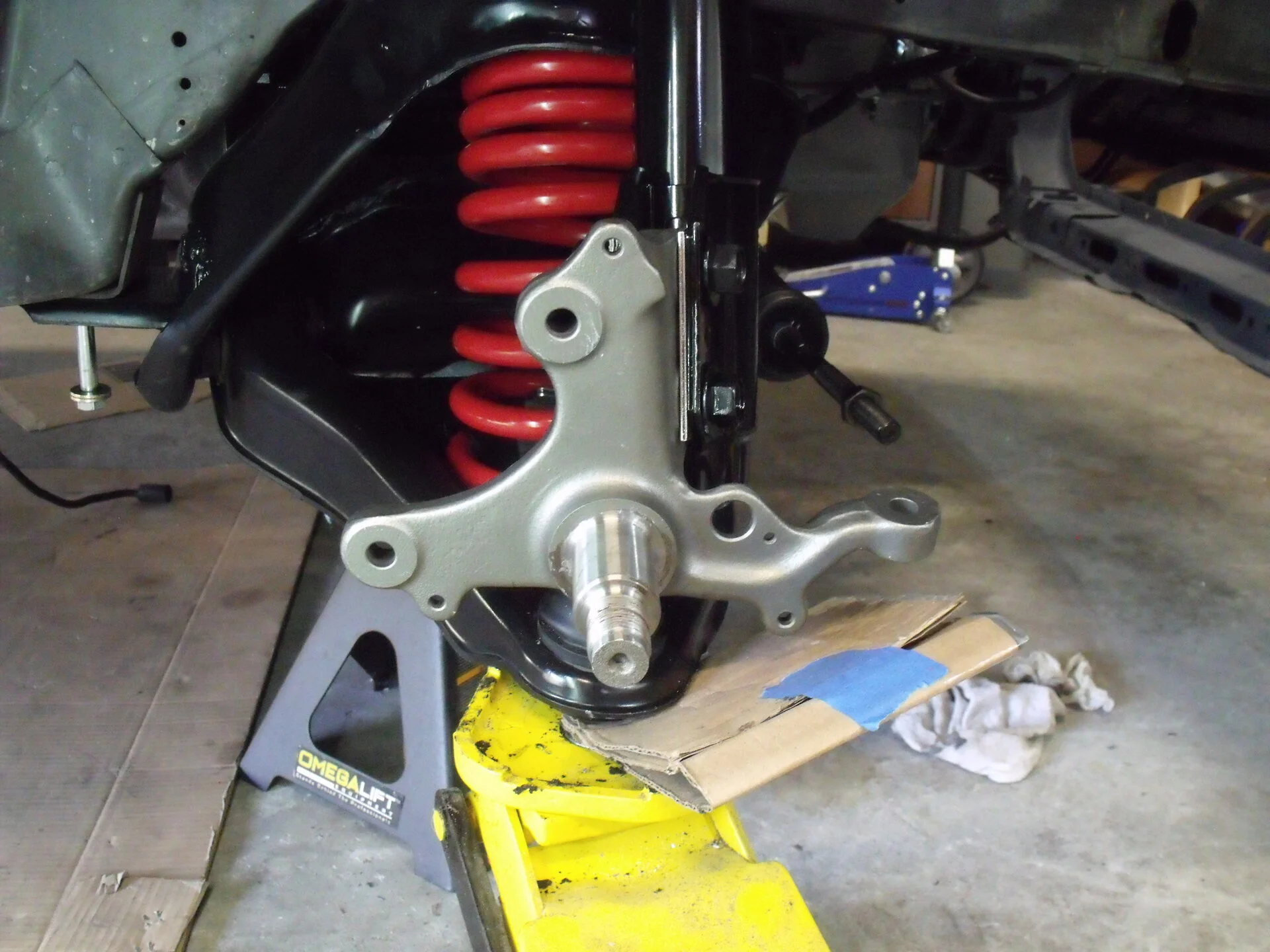

Install of the new springs, spindles and strut/shocks..

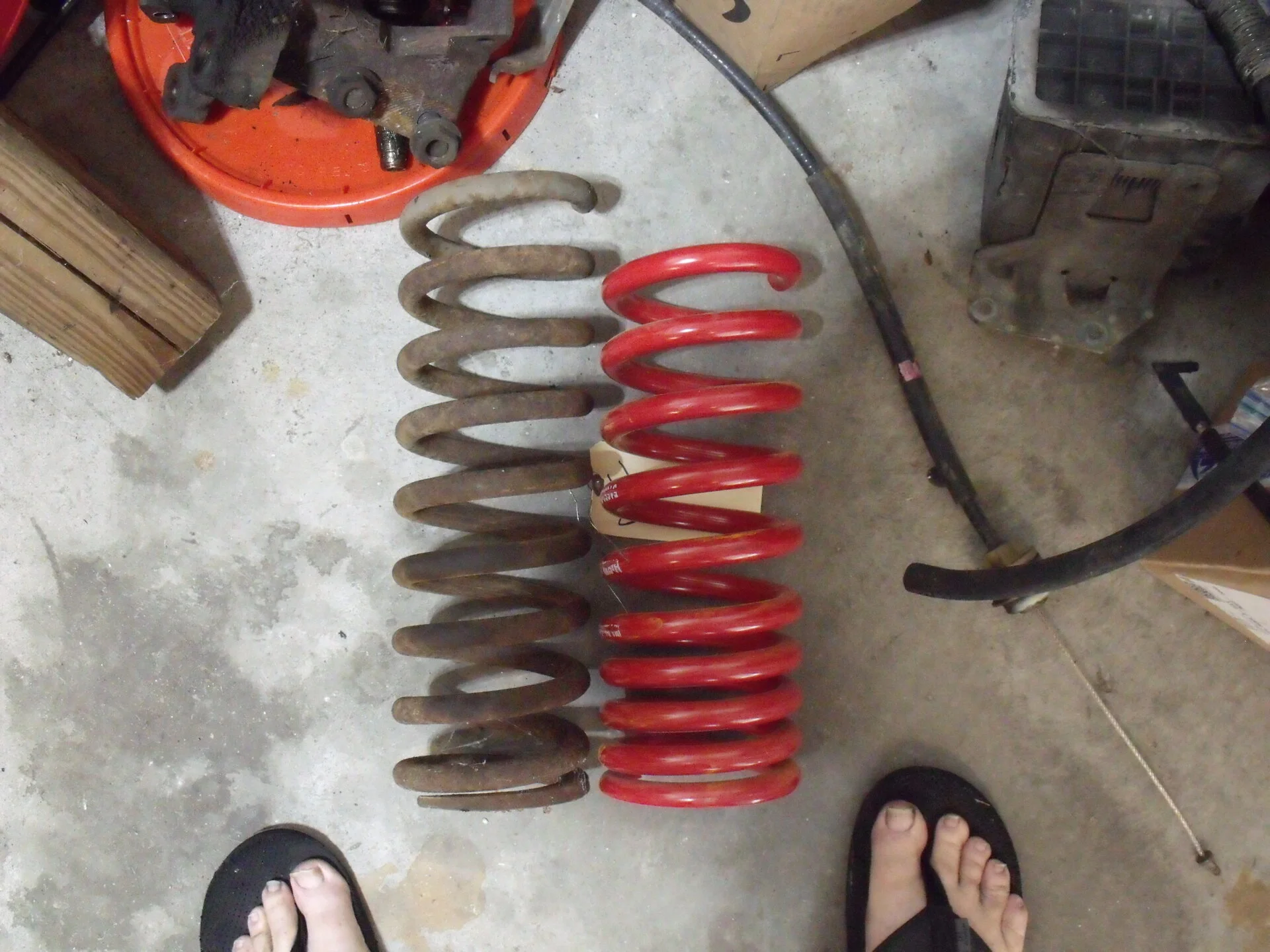

I looked at different options for springs and struts and decided I really didn't need all of that......
I did want to lower the car and I did NOT want to try and reinstall the front stock springs......
I went with H&R " race "springs which are supposed to lower the car 1 to 1.5 inches... Enough to make it look better and hopefully not TOO MUCH to create other issues... I wanted to use H&R " sport " springs but they are NOT available for the convertibles...... I believe it is a weight issue. with a vert...
Stock Monroe struts will be fine for out handling mom in a mini van fighting over a parking spot at Winn Dixie.......
I did not want red springs, but as I was getting ready to paint them black, I did not have the heart to paint over the pretty powder coat... LOL Only a fool would install these without the MM spring install tool.. You can see it inside the spring bolted to the control arm...
If your springs are not compressing enough to install the strut bolts, try moving your jack out to the very end of the control arm for better leverage.. Make sure you do this safely and you have enough " meat" so it does not slip off the control arm.... I also found if I hung my chubby body off the fender with one arm it helped if the holes don't quite line up......
Pic of the stock vs new springs...

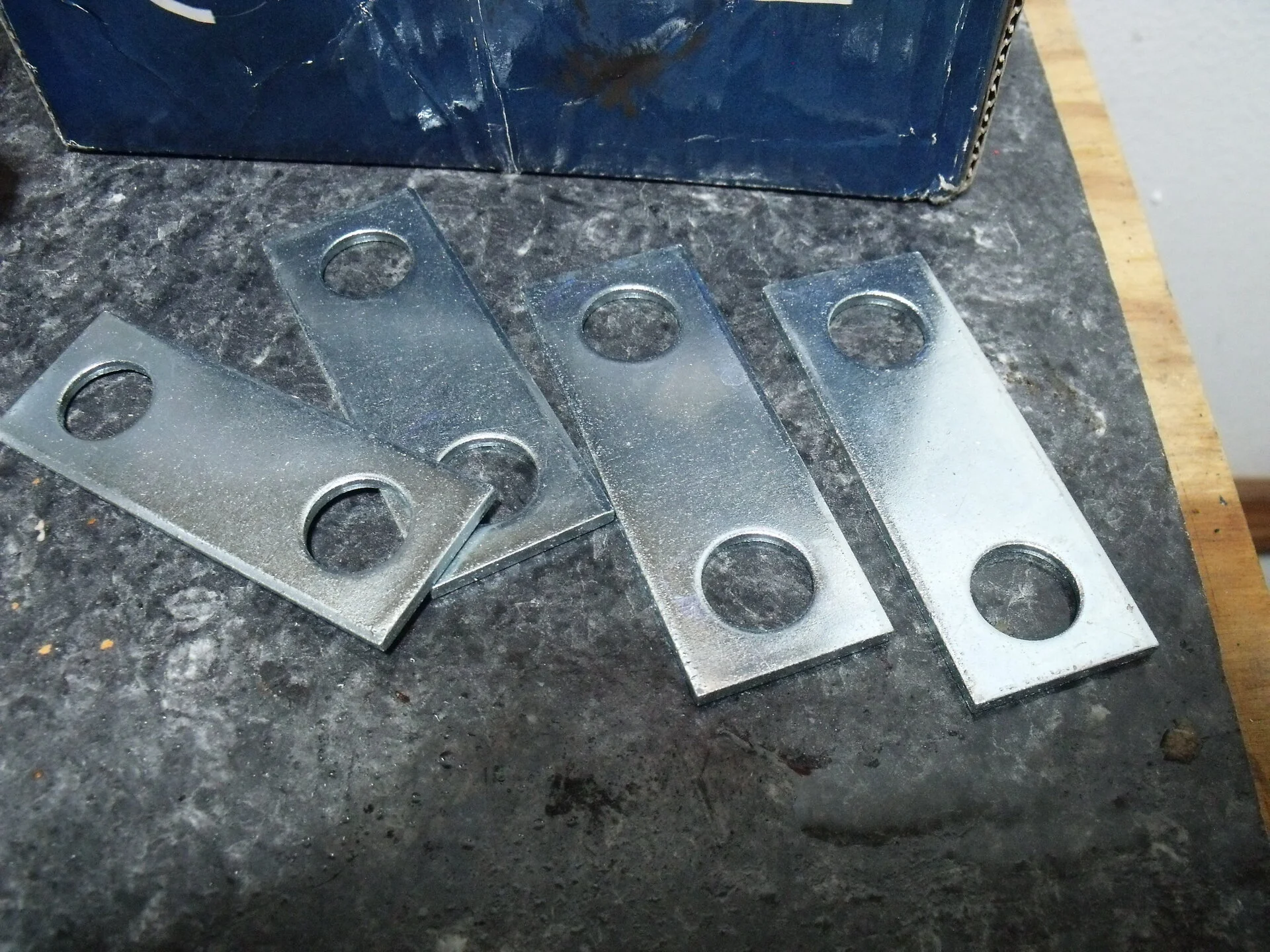

Ordered 87 newer struts, which I thought would fit my spindles without using spacers, but it still needed them... They came with the new struts... Worked fine...
The two bolts that utilize these spacers, hold the struts to the spindles.... I wire wheeled all of the bolts and nuts, cleaning the threads too and painted them... Looked like Blue Loctite I cleaned out of the threads, so I used blue loctite on the install.... 140 Ft lbs to tighten....

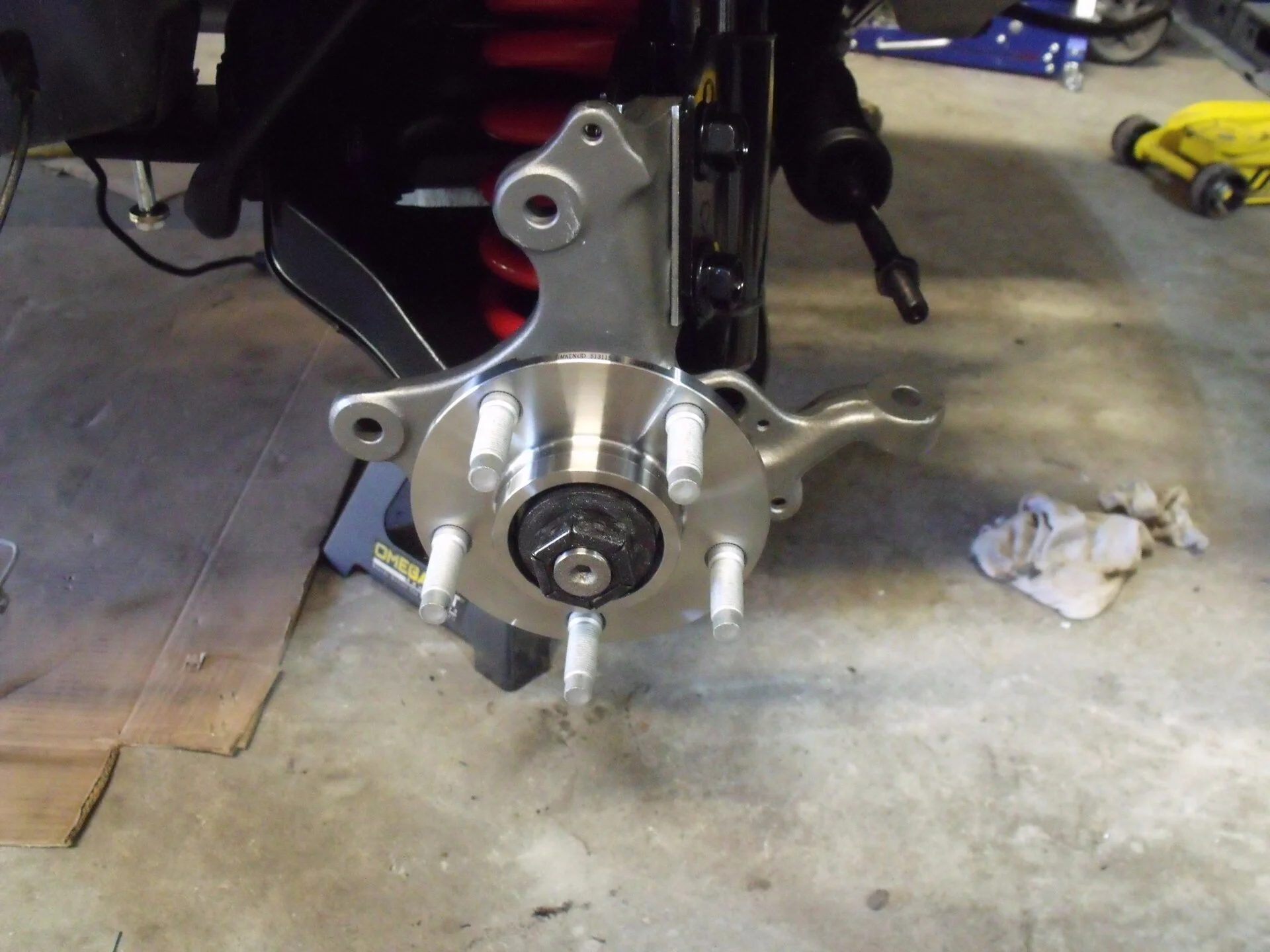

Finally, 5 lug spindles.... RE using the front spindle nut is only temp until I get new " one time use" nuts from Ford... This thing has been nickel diming me to death, or I should say hundred dollaring me..... LOL.....
Read where the Ford OEM nuts were alot nicer than aftermarket.... Tasca seems to have a great price on them......

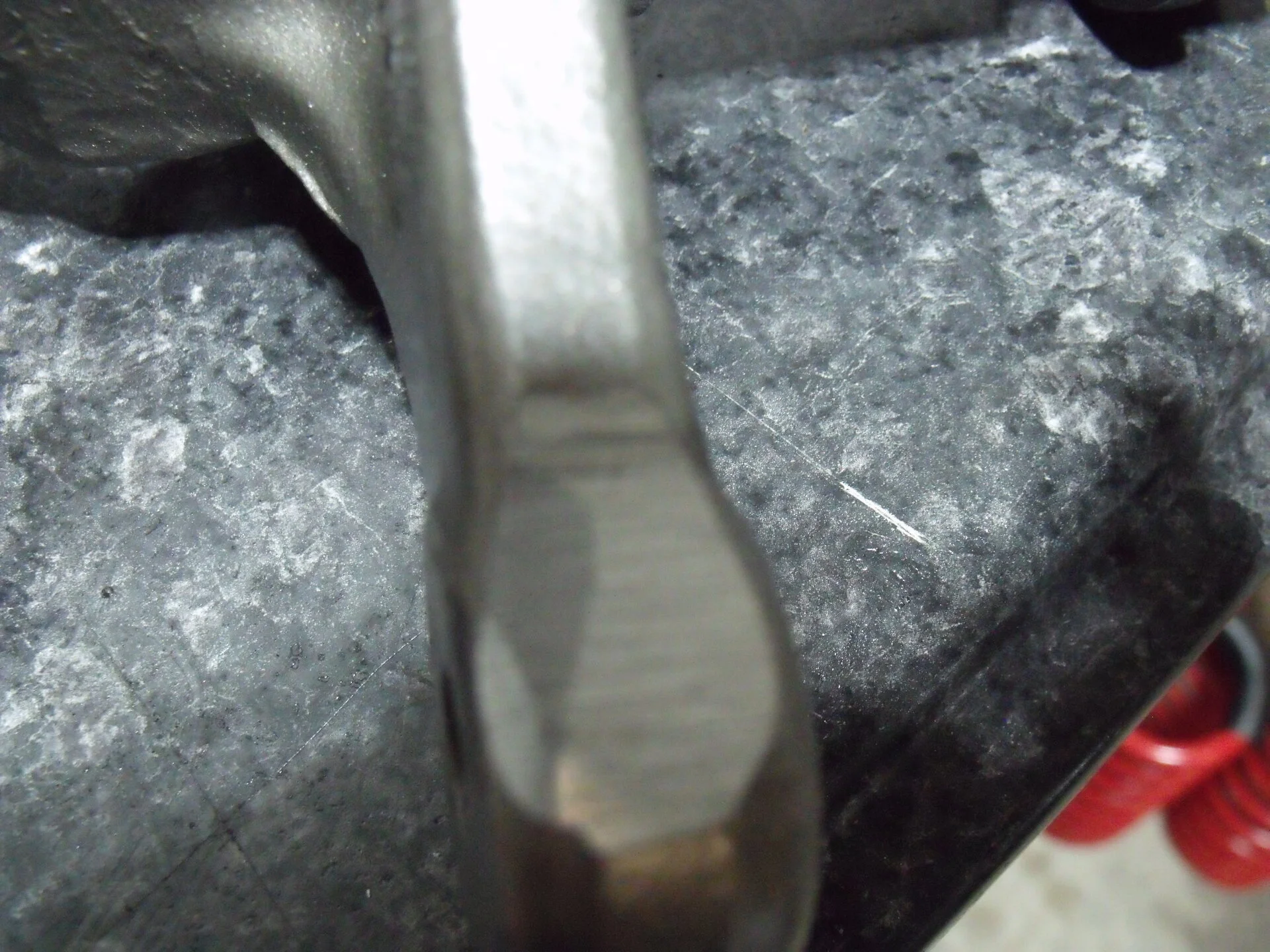

Not sure about other brake calipers, but when using these you need to grind off a couple of spots on your spindle for clearance.... This pic looks much worse than it was.. All I needed to grind off was a dime to a penny thickness.... The caliper cylinders just barely interfere with the spindle in these two spots....
A thanks to Mustang 5L5 again for this heads up... It was alot easier doing this BEFORE I spent a few hours cussing this out why it didn't fit or stripping the threads on the calipers......

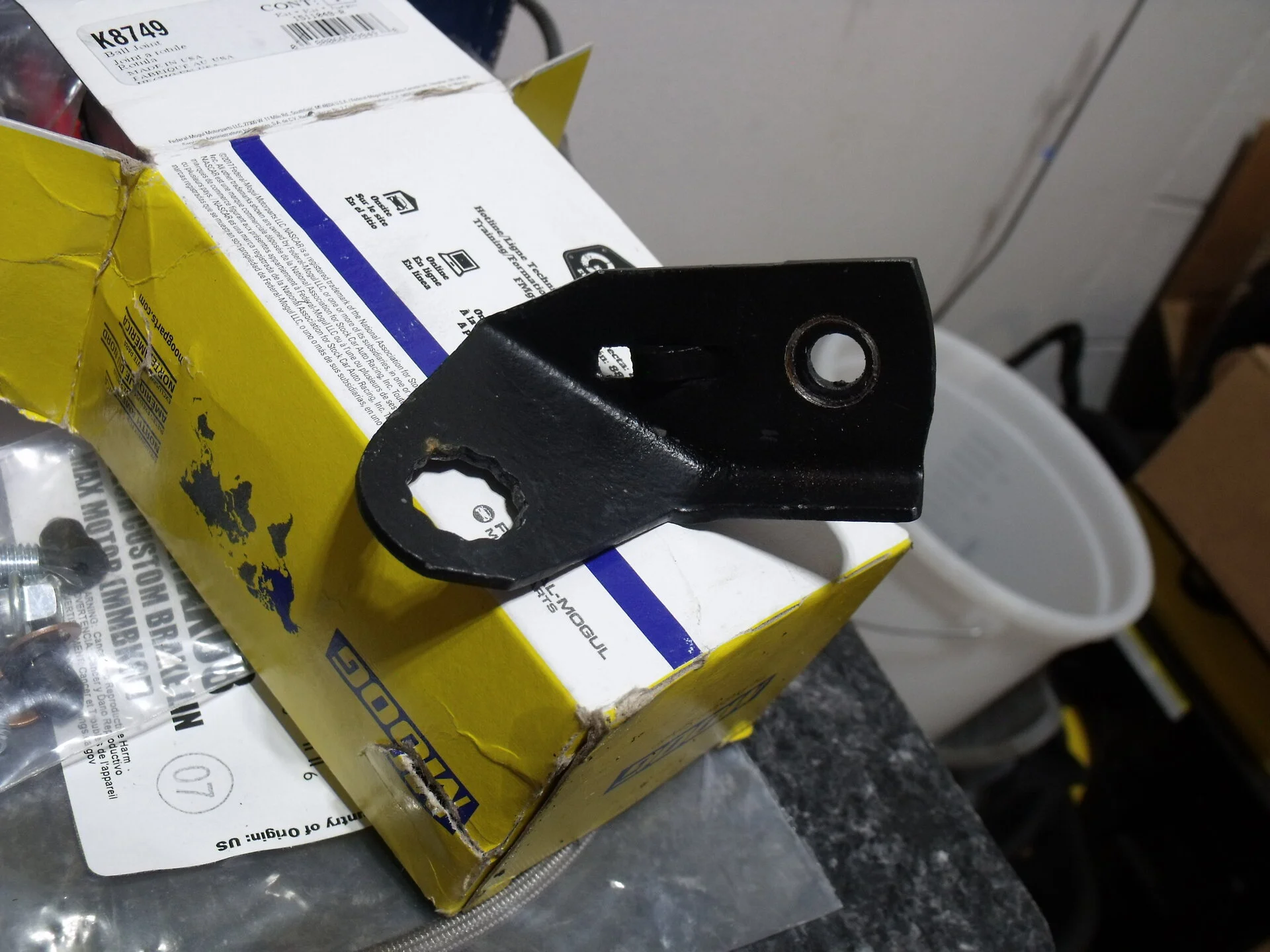

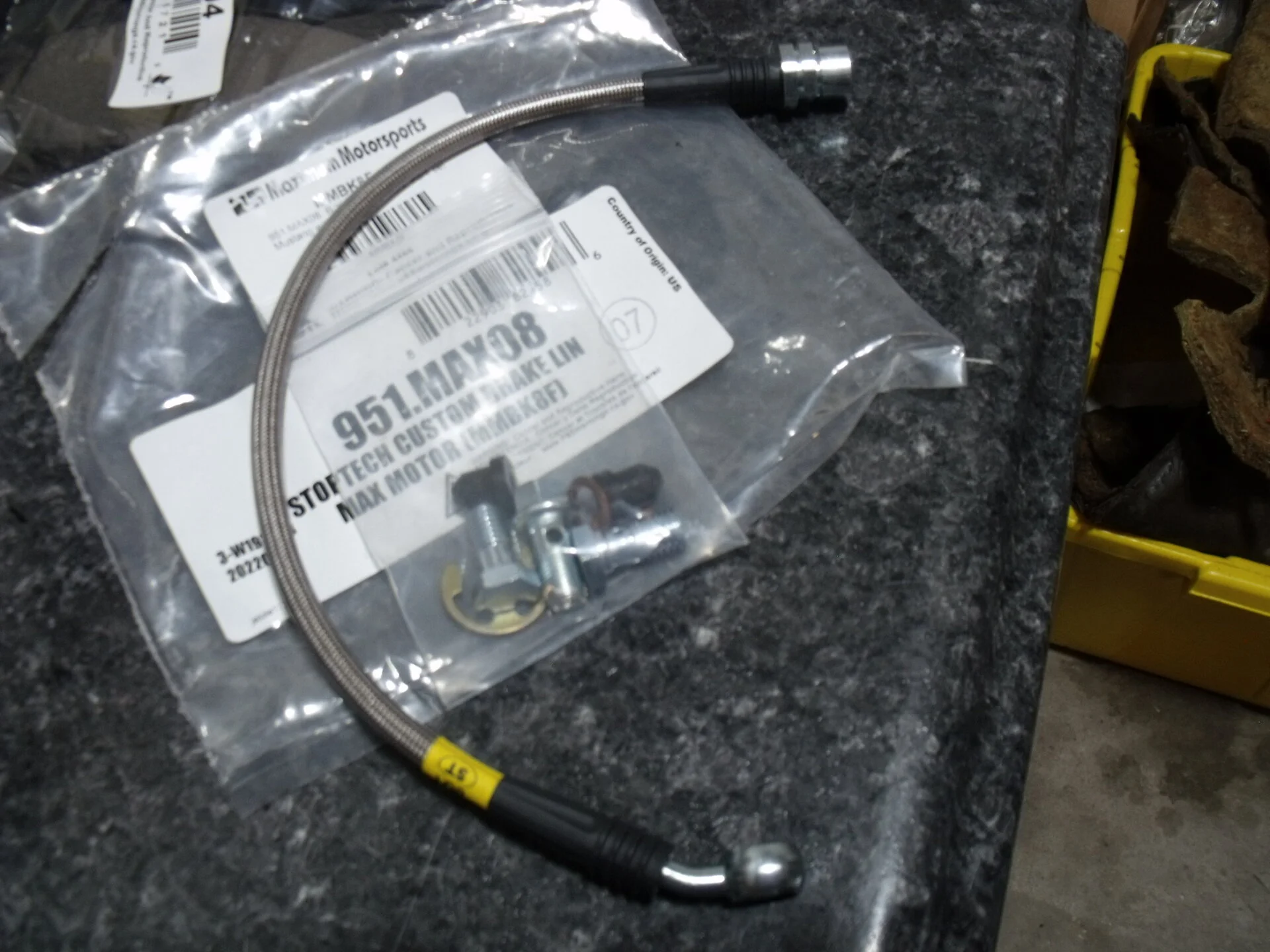

These brake lines are produced to install these calipers into a fox body.... I purchased mine from MM..... These are probably a bolt in on a 87 up car. My 83 brake hose brackets need mods to make them work..... Always something when changes are made..
