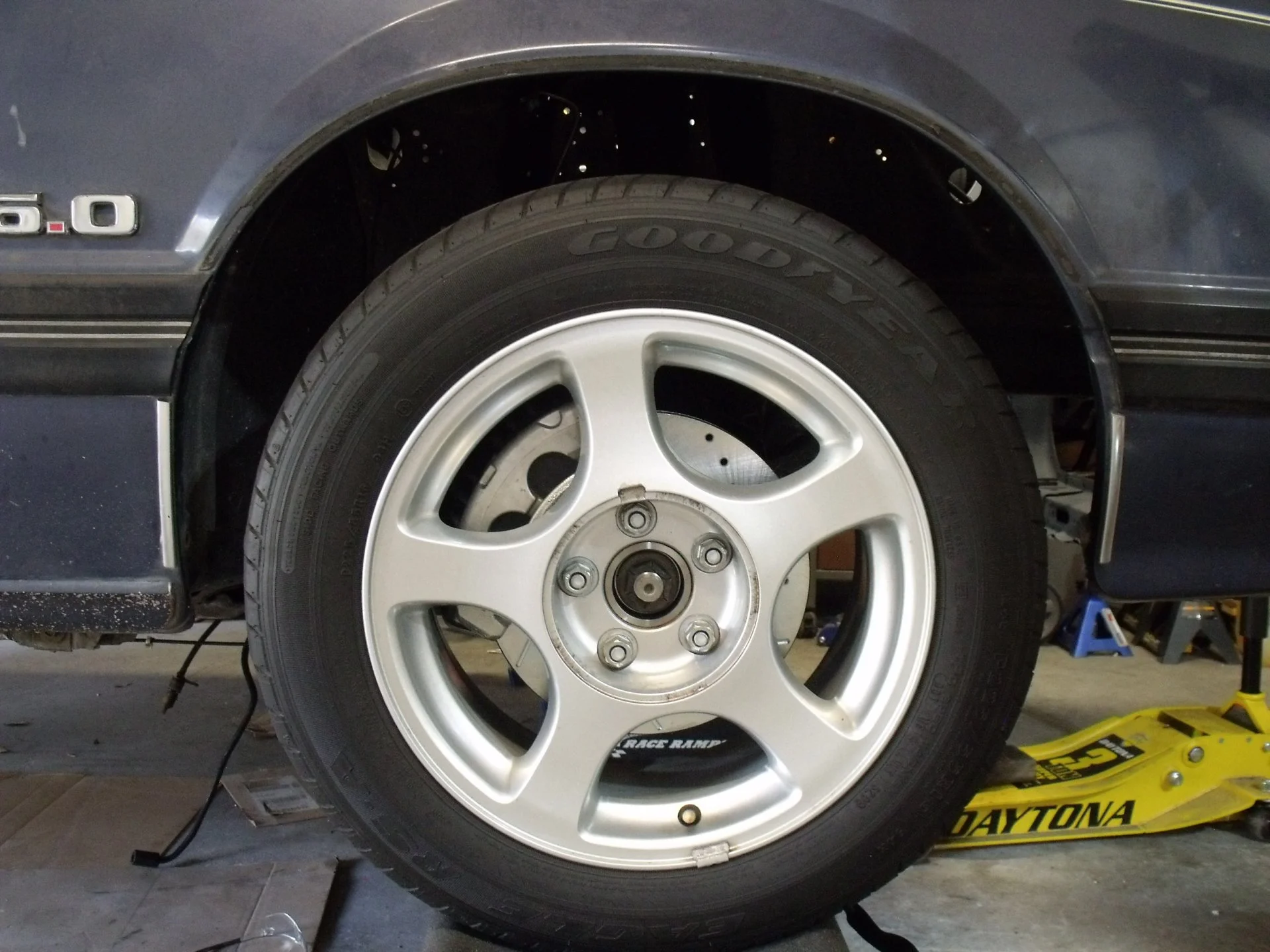

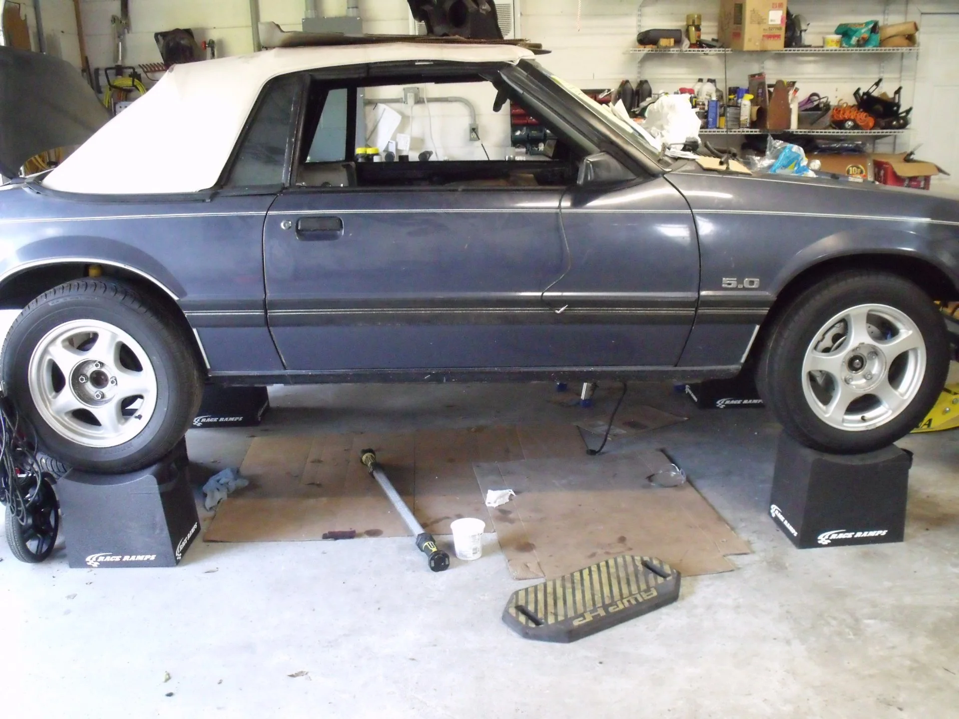

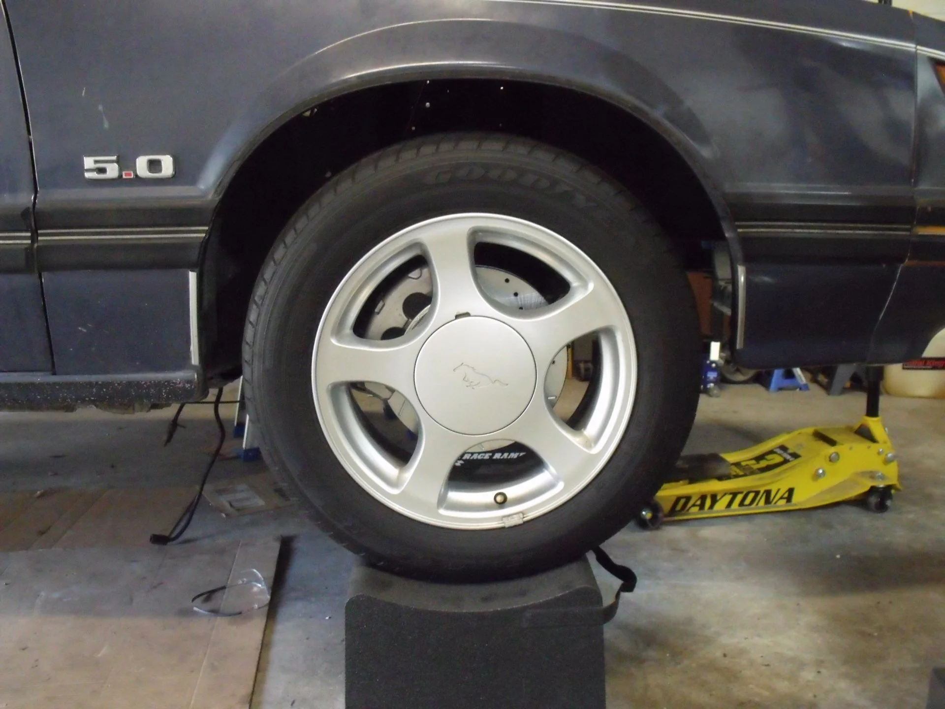

I found these wheels and tires off Craiglist for $50... I " think " the person I bought them from said they came off of an 01...... Worst scenario is they give me some wheels and tires to bolt to the car with its new 5 lug. LIke new condition....
Here is a pic with the 4 lug pony wheels still on the rear.....
I guess I have a set of pony wheels and the original TRX wheels to get rid of... Won't EVER be needing them again......
Next will be removing the 7.5 rear and installing my new 9 inch.....

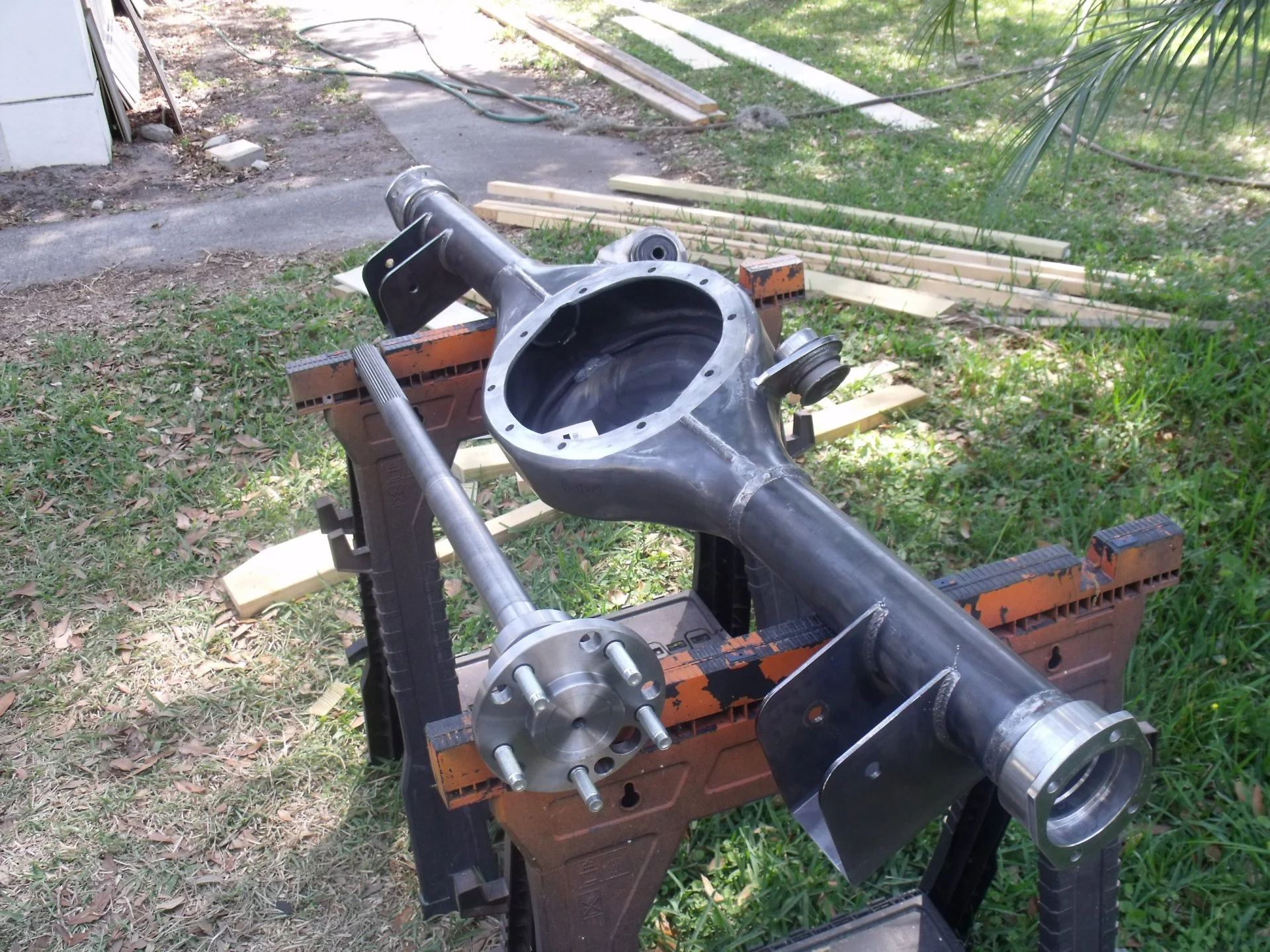

Ok, so now the rear " 5 lug" part gets going.. ..... Bit more than just " 5 lug" jouney here, but I thought I would continue this thread..
I have been waiting on parts, money and some cooler weather to continue here...
