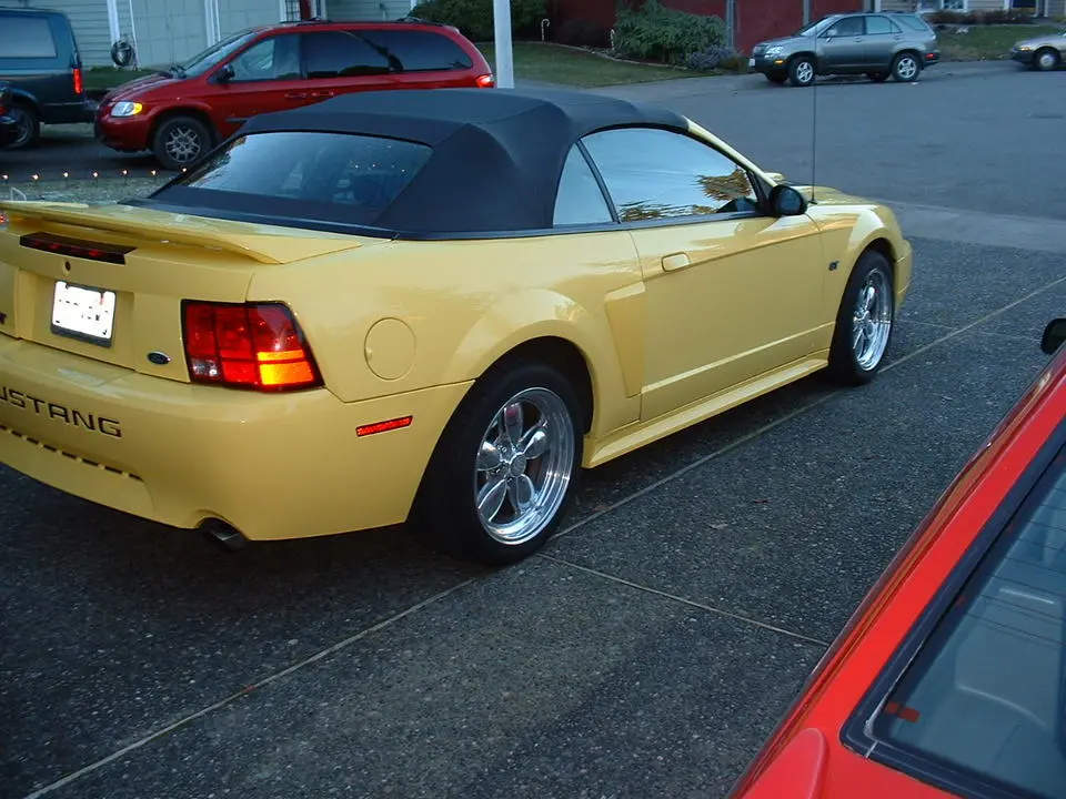

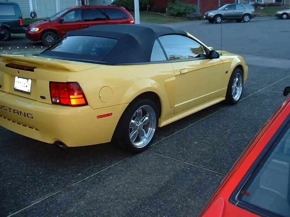

There is a big difference in ride quality between specific and variable rate springs,
The stock Racecraft specific's in my Saleen make it ride really rough, almost like a truck, actually most trucks ride better! but I put the Eibach Pro-Kit variable rate springs in my Vert, and it rides just like it did with the stock springs,
I wish I would have went with the Sportlines for a lower look though!

Get those Rancho springs out of the yellow vert! Too high. I have the H&R Sport springs in the 01. It rides exactly like the Racecraft/Eibachs but the ride height of the car is about a half inch lower.
