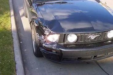

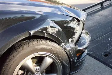

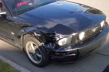

My babe got hurt! Will add Street Scene kit/RKS Hood
I have been so busy and am just now posting pics. Last Wednesday, I had this young girl cut in front of me to make a left hand turn from the third lane over. :mad: Nothing I could do to stop it but just cringe as I crashed into her. I have attached some pics.
Got a couple of questions I hope that everyone can answer. Since they are going to be replacing the front facia and hood, I was think about the Street Scenes kit and a Saleen hood. Is there a lot of prep work the body shop could charge me to get these on? What has everyone else been paying to get these kits on?
