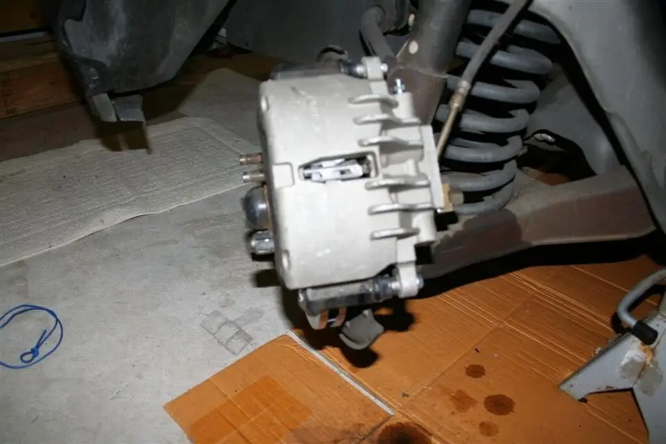

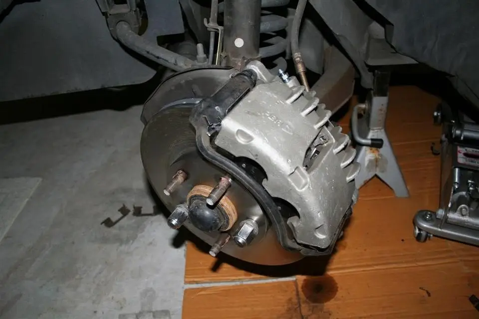

well, 2 months later and I HOPE my saga is coming to an end. I bought new calipers (rebuilt at Advance) for 44 bux each. Took the rotors in to be turned, found out they were all pitted. Oreilly people said it looked like heat spots. To me it looked like someone beat them with a hammer :mad:
I went with the Wagners with the lifetime warr. American made :nice:
so, I go to install them friday and one of the calipers had an issue. My torque wrench never clicked at 15lbs (worked fine on drivers side) when I installed the brake line. Stripped all the threads out. I'm guessing they were already weak since I put very little pressure on it. Returned it, got my replacement today.

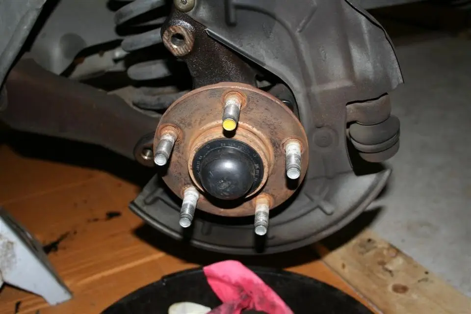

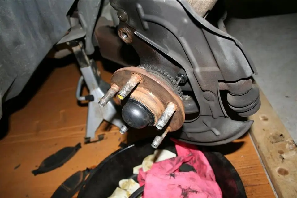

INstalled it, the new rotors, pads. Used antiseize and synth brake lube (did a TON of reading here!). I have hte front on jack stands, so I go to the right rear to start the bleeding. Decided to run the old stuff out and put all new fluid in. Bleeding is going well, the fluid goes from coffee brown to beer gold. Bolt up the wheel, move around to the left rear.
Notice the smell of fluid. Look at the front left and see fluid all over the floor. Turns out, the 15lbs of tq I put on that bolt wasn't enough. Tightened it up some more and went back to bleeding.
When I finally got to that wheel, I noticed a TON of air in the lines. It was all bubbly looking. I guess it's because it was sucking air the whole time? Good thing the caliper was empty eh? Took several trys to bleed that one, but finally got it bubble free.

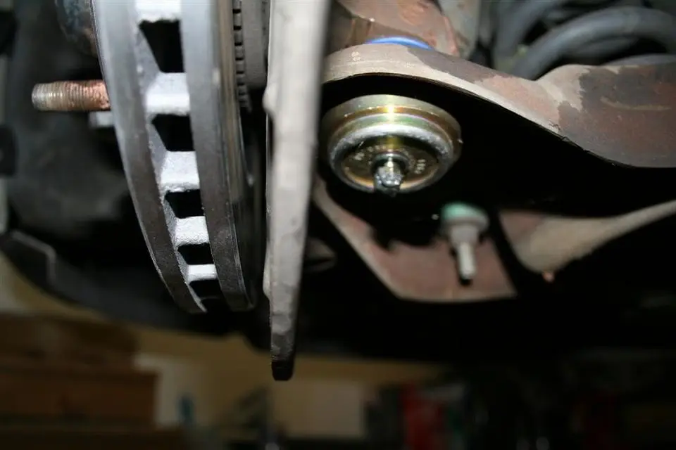

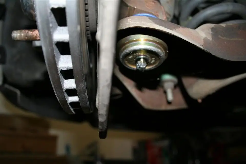

new ball joints. Did the old ones have Zerks? I thought I read they didn't
