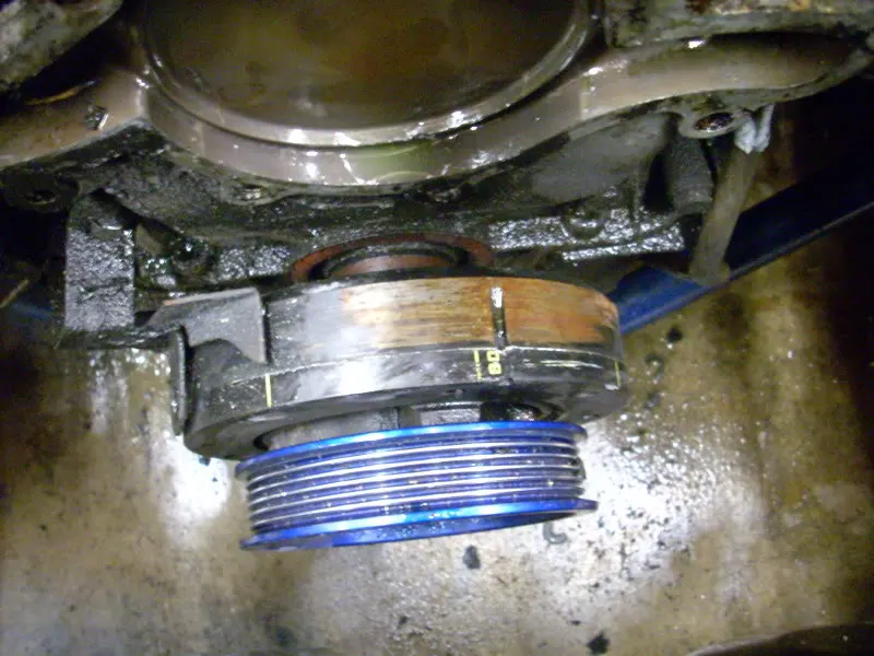

Found the problem. The balancer went to crap and was grinding against the water pump.
Kurt
Yeah, I'm really glad I found it too. The wobble was not bad enough to notice just by looking at it. but just to illustrate how bad it is. If you look at the outside edge of the balander, you'll see some yellow markings. Those are the remains of of a thick vinyl marking tape. (I put one of those $4 vinyl marking tapes from Summit on the balancer to make timing adjustments easier.) The wobble ground through the tape into the pulley.
