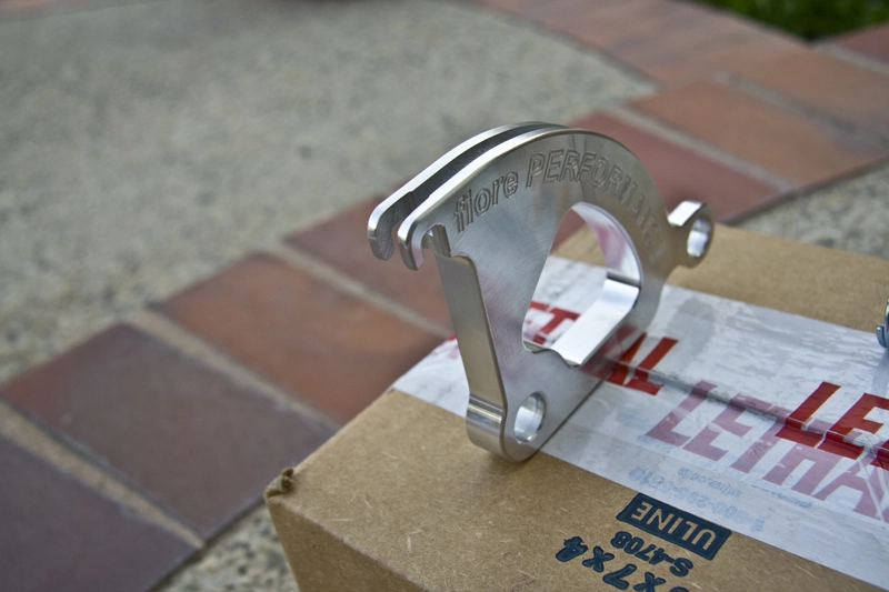

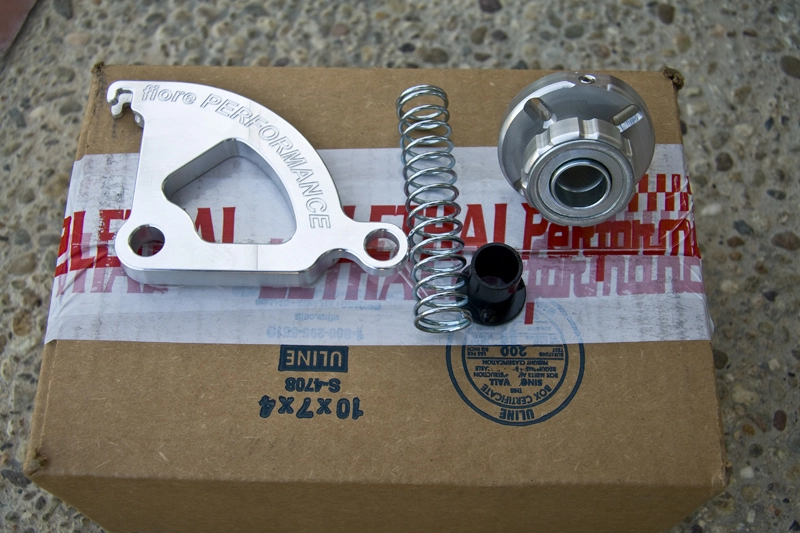

Fiore Quadrant, Firewall Adjuster, and LDC Clutch Free-play Mod - I thought since i was getting a bad ass clutch i would get ahold of a Firewall adjuster, quadrant, and the LDC Free-play Mod. After talking to Dave for a while and reading that Fiore is the best set up you can get i decided to go with that.
.....wish i would have done with a LONG time ago. This is a great set-up. I was Sick and tired of a inconsistent feeling clutch pedal. This makes the clutch feel the same everytime, everyday. I have it set exactly where i like it. The Fiore Adjuster is great and you need no tools. I just drove around town adjusting the pedal at stoplights getting it where i liked it. LDC Mod takes all the BS slack out of the pedal and you can feel that the spring is keeping the TOB off the clutch fingers.

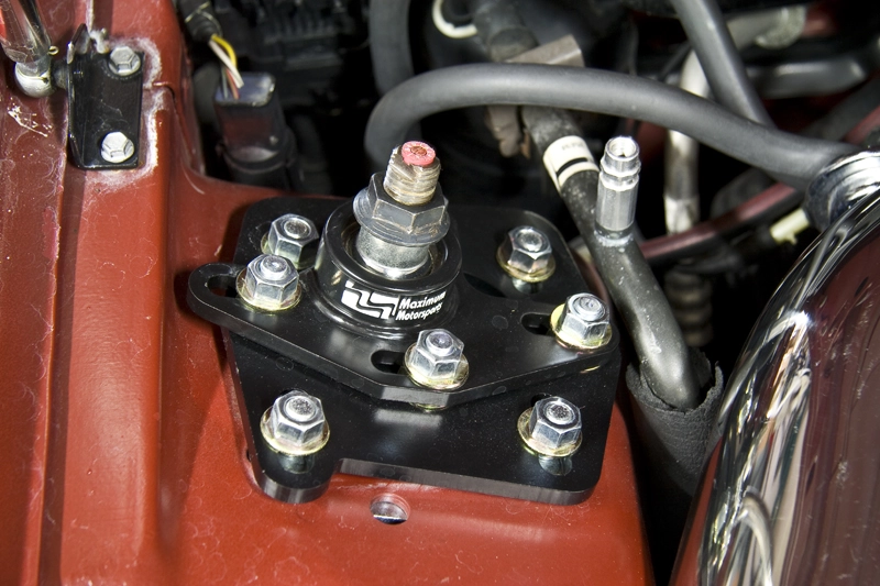

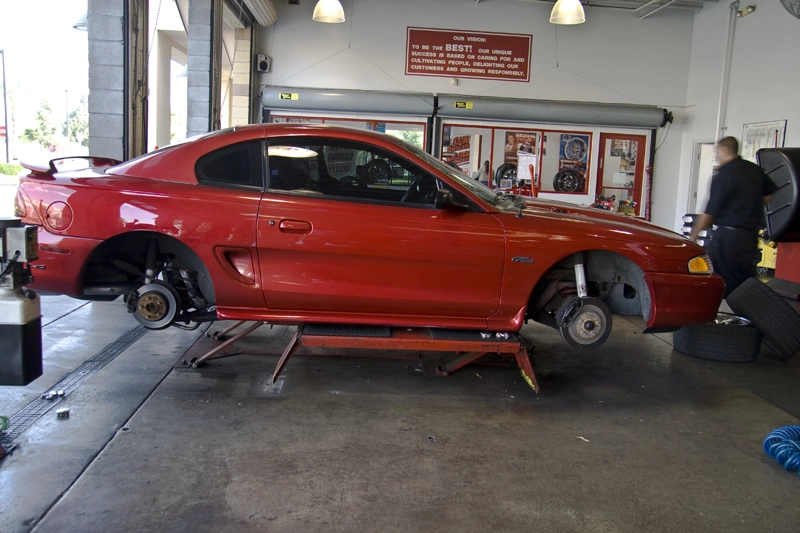

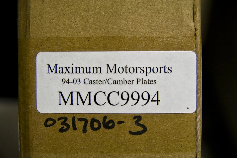

Maximum Motorsports C/C Plates - Another Piece of gold sent from the Suspension Gods of MM. I got these off Craigslist a while back for $125 NIB. Finally installed them. Install was a PITA. Hurt my hard pretty bad in the process of a jack slipping incident. Had to play around with the spacers because the hood wouldn't close.Got the car aligned by Darin@WestEndAlignment> every Porsche, BMW, NSX and High performance car forums recommended him. Had to book 2 weeks in advance. Before aligning my car he sat down with me and talked about what kind of driving i do and set up the car accordingly. He recommended a Very aggressive street set-up just on the border of become a race spec alignment. Car Now drives even better. Took it Auto-Xing a few weeks ago and raped a C6 Z06 by 4 seconds!!! :coolsmiley:

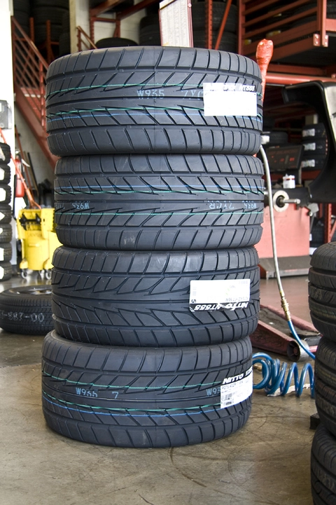

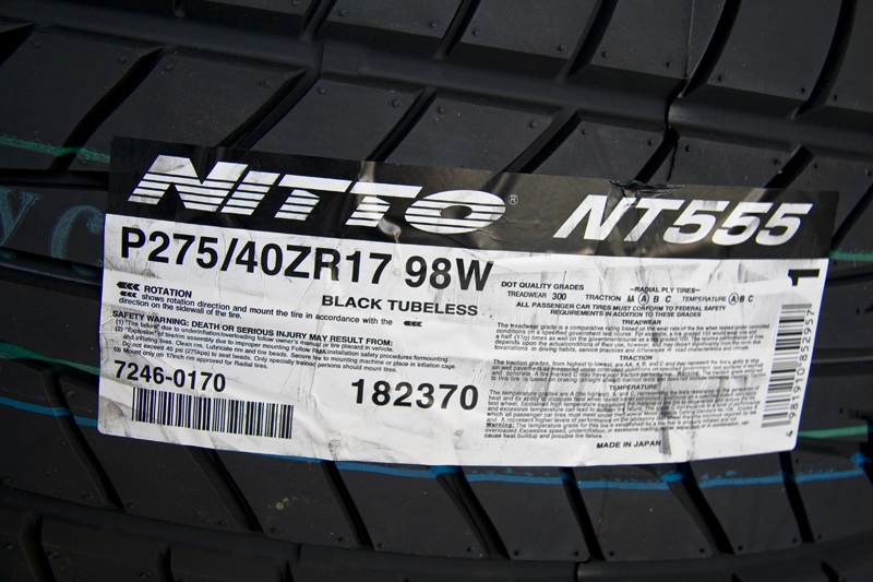

New Tires Nitto555 - Got some new rubber because rolling around with negative camber ******* my tires.

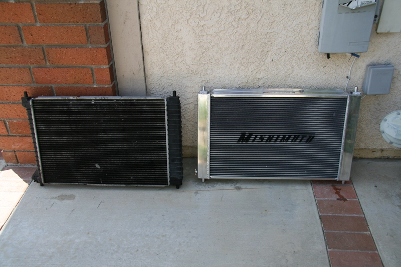

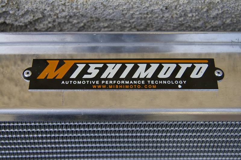

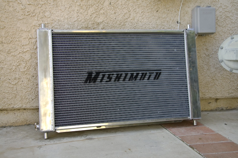

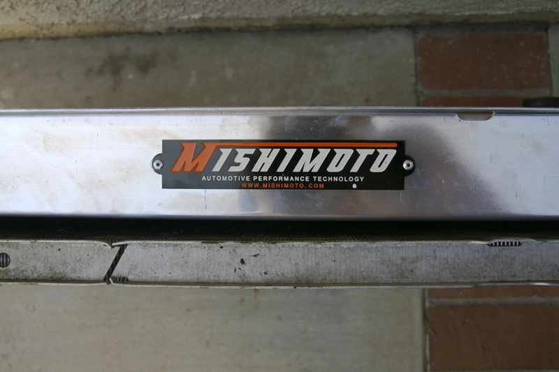

Mushimoto Aluminum Radiator and New 192 degree T-Stat - Out of nowhere one day my coolant started getting REALLY hot. Gauge got close to 250 but when i stuck my had in the coolant it was just a little warm, not even hot. Pulled the T-Stat and boiled it and it Barley even opened... the smallest crack. Got a new T-stat from Ford. The stock one from 1998 that i pulled said 195 and the new one from Ford is a 192. The new one also is designed a tiny bit different. This fixed my problem but since i live in Hot So. Cal i picked up a Mushimoto Radiator from ThePope. The Radiator dropped in fine, all i had to do was trim the top mounts. Mushimoto quality is excellent and the car runs cooler. I was find out how godd it works in Los Angeles traffic tomorrow. Stock radiator is so damn thin no wonder our cars run so hot.

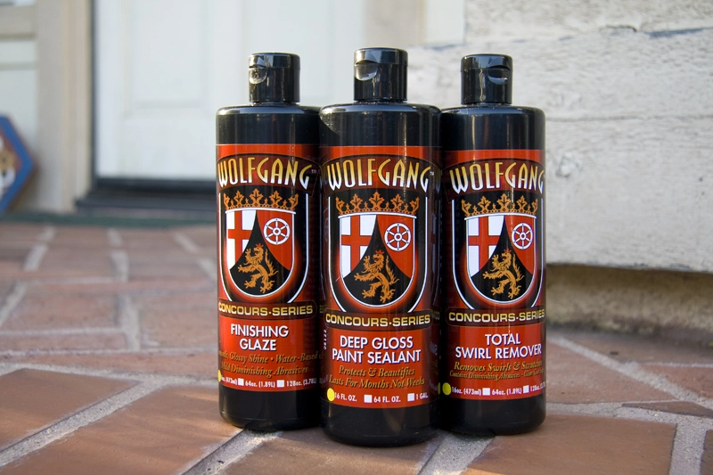

Wolfgang Concours 3-Step - Bought this because i wanted to see how it works. I used this on the Sl55 I detailed. Stuff is BOMB. I am using it on my car now teamed with Some 1Z Glans wax. The swirl remover is the best i have ever used. Pricey, but worth it.

I thought you had CC plated already. With that killer stance your car has it must have some serious negative camber :shrug: Your alignment shop will love you for installing thoes though :nice:
And sorry but I had to laugh at Mushimoto :rlaugh: Never heard of them but thats the name of the tires they were looking for in F&F :D 3 black Civics with green neon and Mushimoto ZX tires :nonono: Ive seen that movie way too often :(

I cant believe you didnt invest in those CC plates a long time ago...Thats like the 1st mod I do when i lower my stangs, especially with the stance your car has.......+1 on the CF clutch, it has the perfect pedal feel & it grabs good....The radiator looks nice too, I think I might need to look into one for my notchback...

Handz, where are you getting the Wolfgang setup from. I fail at search. I just find the second step glaze for $35. Is this stuff really gonna be over $100 for all three stages?

i bought the Wolfgang stuff from Autogeek.net...and yes, it over 100 dollars EASY. on those 3 bottle and some pads it spend like $200 :D

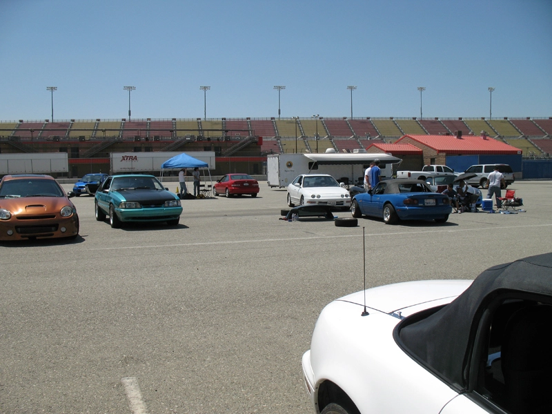

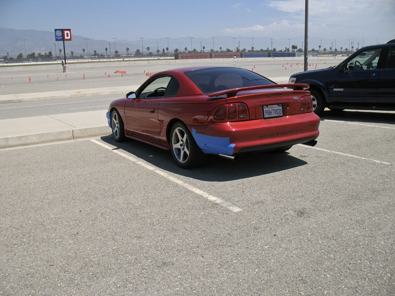

Pics From Last Month's Auto-X Event!!!!
Sorry, but went to this event By myself so i couldnt take pics while driving and wasnt comfortable taking my DSLR and leaving on the ground while i was driving. Anything could have happened to it so i left it at home. I took the point and shoot and snapped a Few pics.
I had planned to take more pics but this event was "Unlimited Runs" so i spend the whole time driving.....got 29 runs in during the day :dancing6: with a best time of 44.1xx
Just for reference....
Average Time for Most cars - 50.XXX
My Best Time - 44.1XXX
Best time of C6 Z06 - 48.XXX
Best time of New BMW M3 - 48.XXX
Average Miata Time - 41.XXX
