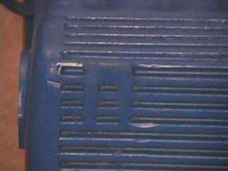

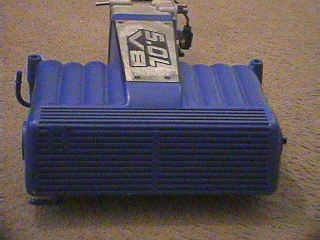

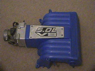

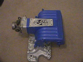

I used a cutt off wheel and air tool to take off that little thingy u guys are talking about on the explorer upper. Then i used a 3m buffing wheel to even it out smooth with the intake. After being painted blue i think it looks good. I'll post a pic of it soon.
:nice:
alright here ya go. Who says explorer uppers are ugly? :nice:
