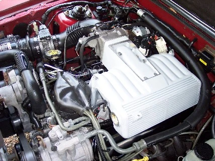

A pic of my almost finished project (no intake cover now). It's designed to look stock yet carry a pretty mean punch. Specs in sig. Never been to the track or dyno. I only see it about once a year, but man does it ever get wrung out when I do.
v8only said:
can't use corral to link your pic. it won't show.
Fixed. Not all intakes have to be painted or polished. I actually bought this one new out of the original Ford packaging on Ebay. It was a bit expensive, but it has that sleeper look I love. BTW, the ear on the intake was for a throttle cable mount I think. I just left it.
