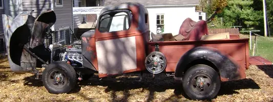

I'm putting these photos of my hot rod in the forum at the request of a member, that thought some of you that build your own car might be interested. I won't include all the photos since I have 2 large 3 ring binders of them & I'm not done yet. My back ground is in auto mechanics as I've worked as a line mechanic for years & then into service writer. I do not have any body shop knowledge, interest or skills so the body work is not the best (it's kind of crappy but it's all I can afford). I'll include a couple of photos of the beginning & come up to date as it sets now. I'm using a 351W that I built, a T-5 from a 1988 Mustang GT, 1980 Bronco 9" rear end, it has suicide doors & a tilt front end for real easy access to the engine, rack & pinion steering from a Mustang II with a Thunderbird manual rack. If any body is really interested or bored I can email them more photos or answer questions.

Very cool project! Your 351 looks nicely done. That original grill looks like a yard gate or something, and you really should have left that wooden bumper too, haha! Im sure you know the stock T5 tranny wont hold a lot of power, but if its just going to be a cruiser then you have no worries. Thanks for posting!
I realize the T-5 won't hold a ton of power but I didn't build the 351W up all that much. Since it had to be bored I did have the machine shop get me 9 to 1 compression ratio pistons & it was bored .0040 over in order to clean up the bore. Other than that I only freed up some HP by using 1.6 roller rockers, gears instead of a timing chain, electric fan to suck cool air thru my all aluminum 1970 Mustang radiator & I did find a windage tray from a GT40 Mirage & I'm using a high volume oil pump. The cam is just a step or so from stock to deliver more torque than HP but I don't think it will be over 300HP & I do intend to use it as more of a daily driver. There's not much left of the wooden bumper anymore & the "grill" is actually an old grill guard that I heard they had either a kit or plans where you could make a grill guard out of a front steps railing, they were unique back then. I haven't figured out what to do with the actual "jail bar grill" but will probably just make a tube grill for it.
My brother has the original cab, hood & fenders since the cab was real rusty from setting in a field from 1989 to 2004 so when he heard I had bought another 46 Ford pickup he asked for the old cab & since he owns a body shop I figured he could fix it better than I could. Now we both have part of dad's old truck. The "new" cab needed front & rear cab corners & the fenders had been cut bigger so it could be lowered but I have it closer to stock height & ended up using the bottom of dad's fenders to make the fenderwell back to original. I have parts from so many other vehicles it looks like a Frankenstein until I finish the body work & finally paint it.
