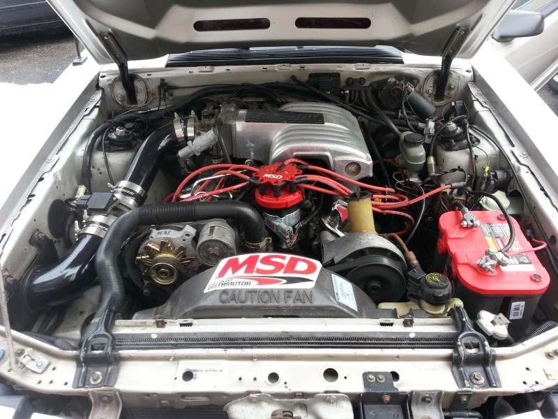

Long story short, I just picked this up, and I want to upgrade the heads/cam/intake immediately.
Was told that there is a rebuilt 306 in there. Currently has:
BBK headers
Flowmaster full H pipe exhaust
Cold Air intake
Aftermarket oil pan
MSD ditributor
Optima Battery
I'd like to put down around 305-315rwhp and it's sole purpose is weekend driving So I'm flirting with the idea of skipping the wait of trying to piece a kit together and going right into a Trick Flow top end kit.
I'm looking to pull the trigger on an order today. But if someone has a better/cheaper idea, I'm all ears.
Are you sure that you aren't currently putting that power down? I'd maybe pop in a more aggressive camshaft and do a tune. I think it might be cheaper and you may meet your horsepower wants/needs.
Nice looking! Stock heads? And 306 without a cam:confused:? It probably is just an overhauled/stock 302 not that it matters if you're planning on a topend kit. Depending on money I'd piece together my own kit and make a little more power than the tfs kit(usually they make around 290rwhp). But it is a good streetable combo and all inclusive.
It may have an upgraded cam but I have no way of knowing. The motor runs very strong.
What would you suggest besides the TFS kit?
Depending on what pistons you have for either inline valves or tfs twisted valve angle I'd run either AFR 185cc heads or Tfs cnc 190-205cc heads. They are more expensive but make max power and are big enough to grow with any future mods(like blowers/turbos etc). I'd package that with either a Holley systeMax intake,tfs box r,or an edelbrock rpm. Then I'd add a custom grind hyd roller cam for max drivability and power production. But this route is a max effort(read costly & more powerful) build.
The best budget build IMO is to look for some good used Alum heads with a used above mentioned intake and a custom cam. Whatever way you go get it dyno tuned. Obviously add all the supporting items like injectors,matching mas meter,fuel pump,exhaust,ignition,etc.
If your car is a 306 you should be able to reach 300-325 rwhp with regular tfs 170 heads and a good cam. With the big heads,cam,intake you could/should make 330-360rwhp.
