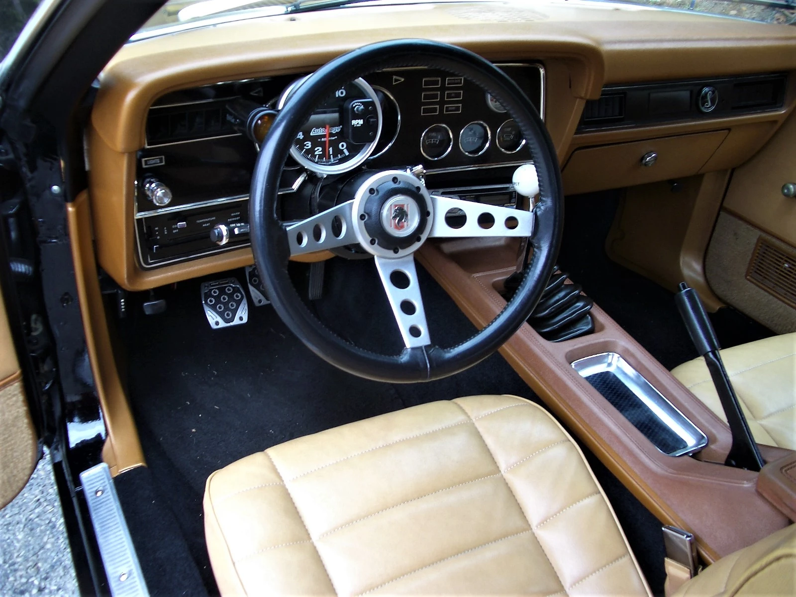

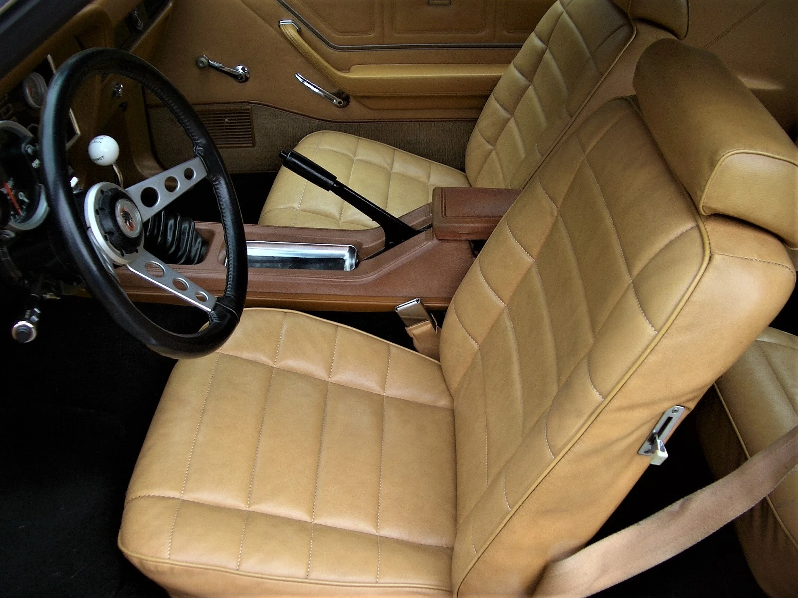

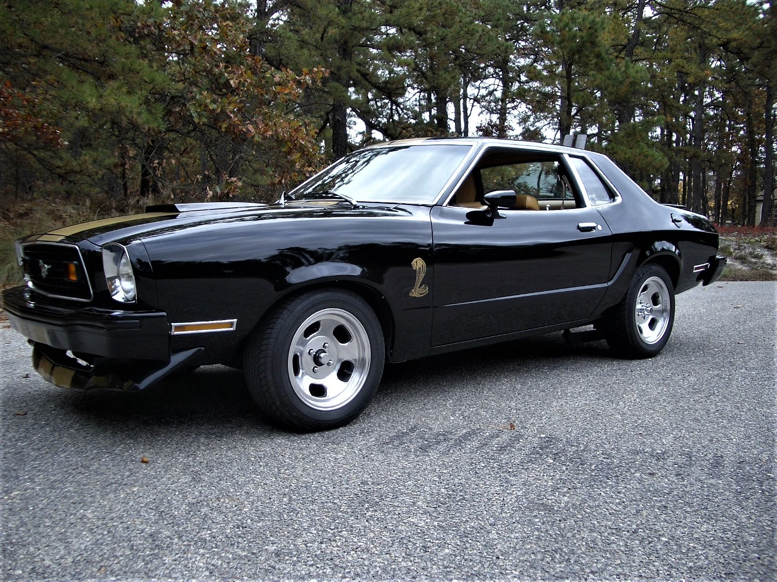

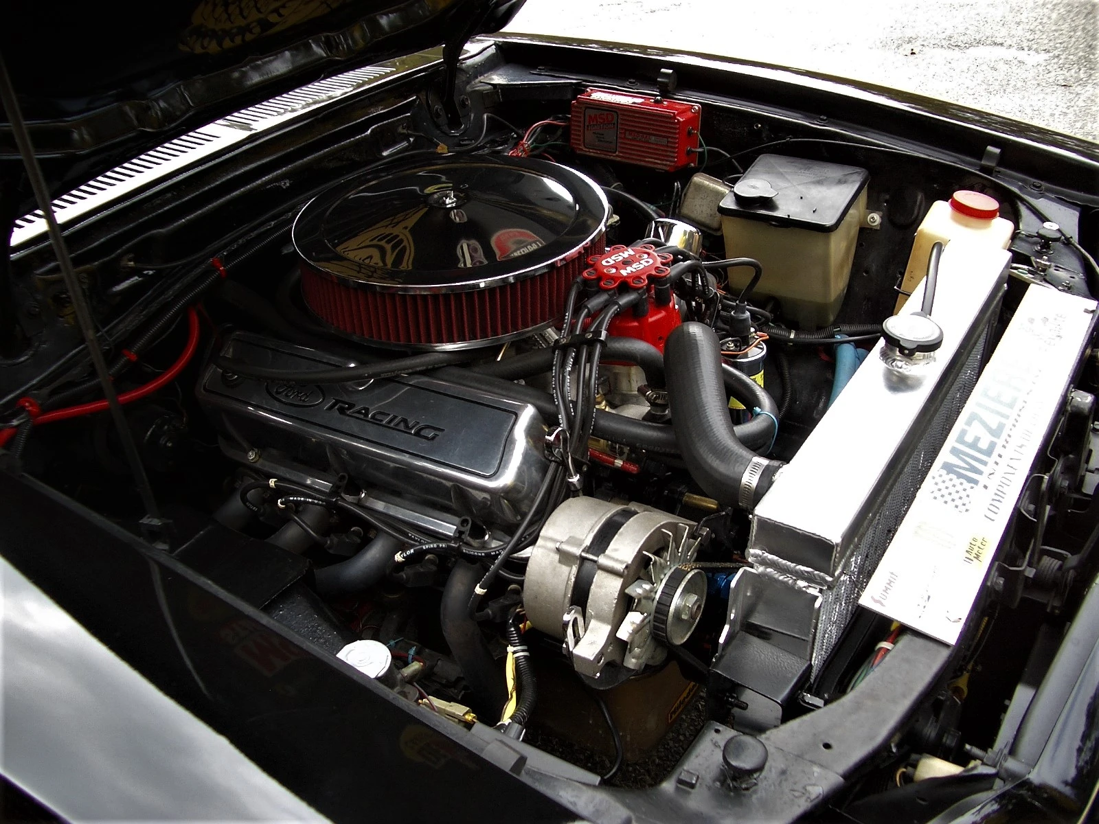

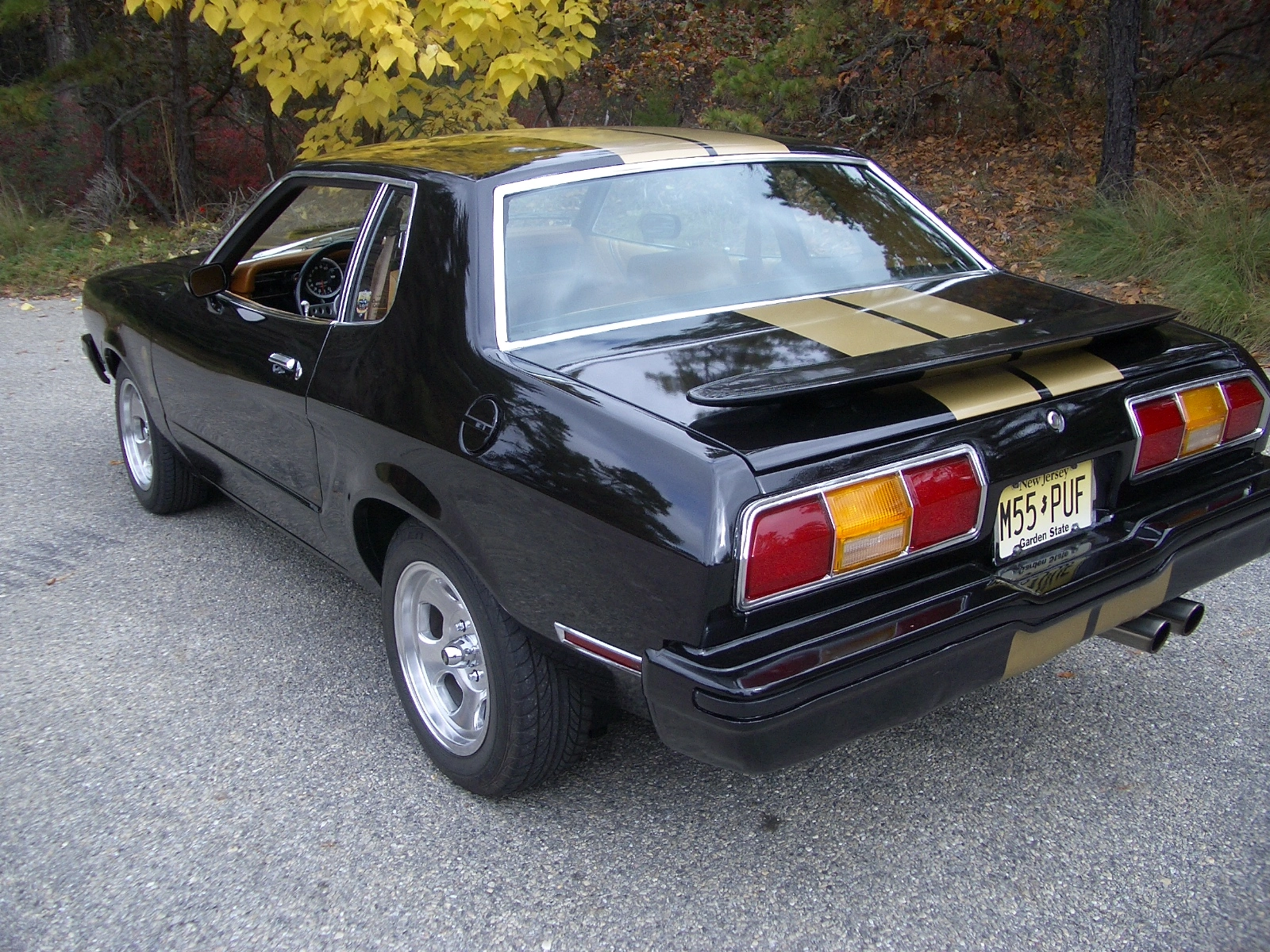

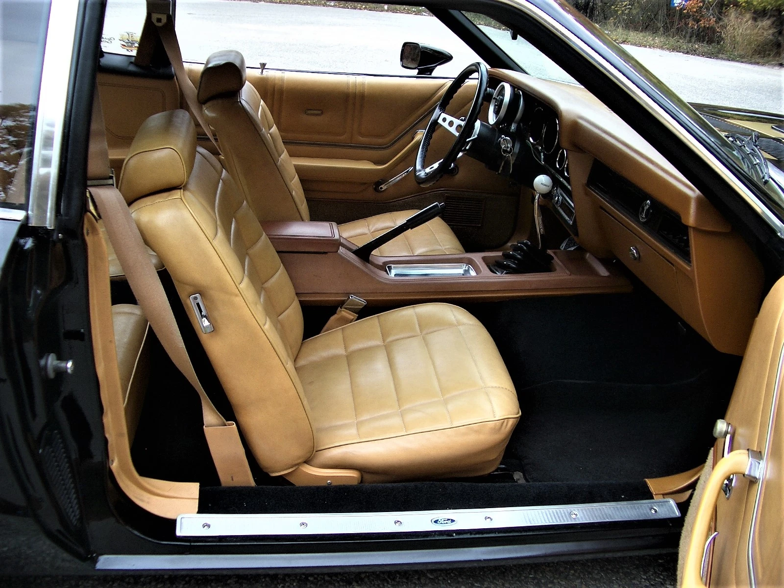

Hello all, I'm new to this site. I just picked up a super nice high performance 1978 Mustang Coupe 5 spd. This is my 3rd Mustang II. Previously owned a '77 Cobra II and a '78 King Cobra. I just love these cars. The Coupe is running a '71 302 balanced and blueprinted, 5 spd. Tremac and Auburn 3:55 rear. The guy I bought it from put all kinds of HP goodies into her. I just started getting a driveline vibration I'm having checked out tomorrow. I removed the rear spoiler and ordered a new front spoiler. I'm getting the Magnum 400 wheels I just can't decide 215 60 15 or 235 60 14.

That is clean. I would do no bigger than 215 up front. They will most likely rub. It's what I run. The fender liners are removed, seam is flattened and fender lip rolled a bit. I still rub. I am contemplating getting coil overs to raise my front end a little and decrease the rubbing. 235 in rear. Rears clear fine for me.

Thank you. I think I might go with a 235/60 14 Cooper Cobra with the Magnum 400's. I hate to drop down from the 15" slotted but the 205/60 15 don't do it for me. The wider and white lettered Coopers I think will wake the car up and more of a vintage look.
I think the magnums are only available in 15x6. I started with 215/60/14 up front and chasing a vibration replaced the wheels with 15". The 215/60/15 are almost 1" taller and rub more than the 14's. I am fine driving straight but turning into aprons or parking lots i rub. I am not a fan of the 15's up front to be honest. The 15x8 look great on the back. 15x7 is too big on the front. The car looked better with 15's on rear and 14's on front.

Yeah, the jury is still out on sizes. The Magnums are available in 14 x 6 and 15 x 6. I wish they offered wider as well. It's going to be an expensive package and I'm so afraid of making a mistake. My car is a stock ride height and I don't want to do any mods on the fenders for clearance.
