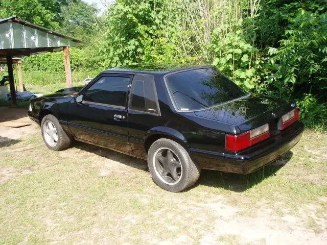

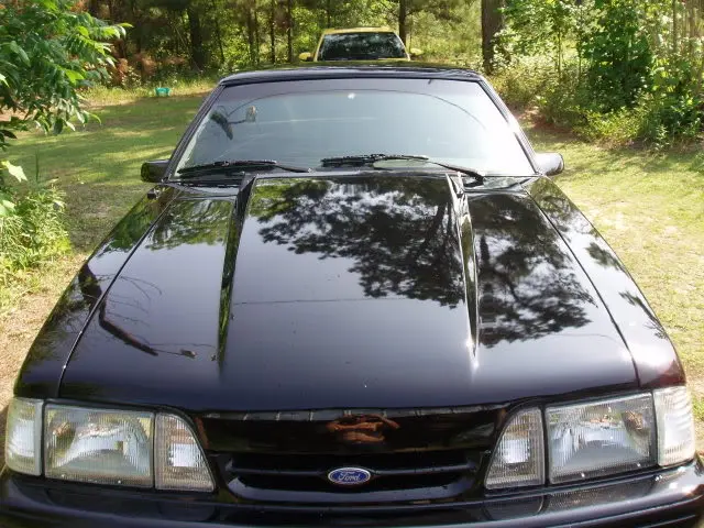

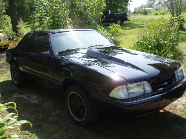

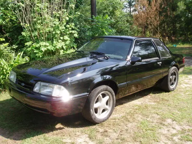

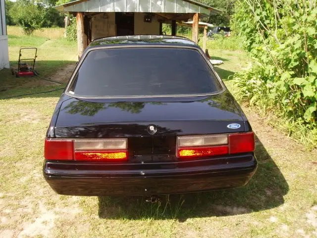

ok guys and gal here are a few semi better pictures.
First of all i know it has imperfections and i know it needs work. I just cant afford to have a pro do it. i plan on wet sanding and buffing it after the engine gets in.
I personally think for the money i didnt do to bad. I only have about $150 invested in the paint job. FYI this is my first attempt at painting black.
I figure i can fix all the stuff i missed this winter and redo it.

real glad to see your thread back my man. cars looking great. what areyou driving to work if the stangs not done? i thought you were dailying it now?
yeah but im with what everyone says, dont feel bad that there are a few iffy spots, everyone misses spots. i have dings and stuff too still. you did really really really good for 150 dollars and it being your first time. just try wetsanding and stuff, allot of that stuff works. your good at getting stuff done and moving right along, so dont let this stop you. go get her runnin and get them wheels in. it will look wonderful.
keep it up my friend.

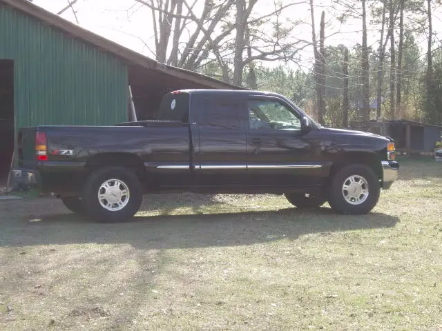

i have a truck now. my dad wanted a new truck but right now he has out some big time constructuon loans so his credit is tied up, so i made him a deal. sell me his old truck for cheap and i will get him a new Z71 cause i have teh good credit.
anyways here is a picture. BTW i hate focking monthly payments.
2002 gmc z71
