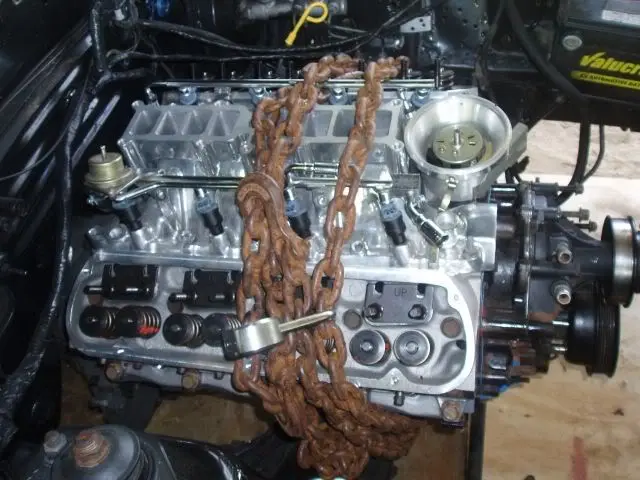

ANyways....car looks frickin good! That motor shot, locked up my index finger, and I couldn't scroll the mouse downward for about 5 minutes!!! Looks awesome!!!!!!

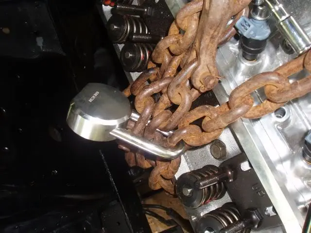

aint nobody stealing my crap...
http://forums.stangnet.com/756164-help-me-out-guys.html
It took the Fire Department to get through a chain and lock like that on our front gate when we had an after hours fire here at the yard. I doubt someone out in the boonies will have bolt cutters that size.
1/2"???
DAMN!!!!!
yep. i got it off an old abandoned ship in brunswick, GA. it was part of the anchor chain. the anchor was on the bottom and some guys took a torch an dcut off the chain at the water line and i got what was from the water goinginto the boat. i just went inside the hull unbolted it and took it.
mofo is heavy. thats a 3/8" in the pictures.

have a little update. got a few parts in and the car should be running in a few weeks. im hoping to get a new cat back here real soon also.
anyone want to guess what it will make on the dyno?
Combo:
357w with trw forged pistons, 9.5 compression
Custom grind Lunati cam:
Advertised Duration (Int/Exh): 285/285
Gross Valve Lift (Int/Exh): .540/.540
Duration @ .050 (Int/Exh): 238/ 240
Trickflow heads with dual valve springs good to .600 lift
Typhoon 351 lower, edelbrock performer upper
75mm throttle body
24# injectors
BBK swap headers, off road H-pipe
Ram race clutch, 3.27 gears.
