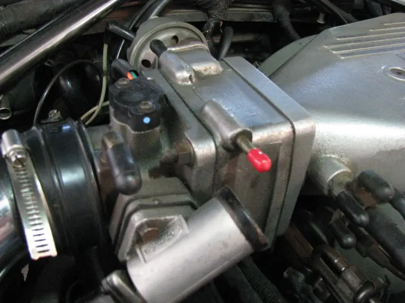

From what I can tell the TB has no markings on it.
Does this look like a stocker? Does anyone know what type it might be? I can post other pics of it if that would at all help.

should run pretty decent. take the intake tube off and take a pic of the butterfly. or just measure it. my ford racing 65mm throttle body doesn't have any markings on it, i bet the 70mm doesn't either. it could be one of those.
Will do. It runs pretty darn good. Especially after it was throwing codes and I put a new TPS on. Runs great now! :D
