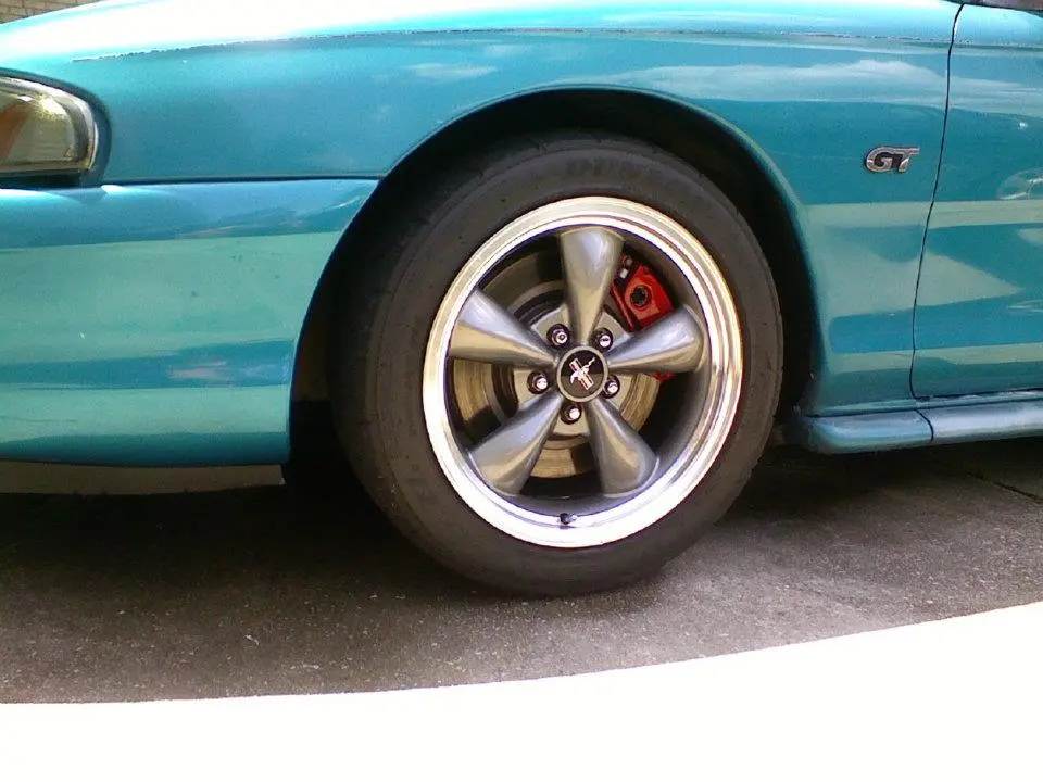

Well, the work of a father never ends, so the only pics I got today are of these:
I planned to work on Cheapskate today, but by the time I got my son's 13" brakes installed, I didn't keep going on anything else.

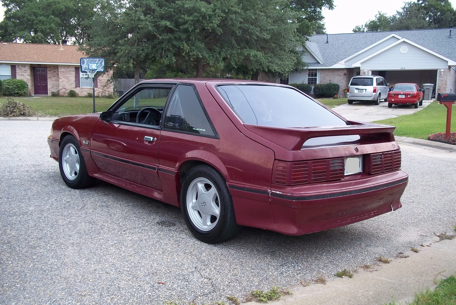

Well, I got the new fuel tank installed today and finally drove the car for the first time.
It runs pretty good. There are 4 cats, but no mufflers, so it's loud, but not nearly as loud as I thought it would be.
The steering wheel is upside down when driving straight down the road. LoL!
It popped out of first gear a few times, but only when I was pedal to the metal...
Normal driving it didn't pop out of first.
Didn't pop out everytime I was hard on it either. I got a couple of nice burnouts in.

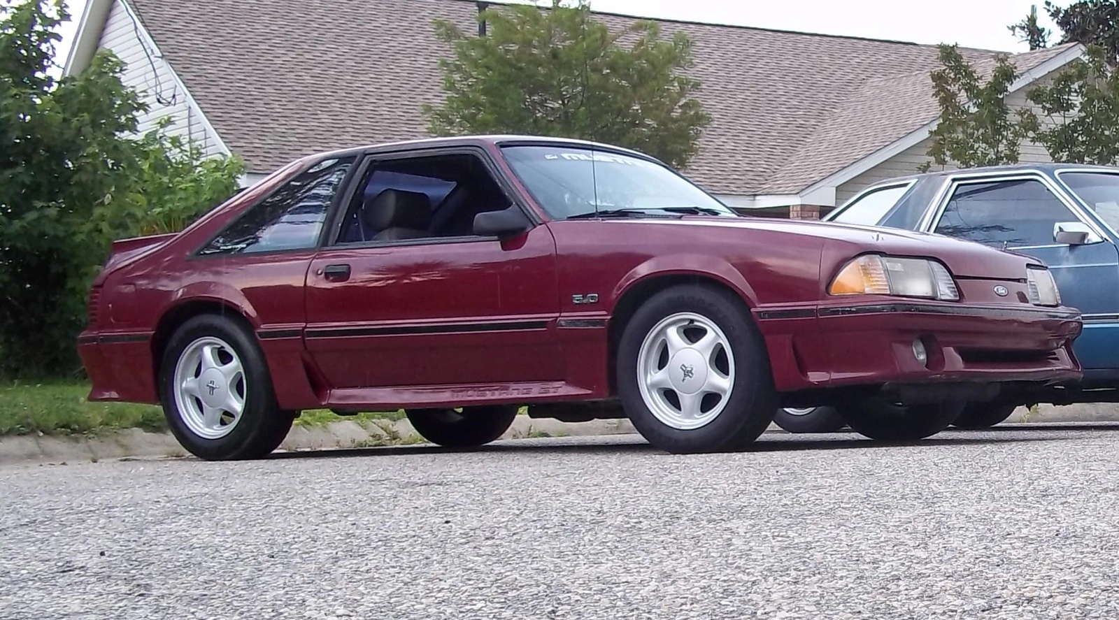

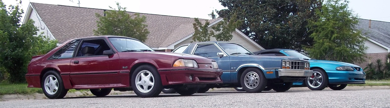

We washed all the pasture gunk off it, and it doesn't look too bad.
Other than the front and rear bumper covers, it is about a 20' paint job.
I took some pics, and my 2 sons were there, so they got in on the act.
The tires aren't all that great, but the Pony rims are nearly perfect.
What do 90% Pony rims go for? I have a couple people interested.

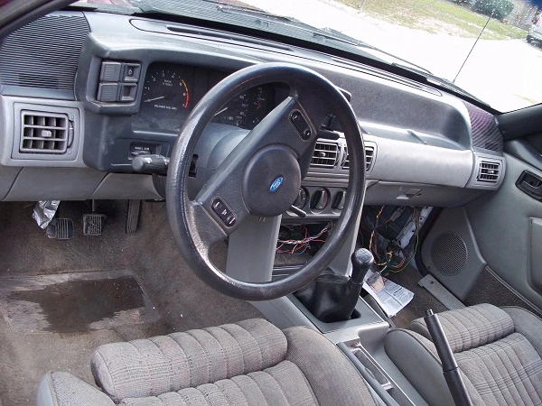

That sounds like a pretty awesome deal. So weird about the steering wheel!
It's got a long list of little items like the steering wheel, that need fixing.
Loose driver side fog lamp.
Passenger door glass, only glass not tinted.
No mufflers.
Passenger tailight needs replaced.
Driver's door panel needs replaced.
Driver's door handle chrome... needs painted black.
All gauges work now but the speedo.
No radio or dash trim around radio.
ECM laying loose on passenger floor.
So on....
Lots of little crap.
