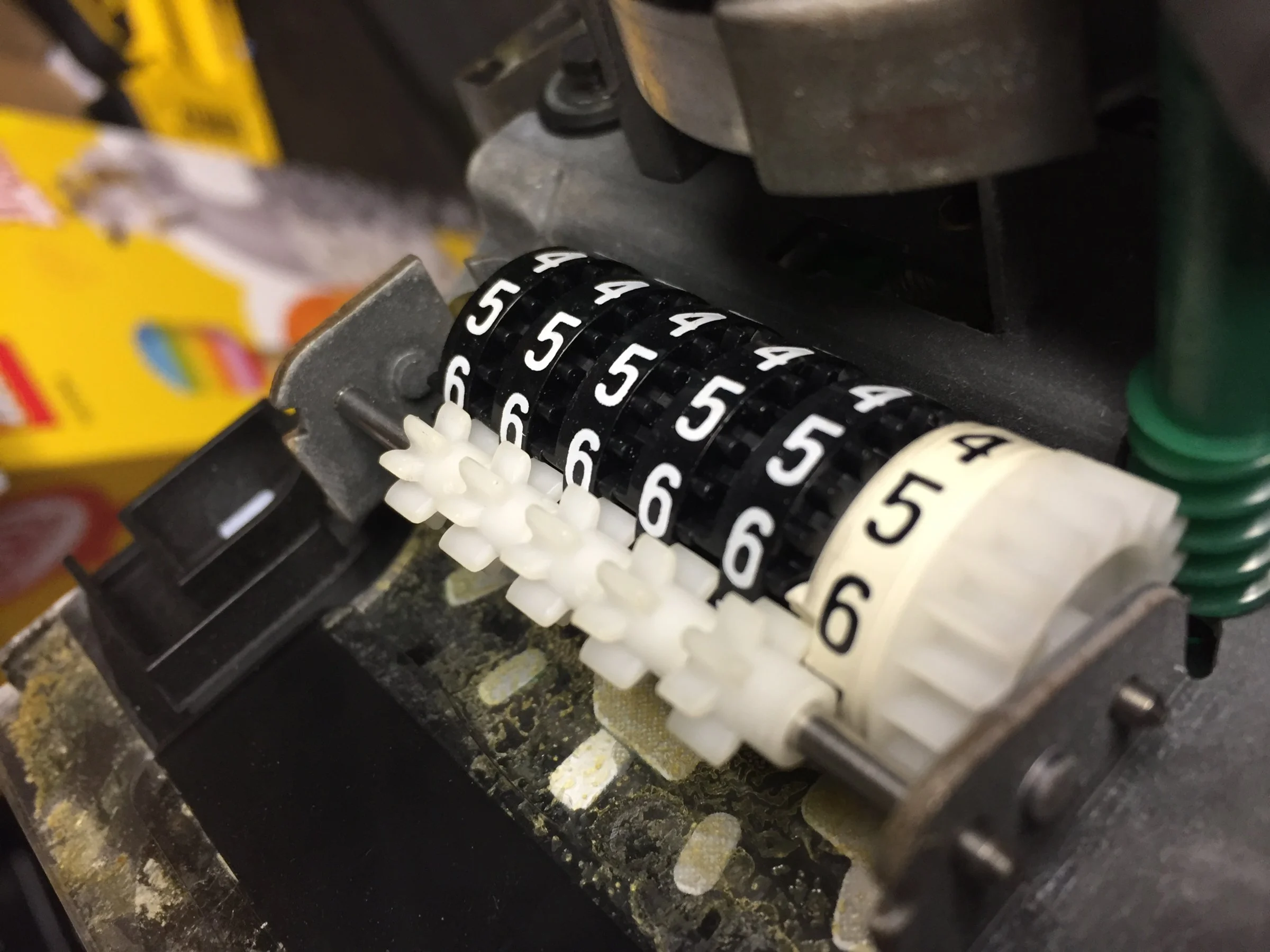

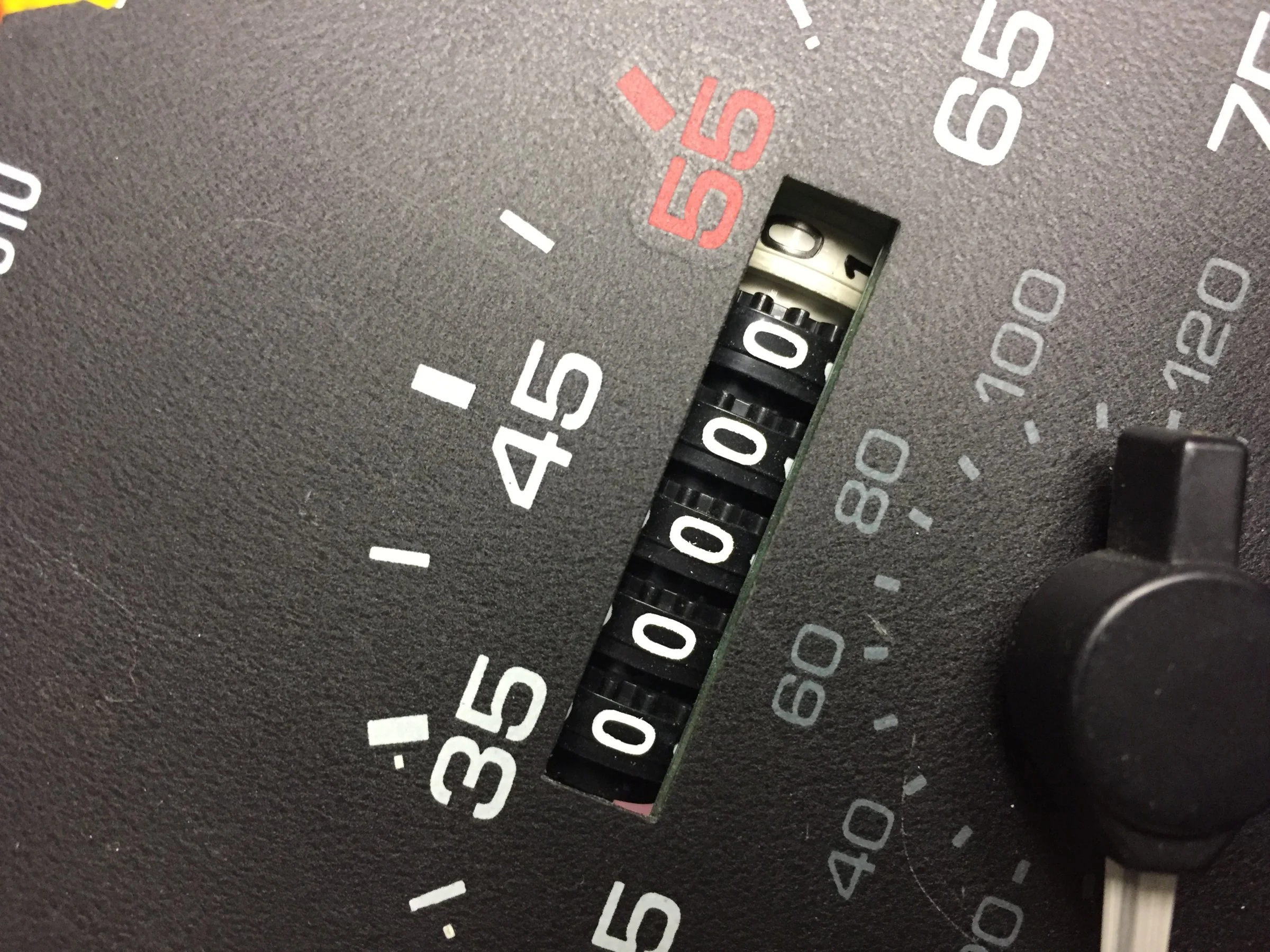

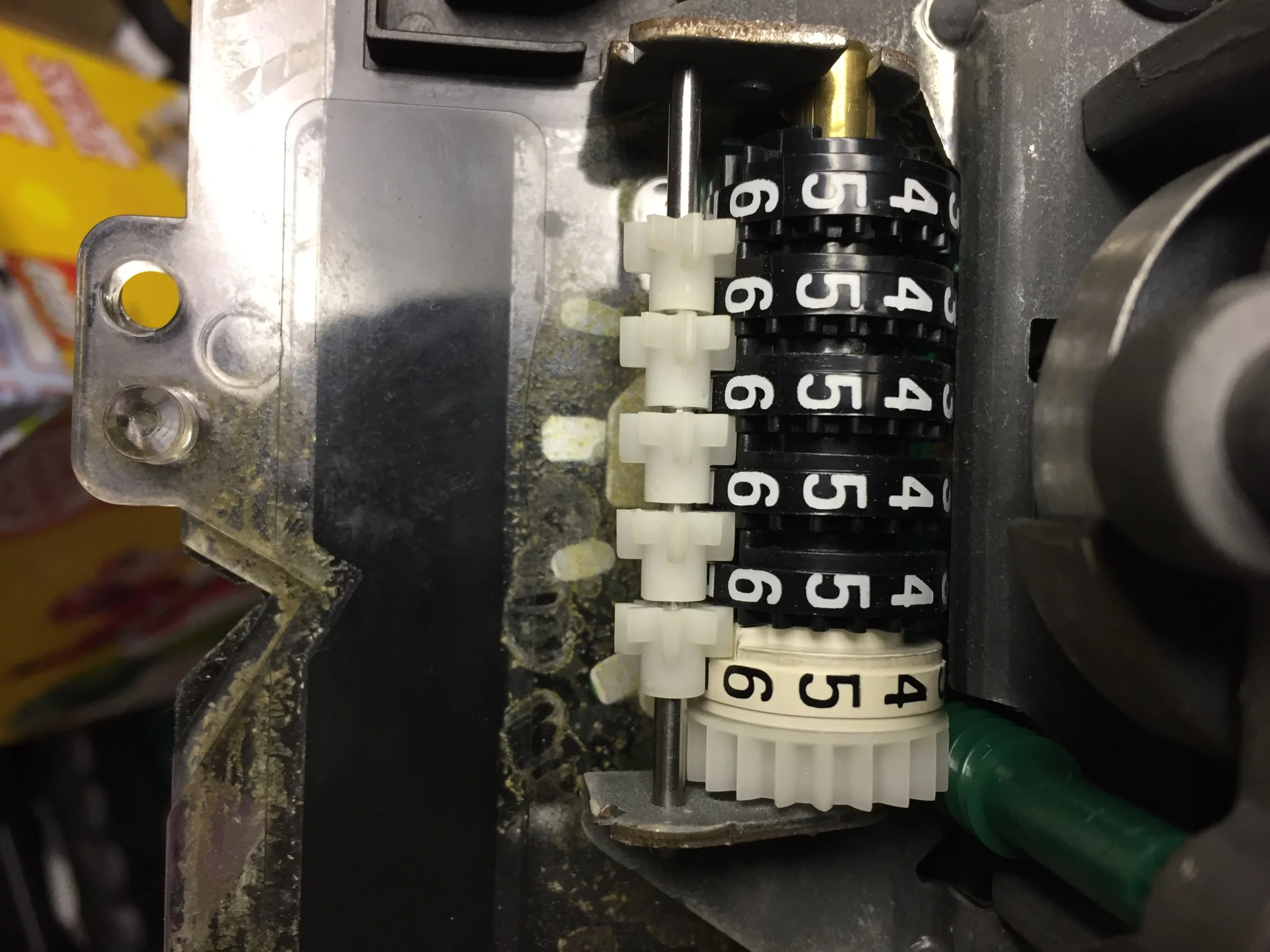

Odometer recal is easy.
See the rod the white idler teeth ride on?
Basically tap it loose from one end, spin the odometer wheels to desired miles, and the reset the white wheels and tap the bar back in
Look, a 0 mile speedometer. Bet you never saw that before.
Honestly, its so easy it's scary.
