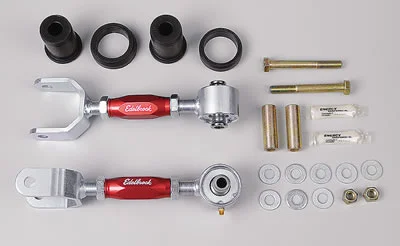

I have Maximum Motorsports lowers and just recently installed Edelbrock adjustable uppers. The lowers have spherical bearings at the axle end and urethane bushings at the chassis end while on the uppers it's the reverse. With all 4 control arms able to allow the rear axle to pivot, there's virtually no bind and the car sticks to the road like glue during hard cornering without lifting an inside wheel.

No I sold the PB. Paul, I do not have dumby LCA's on the bottom, I have adj with spherical bearings. The uppers I am considering are also adjustable..I think with the bearings too.
"I have Maximum Motorsports lowers and just recently installed Edelbrock adjustable uppers. The lowers have spherical bearings at the axle end and urethane bushings at the chassis end while on the uppers it's the reverse. With all 4 control arms able to allow the rear axle to pivot, there's virtually no bind and the car sticks to the road like glue during hard cornering without lifting an inside wheel." Thanks Bullet.

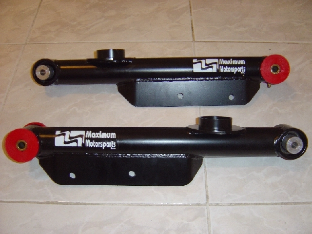

The Maximum Motorsports lowers work great also they are not a 2 piece so they don't bind either, they just don't make uppers.

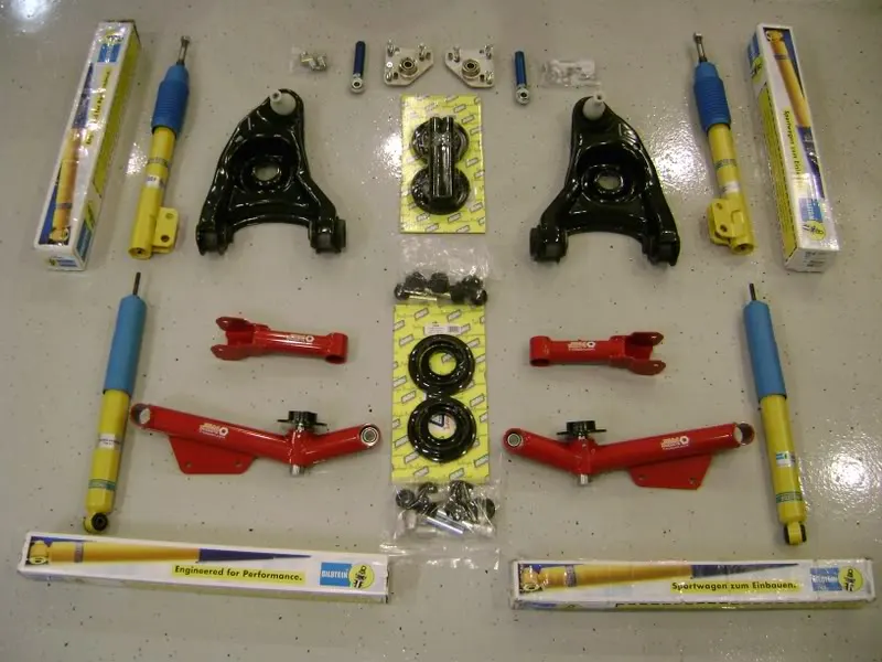

I put in new Ford bushings on the axle end for the uppers using a MM bushing replacement tool, Ford sells a kit with the 2 axle bushings and a bottle of friction modifier, it's cheaper than buying the 2 bushings seperate? Go figure? I also didn't want spherical bushings on the chassis side because I wanted a good ride and didn't want to take the chance of more harshness.
With the Bilstein HD's this thing rides awesome.
Here is a pic of what I put on, reusing the Saleen springs.

Good info Kurt. My main concern with those MM's is binding tho. My car is lowered AND has adj lowers on it - so that means the tradgectory is off. I think I am going with the adj uppers.
