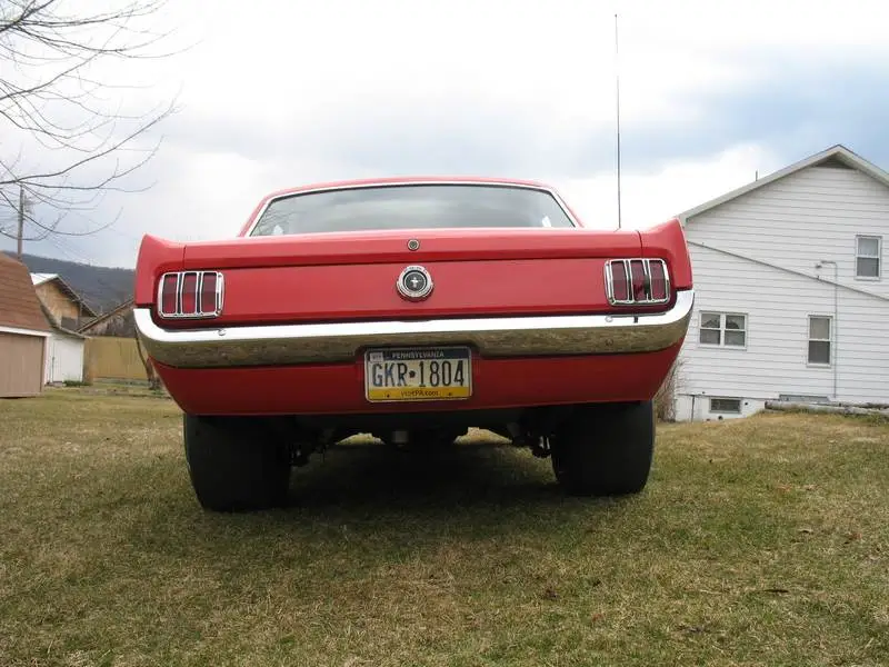

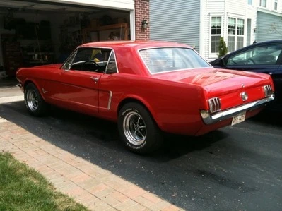

I just installed my narrowed 9" this week. I now fit 245/60/15's on 15x8 magnum 500's. Very tight fit though. It's a measure 20 times cut once situation. You wanna get it juuuuust right.
For mine which was way over stock to begin with (so I had no choice but to shorten it) I took it a half inch short than stock on each side, which gives you and overall length of 56.25 inchs. I can't imagine going any shorter than that, I now have about .75" clearance from tire to leaf spring, and I may still need to roll the fender edge just a tad, but we'll find that out once I get her back on the road.
The real issue with fitment comes from the front portion of the wheel well, it gets very narrow up there, and the inside body joint tends to flare out towards the tire a bit. But that can be persuaded with a hammer and a gentle touch to roll that in towards the center of the car.

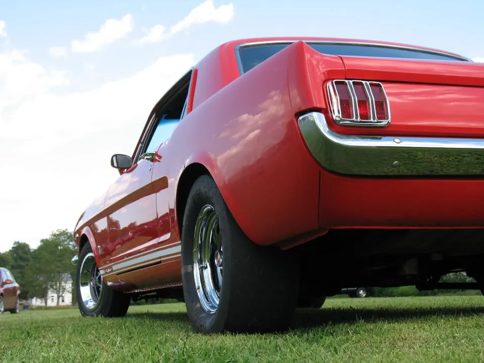

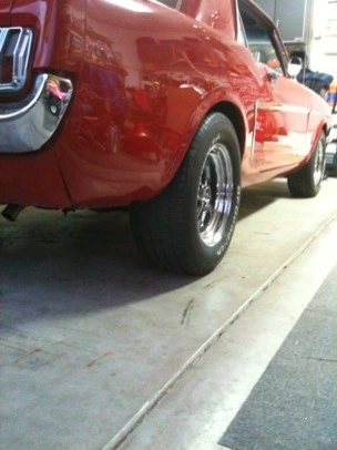

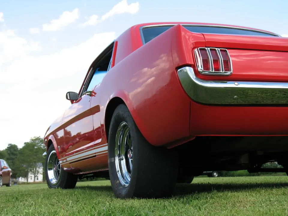

Getting the measurements just right makes all the difference in the world. Finished it up today and snapped some pics
Nice Tony. :nice: I Love Rangoon red and the Magnums too!

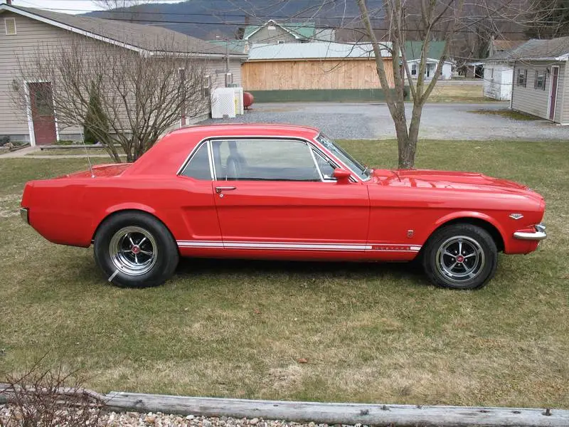

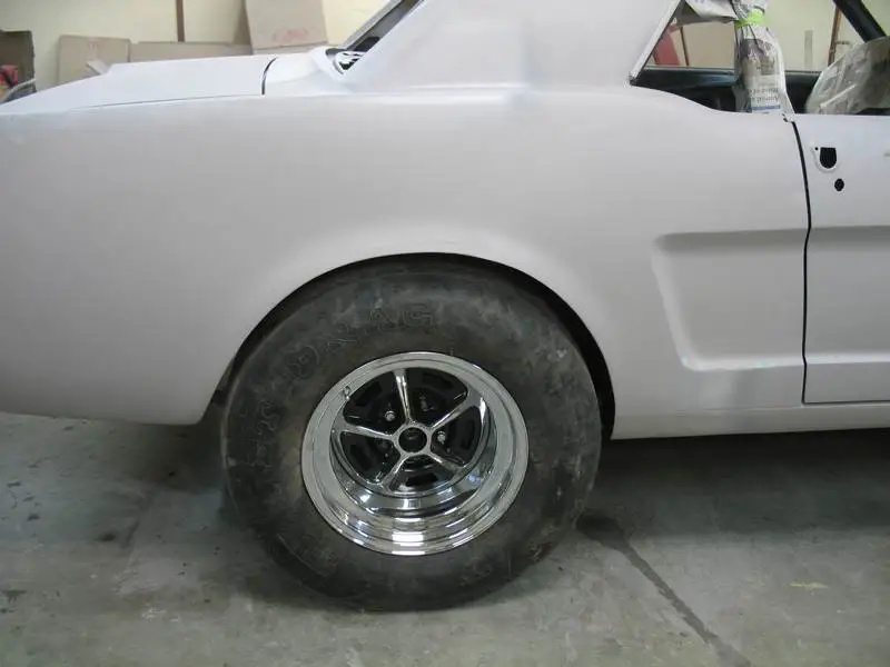

Thought I'd show a similar pic of my car with 26x10's on 15"x 8" 4.5 bs wheels:

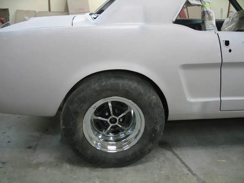

The rear has been narrowed, the car was minitubbed, the leafs were moved in 3", and the frame/front of the outer wheel well was notched at the rear for future expansion--28 x10's on 10" wide Magnums with 5.5bs.
Sneak peak of the 28's:

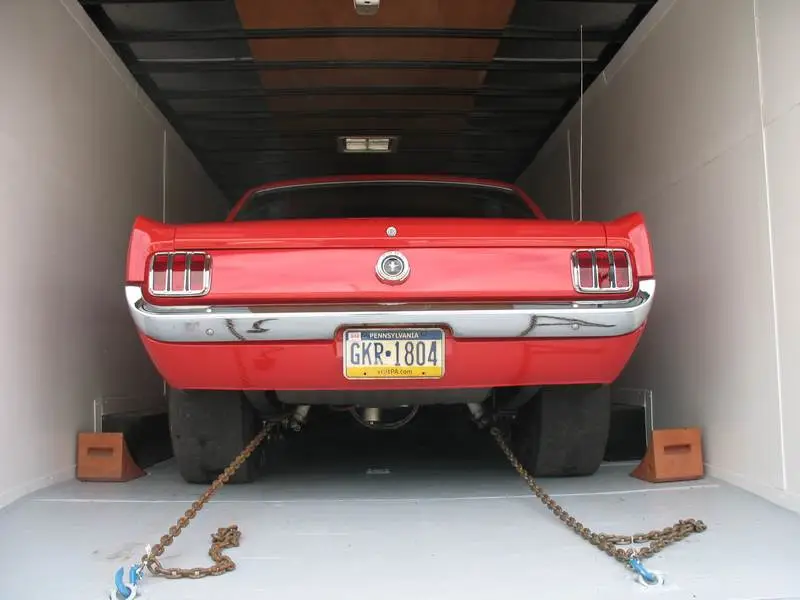

Local guy did this on his car, I think he took it too far IMO but Ill snap some pictures if he has it at the strip. I'm guessing its gotta be only 2.5-3" of BS on the wheels but its also a mini tub deal with relocated leafs with at least 10 or 12 wheels. Just kinda looks odd.
How much is it narrowed and how much room did the mini tub kit give you?
