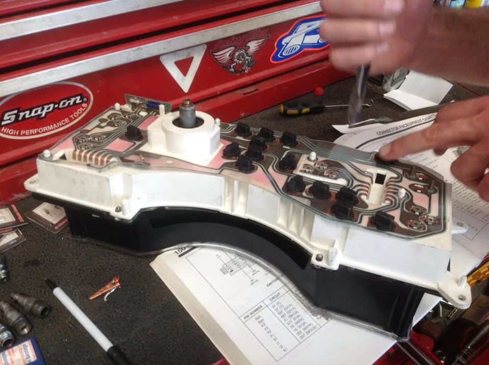

Lastly, we apparently fix 25 year old instrument panels too. Our tech Jay seems to really like figuring out electrical issues (I know, its odd).

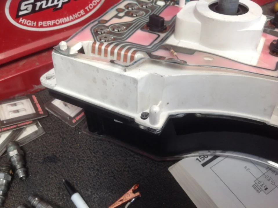

The printed circuit was raised up in many places. That had to be fixed with solder and glue.
The worst area was this raised up plug in port. If you look at the middle copper strip it is shorter than the others. That's because it had broken off at some point in time. That area was most likely causing all the problems. Jay fixed it by soldering in some strips of speaker wire (in a flat arrangement). The panel now works like new!

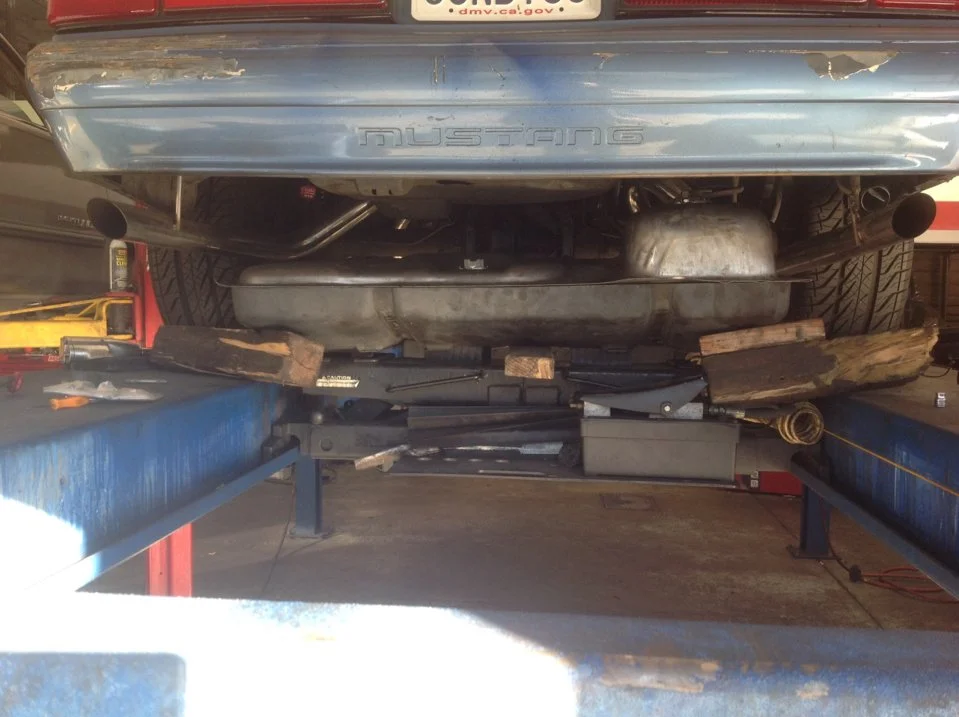

We got the A/C working! Also, when the gas tank was full I noticed that there was a raw gas smell in the cabin. So, we pulled the tank and resealed everything which took care of the issue.
