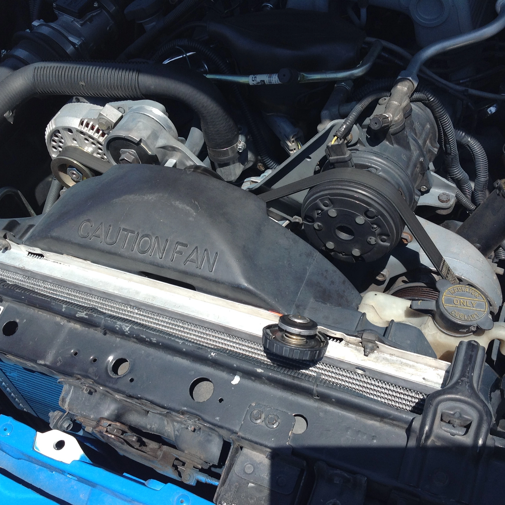

I recently observed, that with brutal temps (i.e., 105*), that my radiator could not keep up if I had to idle in traffic with the A/C on. So, I ordered a replacement unit from LMR.com. I got their SVE 3 row unit. Several guys gave me great alternatives, but I had already ordered the unit. While it's a no brainer to R&R the radiator I will still post some pics and notes in case someone needs the help.
Old radiator set-up (stock replacement single core & old overflow)

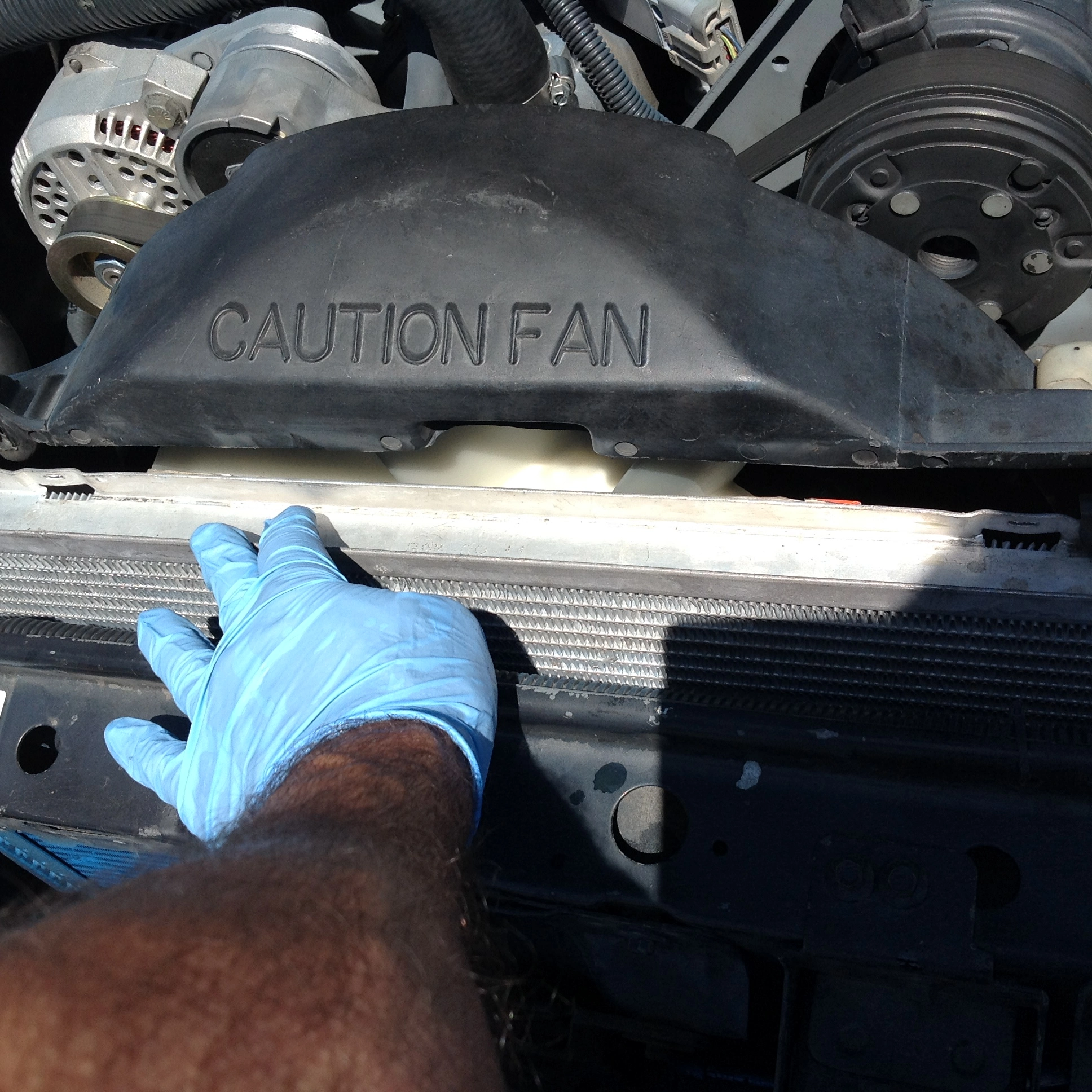

Stock stuff loosened (e.g., radiator hold downs, fan shroud bolts, overflow tube, upper/lower hoses). You can just push stuff out of the way and pull the old unit out.

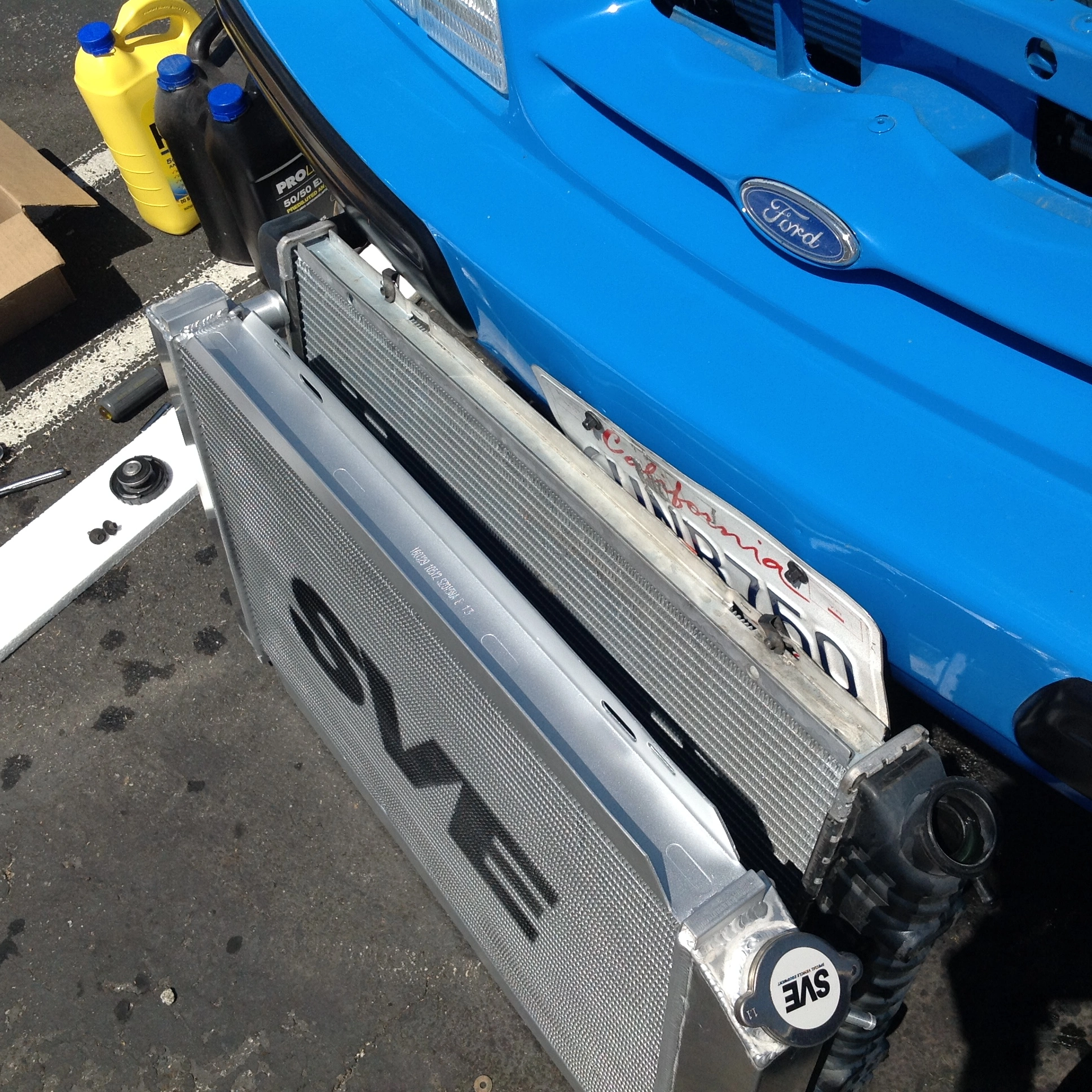

Side by Side:

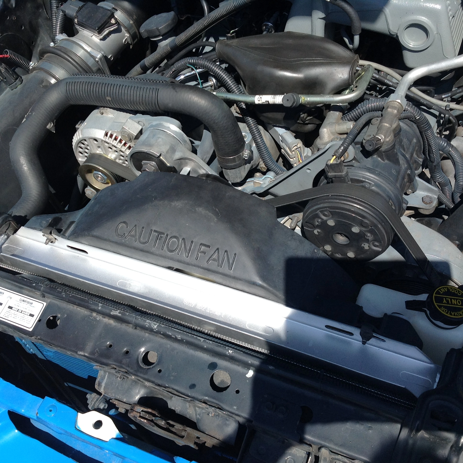

New radiator and overflow installed. I just transferred the mounting tabs from the stock radiator to the replacement radiator, then tightened all hoses and bolts, and hooked the overflow tube up.

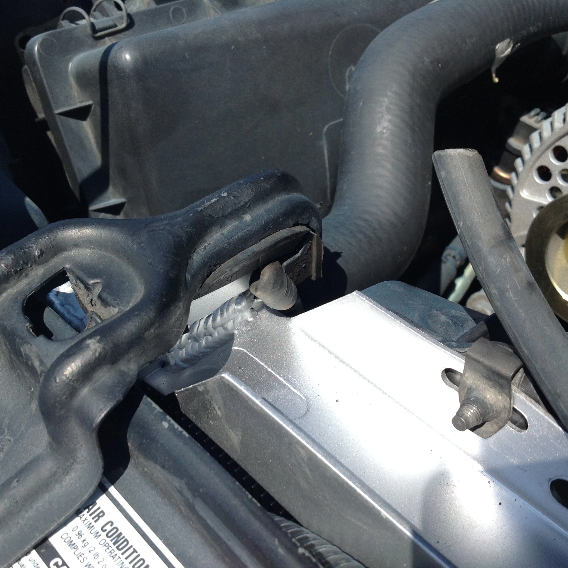

As I was informed on this site by a couple of members the SVE radiator does not fit 100%. It was a bit loose at the hold down (passenger side). It had about 1/4" - 3/8" play. This was unacceptable to me so for now I simply cut some hose, folded it in half, stuffed it between the hold down and radiator, then tightened it all up. It actually works really well and its not too noticable. The shroud fit fine after I played with it a bit. Interestingly, this radiator fit my '95 like a glove.
In order to make sure there were no air pockets in the system I parked the car so that the nose was on a slight incline. Then, I started the car with rad cap off, selected "vent" on the hvac controls along with high heat, and full fan speed. Those selections will open up the heater core so that no air pockets hide in it. Previously, I had drilled a small hole in the thermostat at the 12 o'clock position to help bleed the system in the future.
Next, I simply let the car idle until about half way on the temp gauge. At this point the thermostat was taking too long to open so I revved the car a bit. The stat opened and I filled the radiator with 50/50. I did this process twice more to make sure the system was full, filled the overflow to the "Hot" level, closed everything up and called it a day. I'll road test tomorrow. If it overheats for some strange reason I'll. BE. BACK!

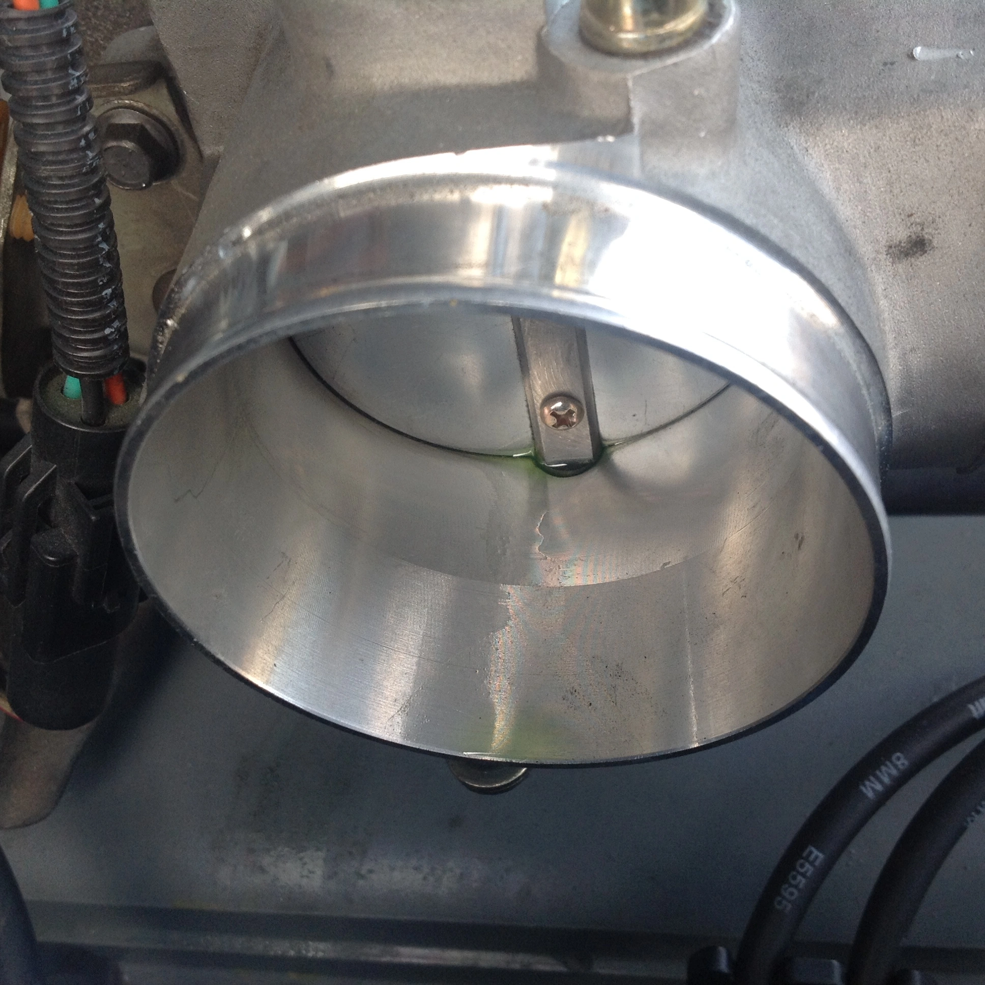

I'm not sure why the TB is leaking. I cleaned the TB and intake surfaces really well and used acetone as well. I didn't torque the bolts because torquing on aluminum surfaces like that can easily strip something. I hope no anti-freeze went into the intake/combustion chamber. This car refuses to see road duty.

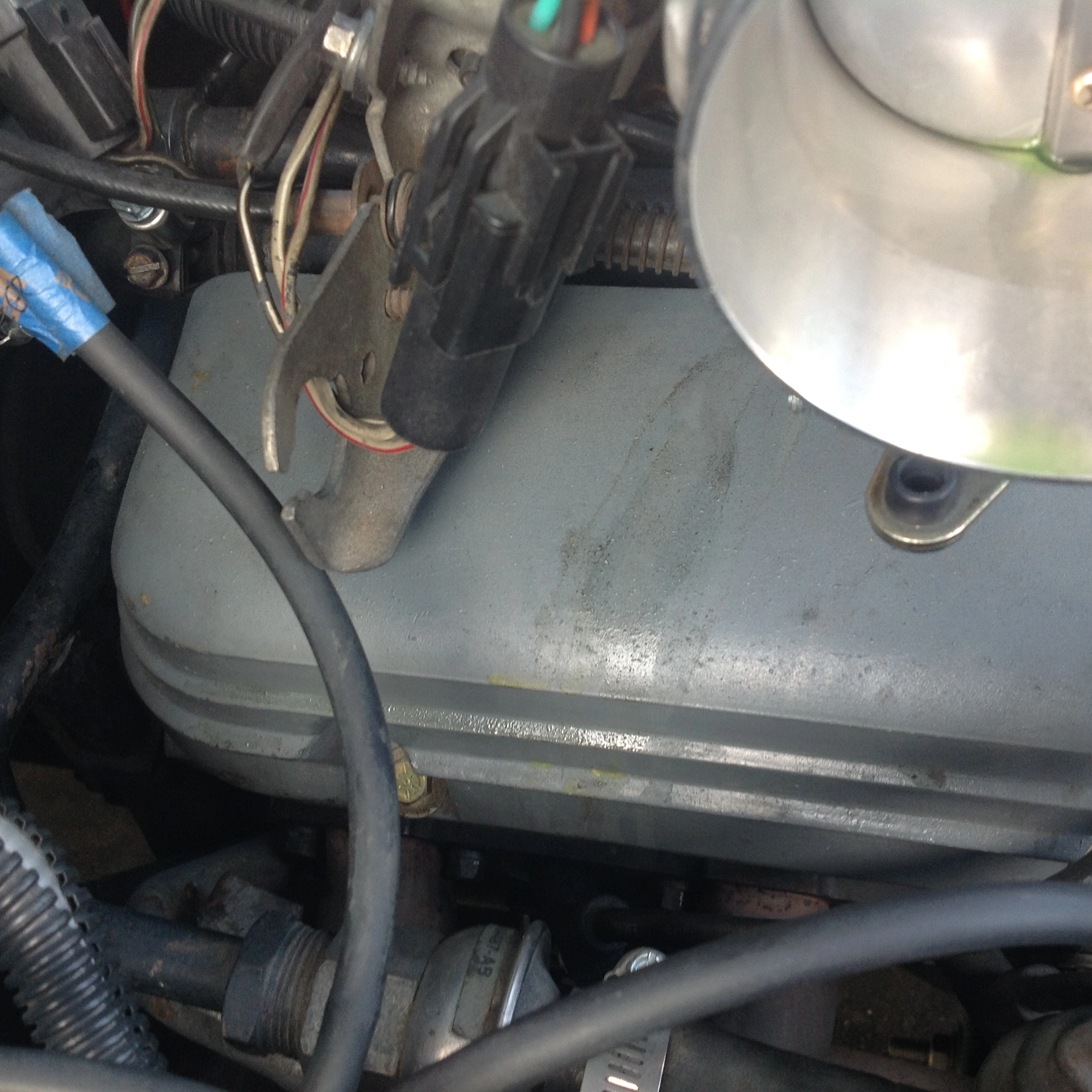

Leak which had formed on the valve cover beneath the air intake tubing, sneaky...

The main issue with the crazy idle and stalling seemed to be the coolant leak from the EGR spacer. If coolant is leaking out then so is vac (from this location). The cause of the leak was either a gasket that had the wrong orientation or a microcrack in the spacer itself, not sure.
