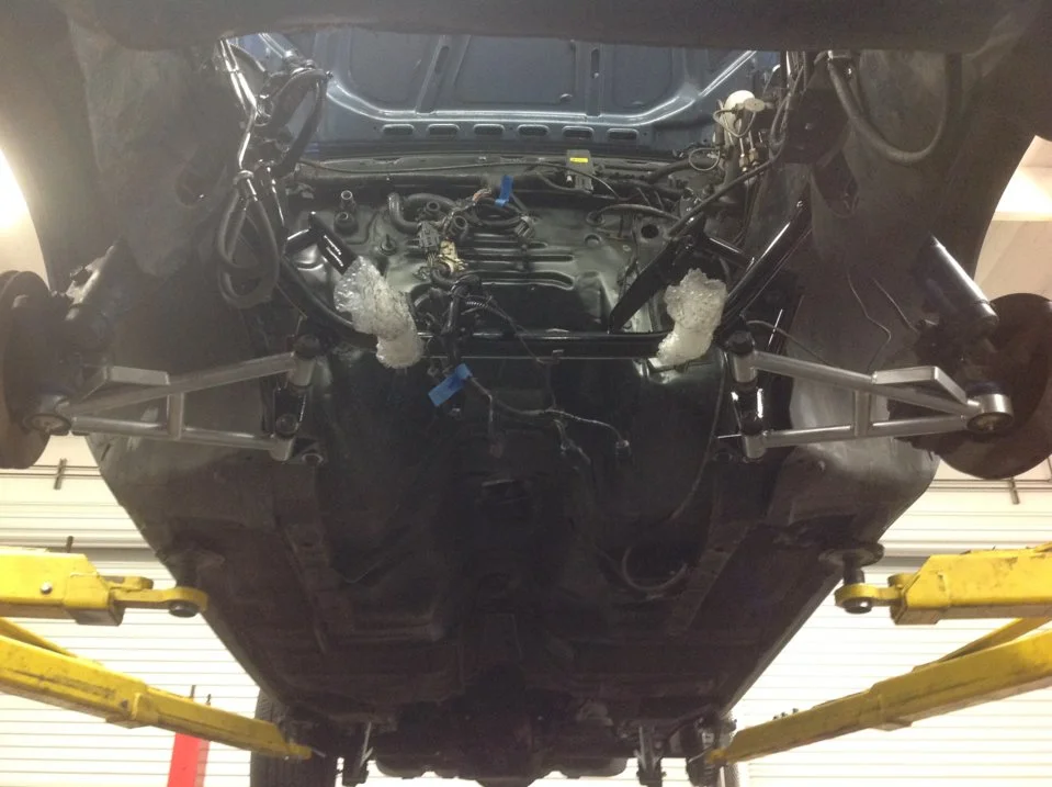

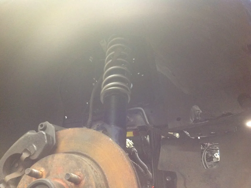

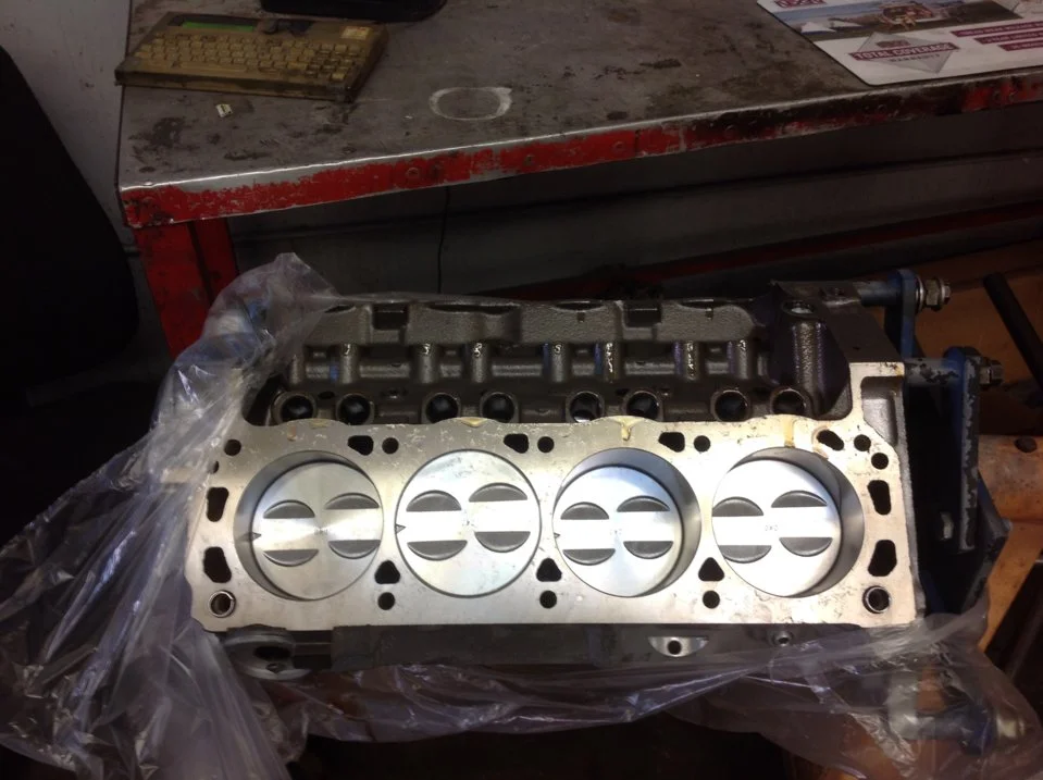

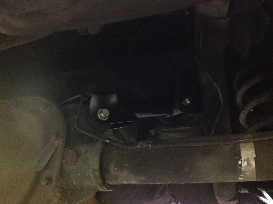

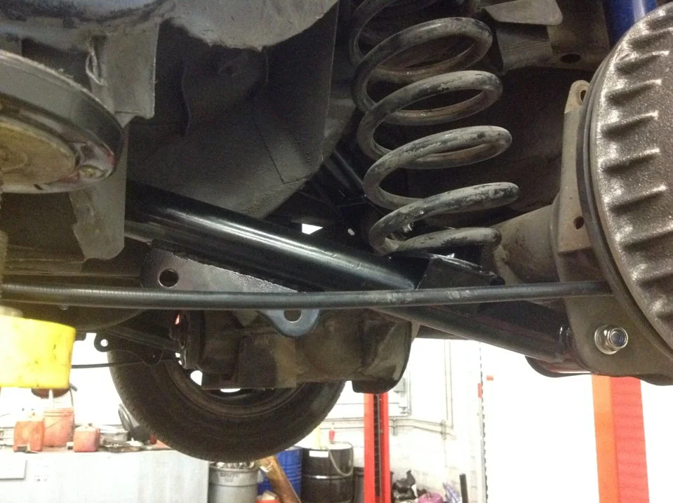

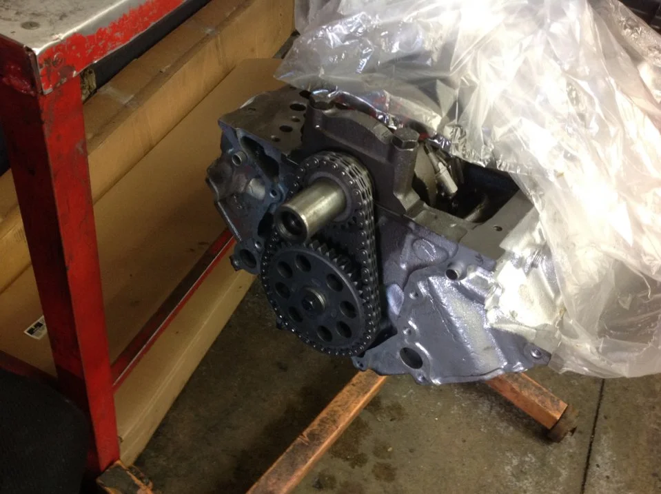

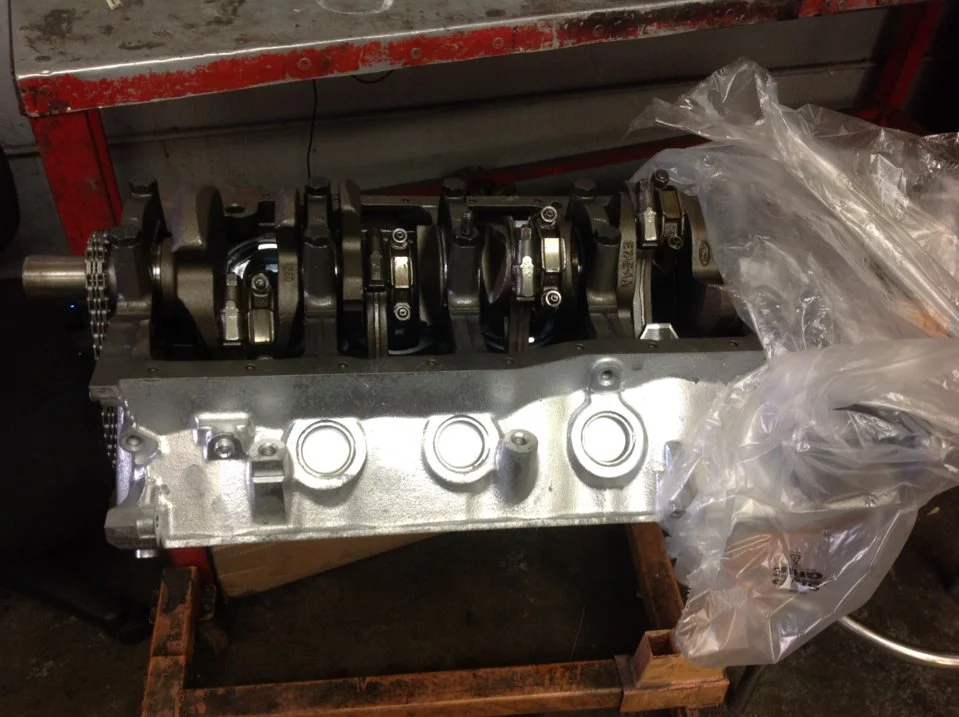

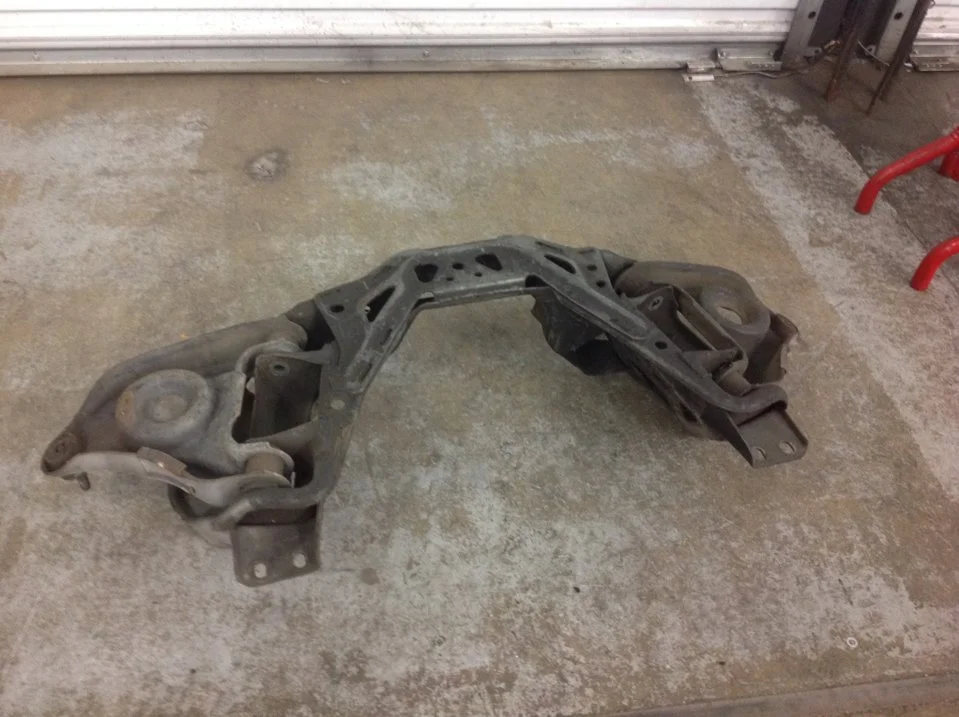

UPDATE: The Build is On!
Boxes of goodies, new short block, new K-member kit in, old K-member out, rear control arms in.
More to come...
Reactions: FoxMustangLvr and A5literMan

Very nice progress already. Did you install any torque box reinforcements before you installed those new LCA's?
