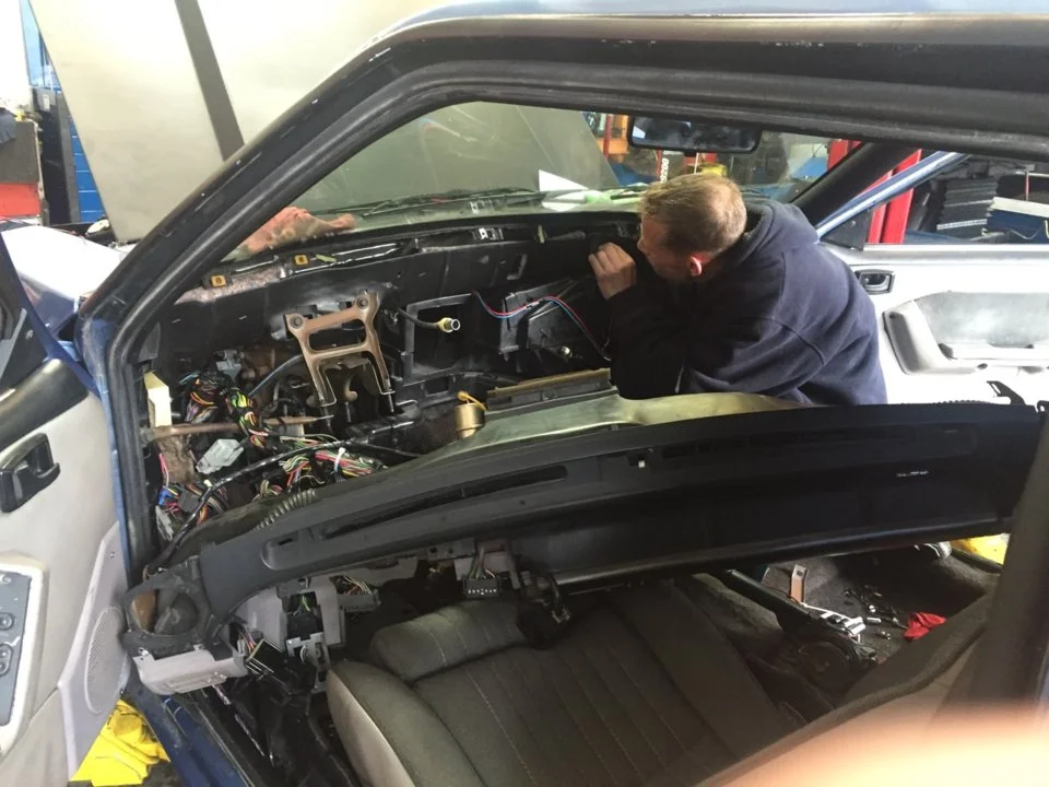

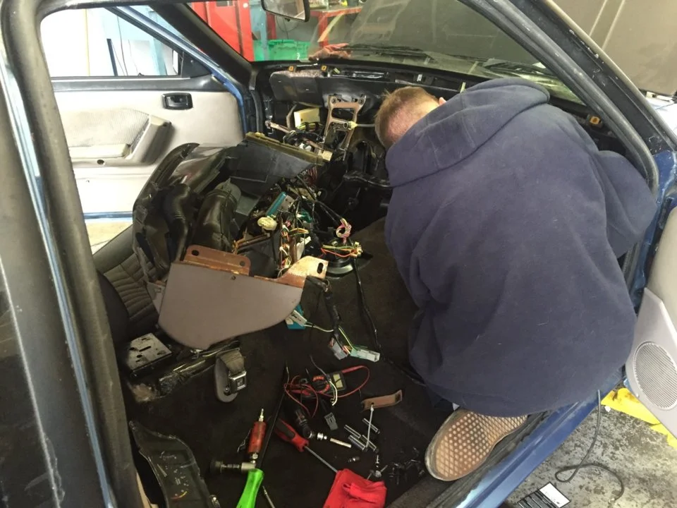

Whomever worked on this car before I purchased it needs an aware...for BIGGEST hack ever. For some reason they found it necessary to go under the dash, remove wires, break things, and plug connectors into the wrong places. Basically they hacked the interior harness to death. What were they doing under the dash?!
Whoever you are, my tech would like to meet you one day soon and thank you for filling his days with the following...

Well at least the heater core is replaced, the blower motor works again, and the HVAC controls aren't frozen anymore.

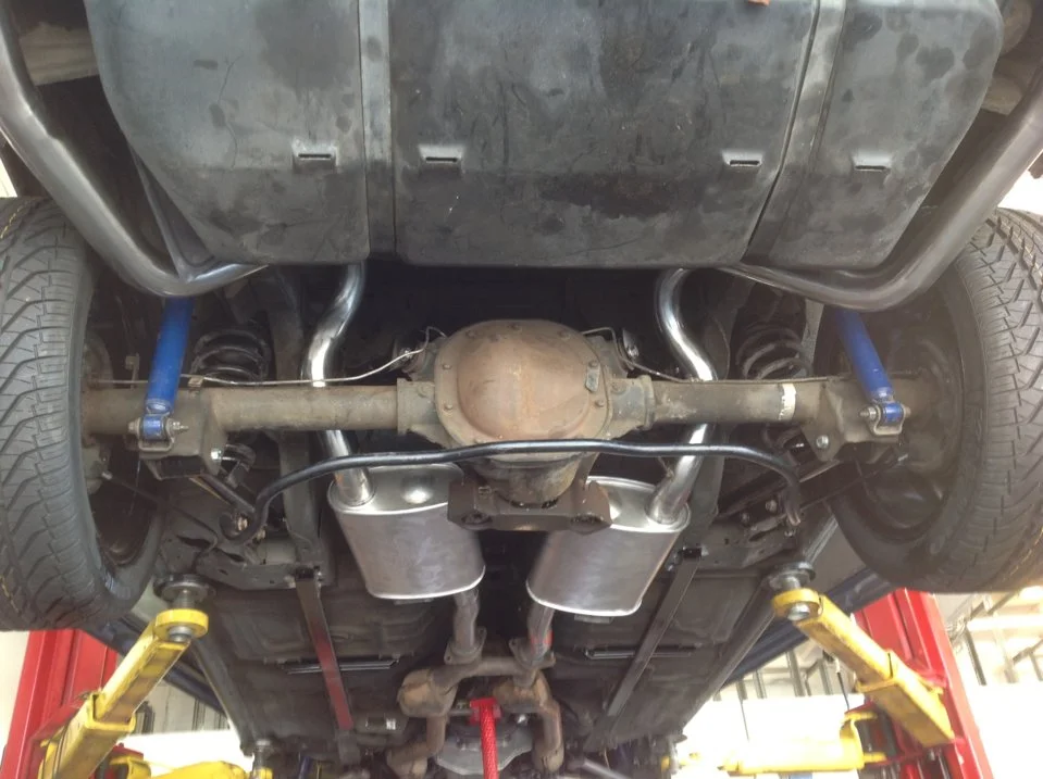

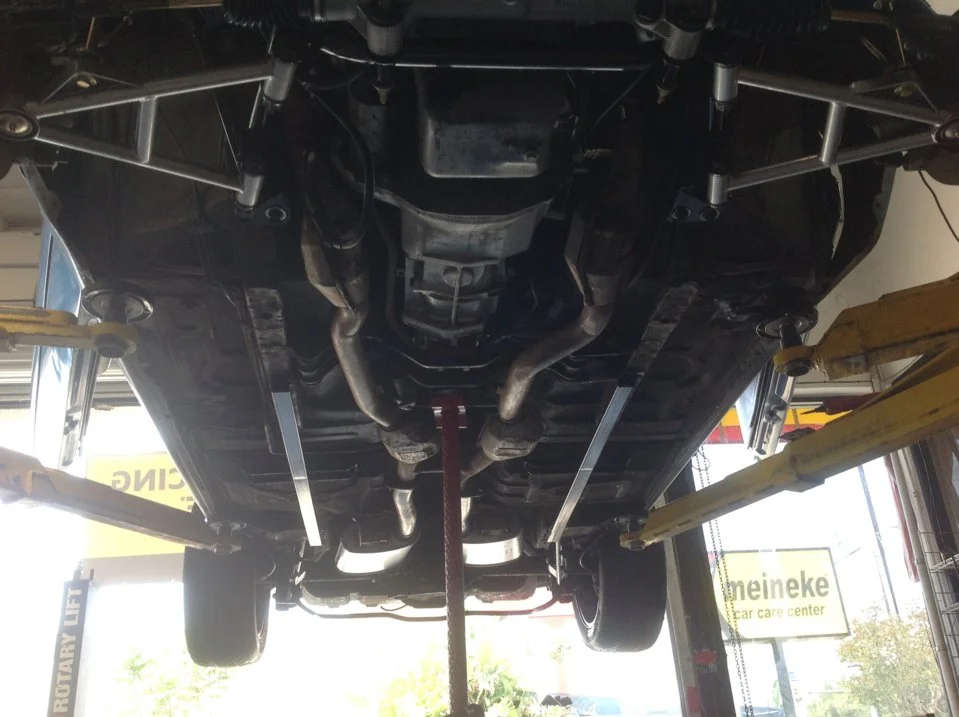

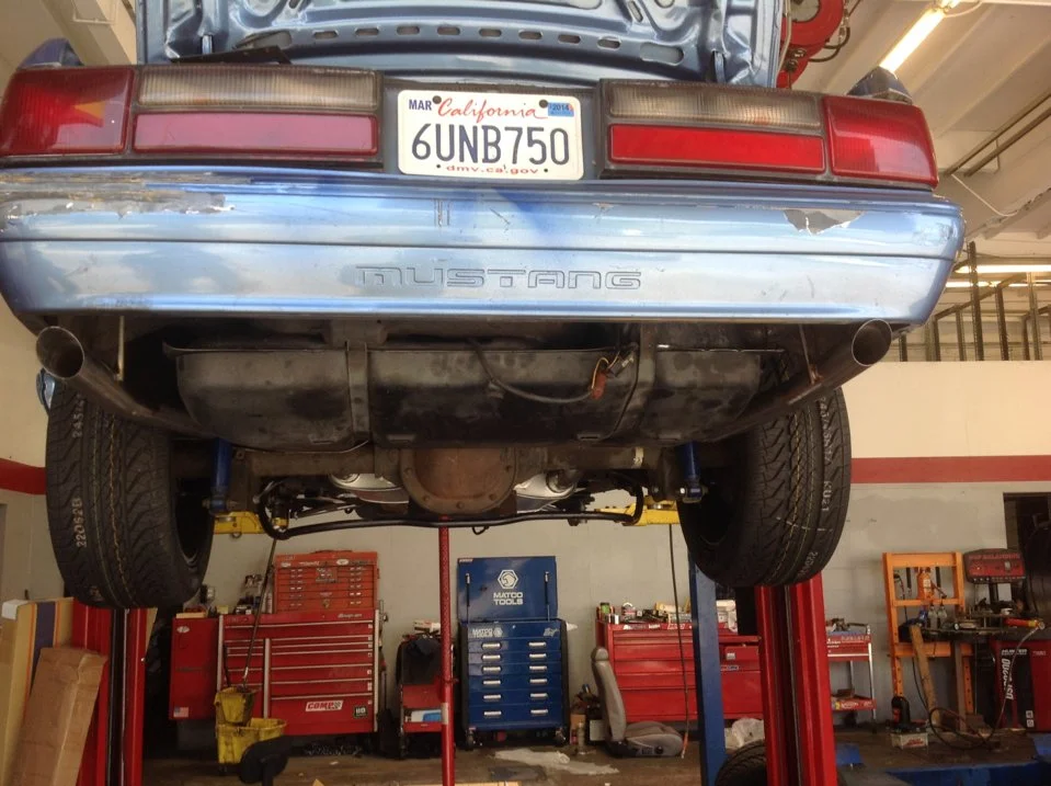

Then we got the exhaust system installed:
