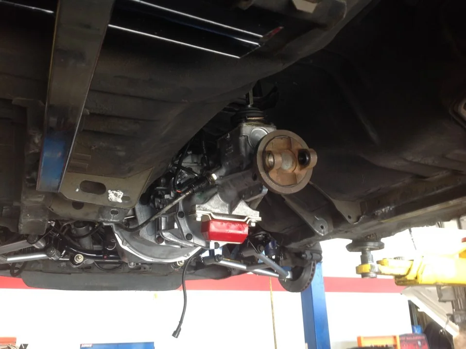

Yes, yes, pics or no go. The shop has been nuts. I managed to snap one of the rebuilt trans back in the car...

Update: This car has been quite the challenge. After the 1st start up attempt it was observed that the T5 was basically a box of rocks. It got rebuilt. Then, after the 2nd start up attempt it was observed that one or more of the fuel injectors were stuck open. Raw fuel was gushing out of the tail pipe. So, the new injectors arrived (Accel 24lb units):
We repaired the car's many wiring & vacuum woes enough to achieve start up & break-in. Once these new units are installed we will do just that. Afterward, we will see what other accessories, etc still have wiring concerns and take it from there. Considering that the budget has been blown sky-high the car may need to retain its jacked up paint job for awhile.
This may be the most mechanically sound ugly Fox on the road! It's practically a 2015 1990 Notch at this point.

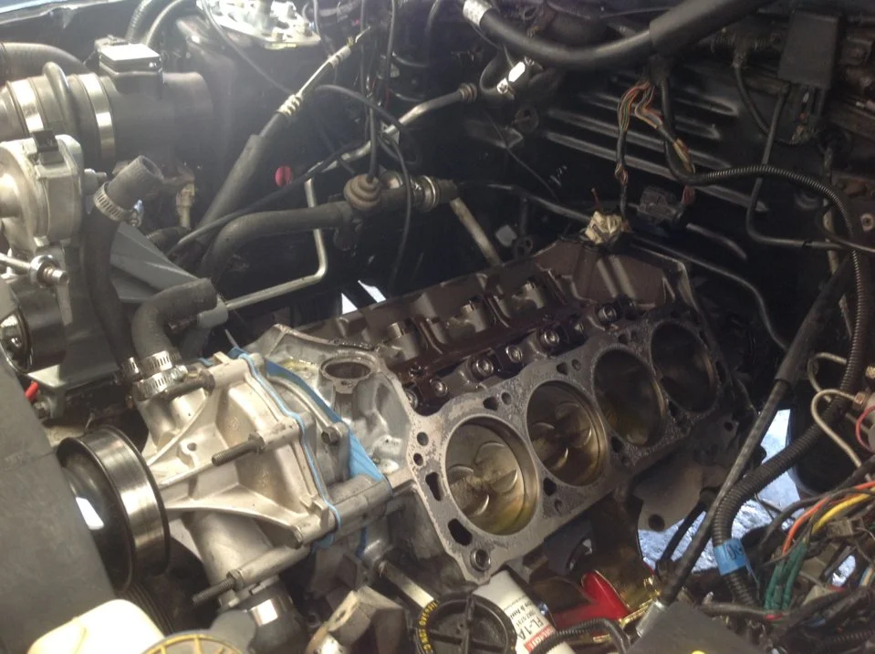

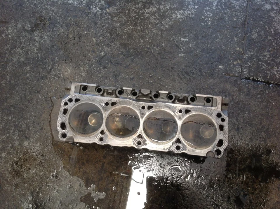

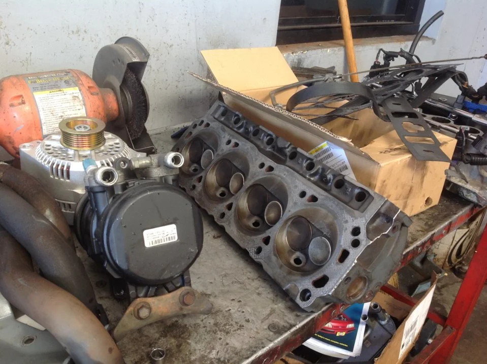

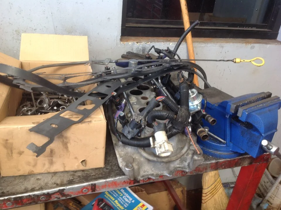

Update: 1st start up attempt #3. The 1st attempt ended in the issue of a bad T5, the 2nd attempt with a bad injector, this 3rd attempt ended with a hairline crack in the upper manifold and poor head work from the machine shop. The cylinder heads were obviously not pressure tested because some of the int valves were not seating all the way (determined by a leak down test). Also, the ports were not matched per our instructions to the lower manifold.
The heart aching pics of ANOTHER tear down are below. In the interest of time we have ordered a set of Ford "X" aluminum heads. They are the versions with 58cc combustion chambers. They are the heads I wanted in the 1st place, but budget was also in mind. We will still get the ported E7TE heads made right though. Once they are right & pressure tested I'll sell them. They will be set up like those from TMoss.
Annnnd start all over again...
One of the unfinished heads...
some more heart break...
Note the small crack inside the runner on the upper right. Thankfully Midwest Mustang is sending us a replacement due to the amount of business we have done with them in the past.
This is a simple "pressure test." The head is upside down, cc chambers filled with water, then wait to see if gravity causes any water loss. You can see the difference in water levels from left to right. The left chamber remained full after about 10 minutes. The other 3 have varying degrees of leakage. If this happens due only to gravity imagine what happens under operating conditions.
Lord willing, next up will be picks of a re-assembled long block sporting some X heads.
As a side note the addition of aluminum heads will bring this car's pre-fluid weight to 2895lbs. Beginning shipping weight claimed by Ford was 3035 w/o fluids, -64lbs tube K-member Chrome Molly A-Arms & coil overs, -6lbs quad shocks, -20lbs hood, -50lbs heads = 2895lbs.

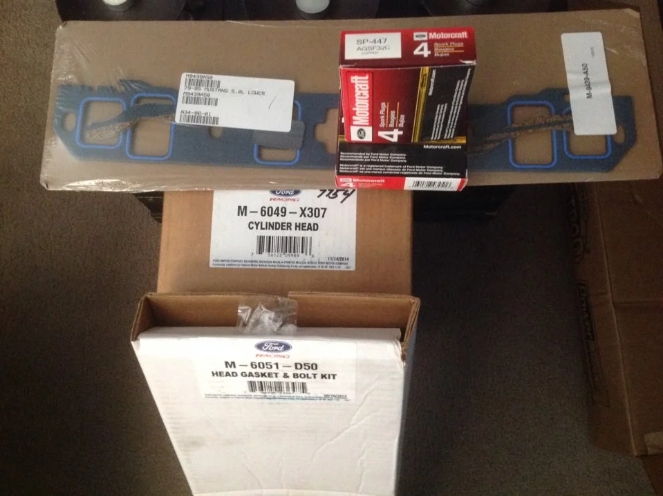

UPDATE:
Another week down, but the new parts have arrived. Lord willing we will get things back together this week. The pic serves 2 purposes: 1) so ppl don't roast me over no pic =), and 2) to show the entire kit Ford recommends for these X307 heads. I guess this means my brand new ARP head bolts will go up for sale!
In review: the build, engine wise, will consist of a 308cid block, stock camshaft (I've had enough cams in my life, want simple drivability, and its CA), 1.7RRs, FRPP X307 heads w/58cc combustion chambers for added compression), ported Explorer lower, and Explorer upper w/EGR provision. We went with the Explorer upper because out of all the Ford manifolds for this car, it flows the best & has the larger TB opening (cf., TMoss' article).
This car has lost 134lbs off the front end. Will I need a wheelie bar (lol)? Hopefully more pics to come soon.

joe, not a big fan of those print o seal intake gaskets. They leak like a strainer. I would get some 1250s or 1262s gaskets. but that is just me.
