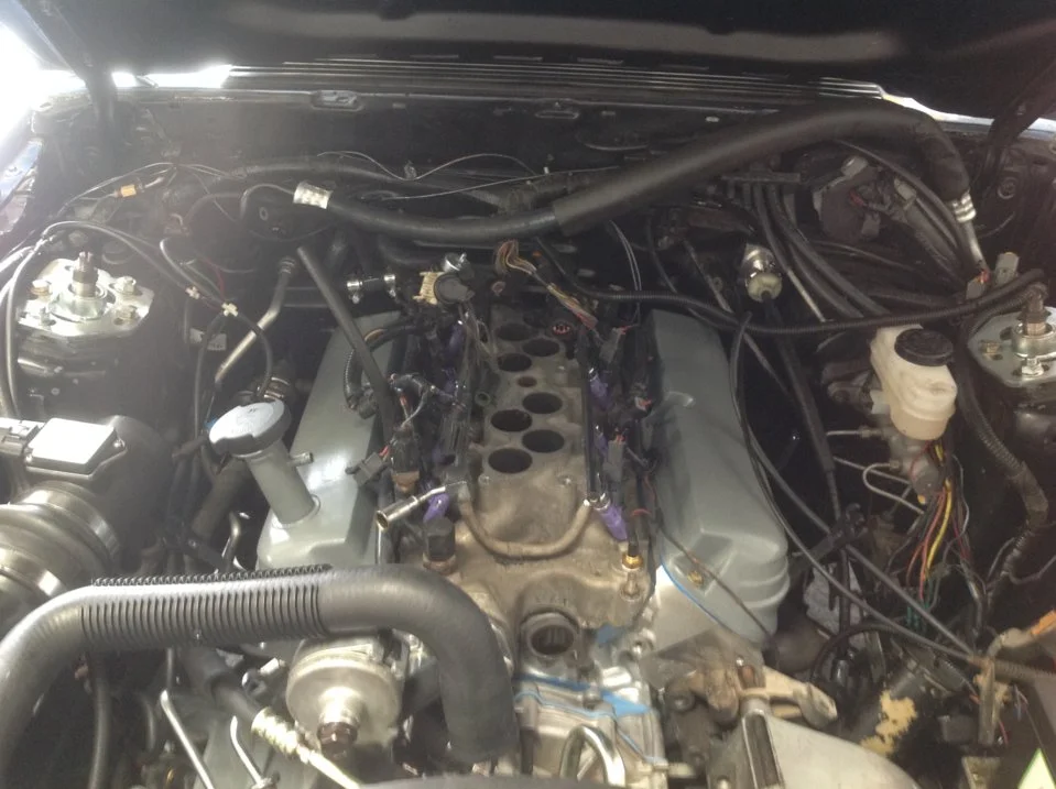

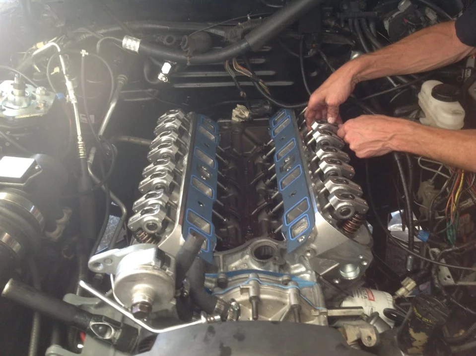

UPDATE: The new heads are going on!
I't won't be long before we have a fully operational Death Star.
(recap: GT40 X307 heads, Crane 1.7RRs, FRPP hardened push rods)

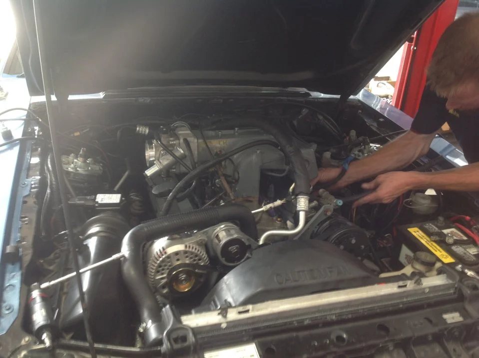

UPDATE: A Mystery for the Masses.
This car (i.e., Old Blue) has defied completion once again. This time it gave us a mystery problem. After much research and testing we figured out the problem, but for fun maybe you all would like to take a stab at it. It wouldn't cost y'all any valuable time or money like it did me. So, here goes:
For those of you keeping track this is the 4th time this car is going back together...

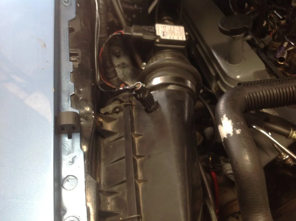

Took a little extra time to reroute the ACT Sensor where it belongs since I don't drive on the surface of Mars (i.e., intake runner #5).

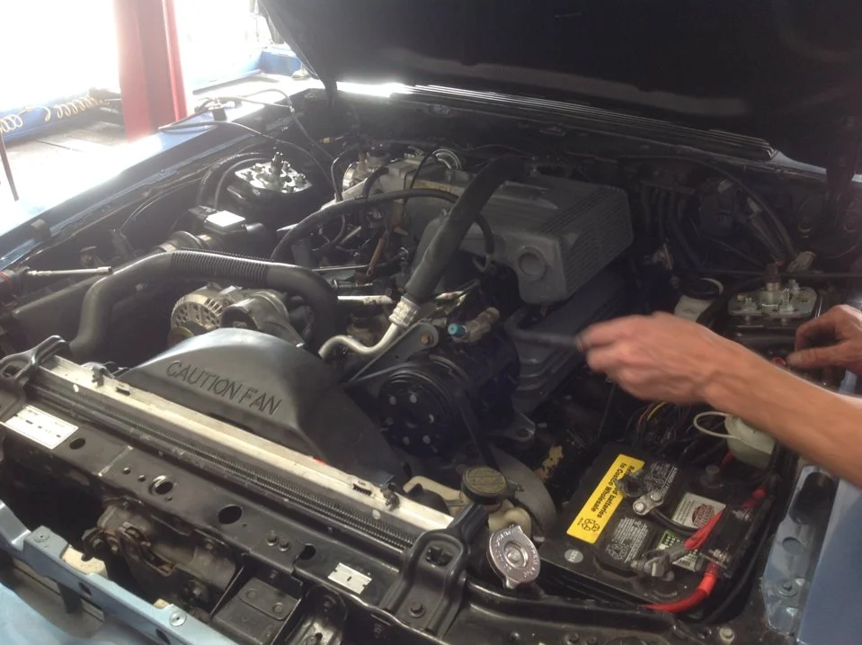

Our tech Mike has seen this stage before...3Xs before. He now hates Mustangs.
Just about ready for start up...AGAIN.
It was just after this point we tried starting the car, but it would not have it. Not even a little. The thing just cranked and cranked, but nadda.
