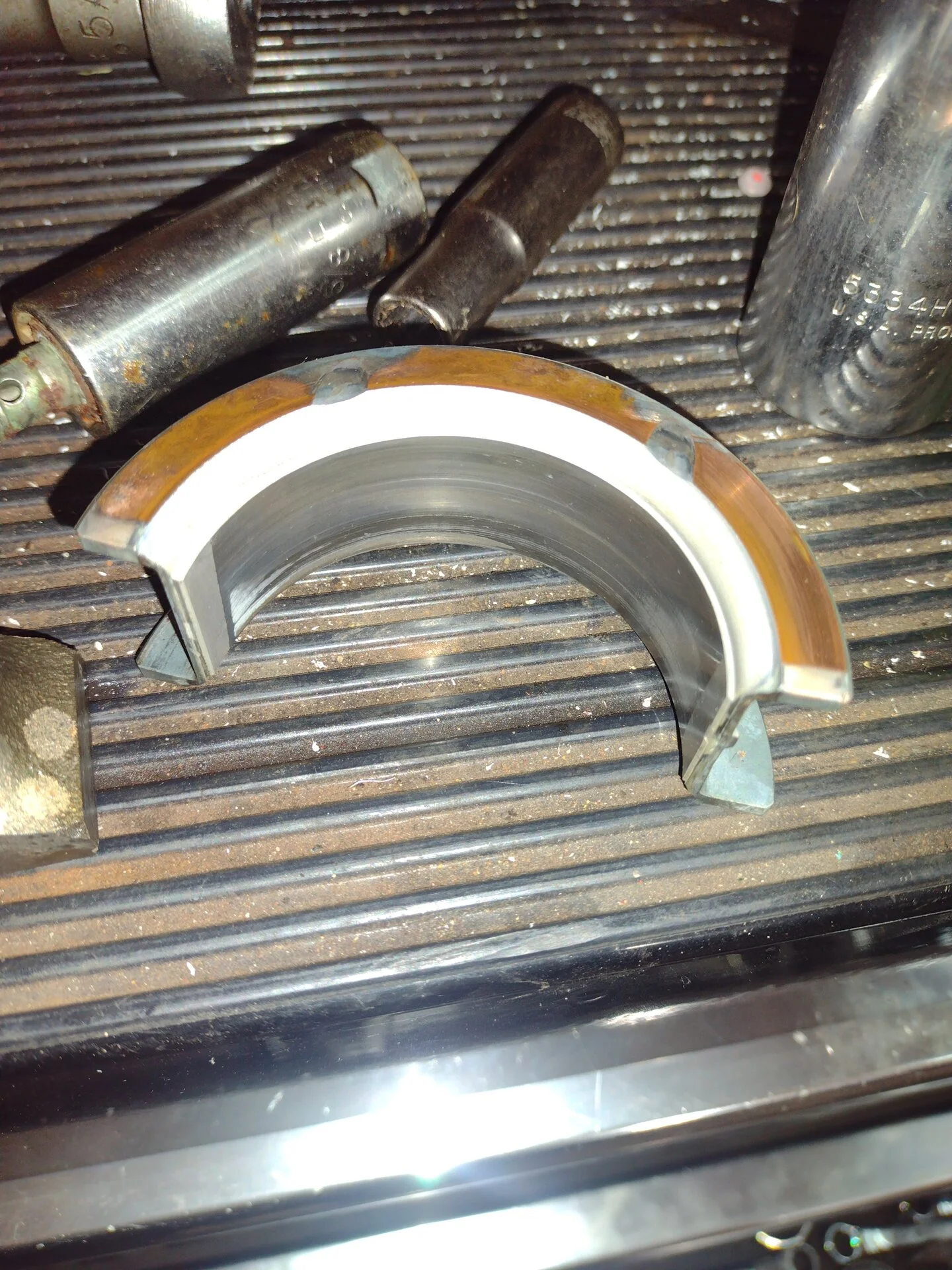

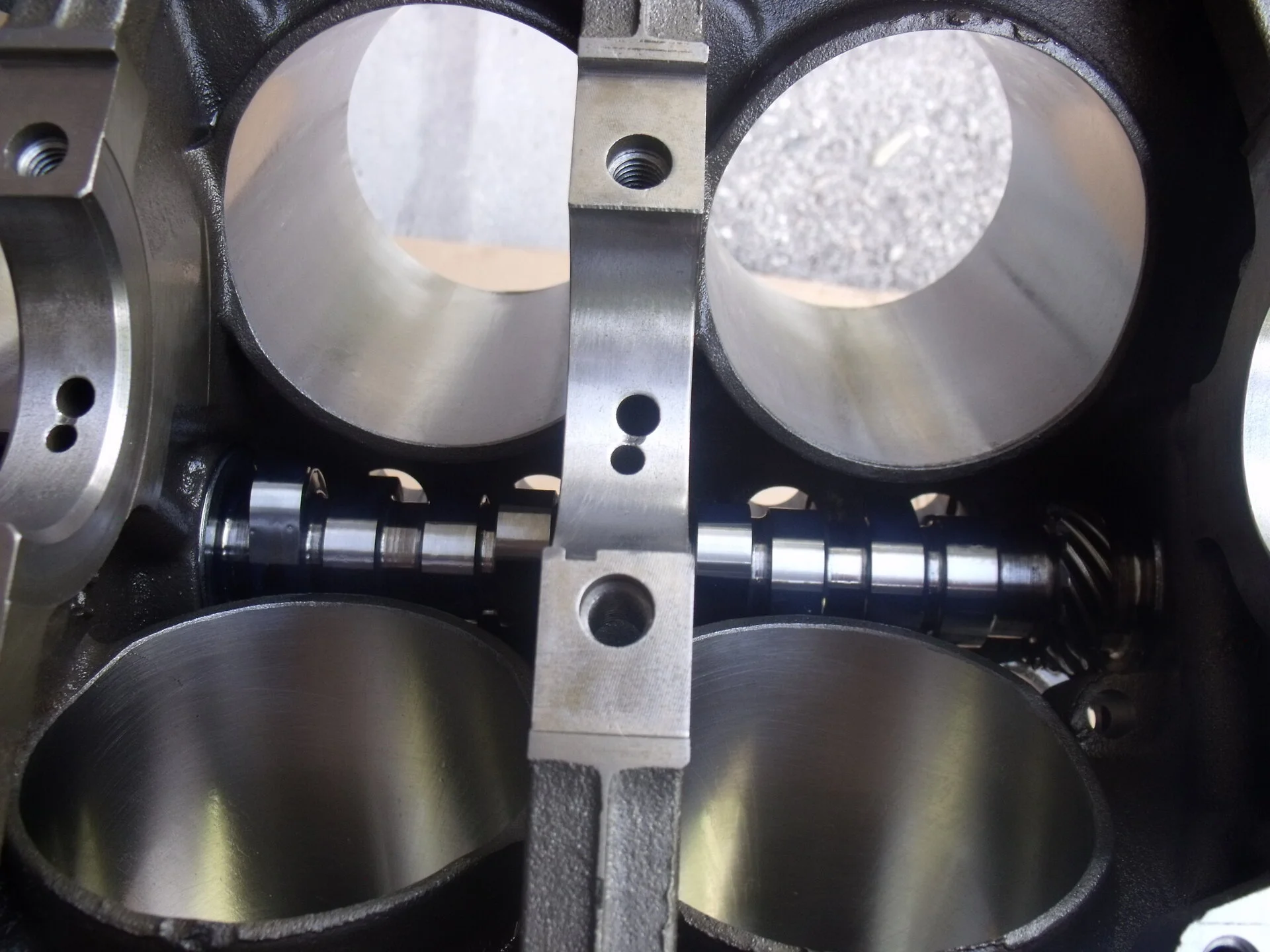

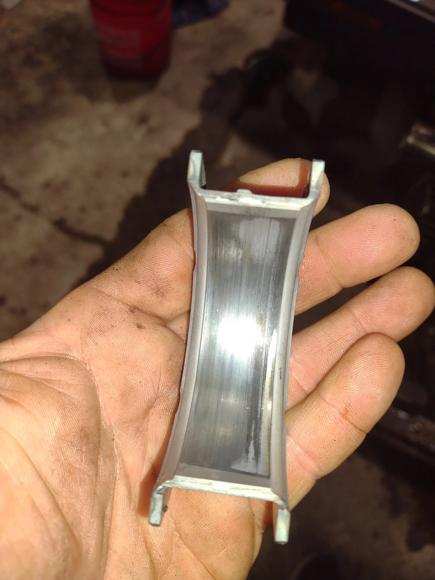

hello everyone, Took motor apart and worried about what I see on the middle crank bearing. Opinions welcomed, if I need a refresh I am screwed. The bores still have the machine markings and no ridge. Factory head gaskets and motor mounts to amazingly. Let me know what you think. The crank journal looks brand new.

Why are you tearing apart a 39k mile engine?
I'm with you here, I'm so lost. My stock 5.0 has 170k miles and I still bounce that thing off the rev limiter all day.
Unless you are just extremley bored I would have left the motor together, could do more damage putting it back together if you don't know what you're doing.
I would opted for just changing the seals and throwing in a used T-5 when you put it back together over a set of aluminum heads. Doesn't matter how "strong" or "weak" the AOD is, it's so sluggish, I'm not sure it's even possible to damage a stock 5.0 with that tranny.
