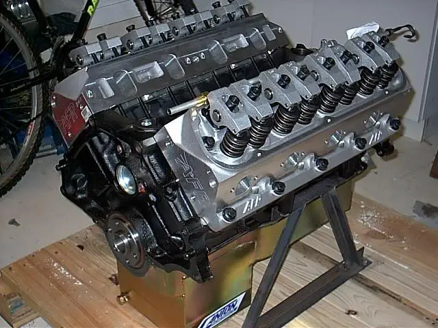

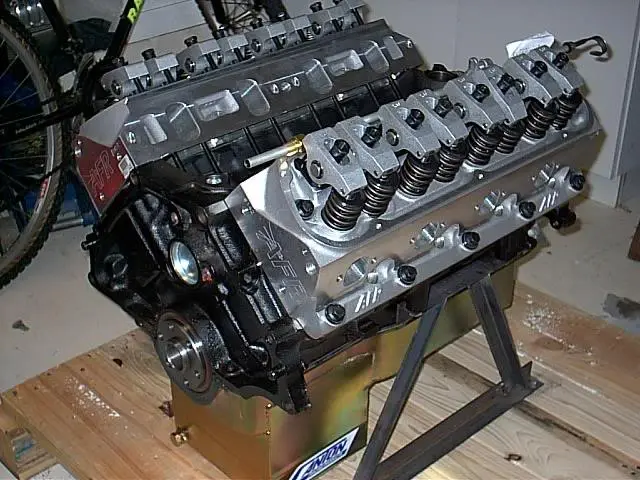

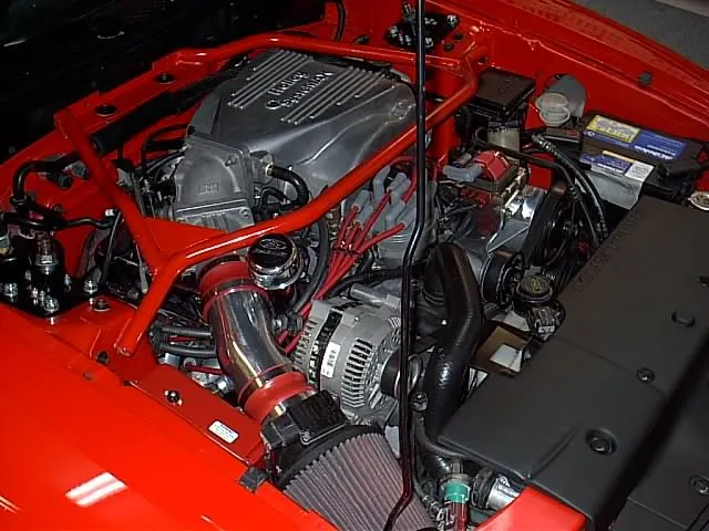

I pretty much bought the same crate 347 stroker you're thinking of buying. It made lots of torque. I didn't use anything off my 302 and suggest you don't either. I sold my Crower cam, Edelbrock RPM Intake, 24lb injectors, 1-5/8" Long Tubes, 2.5 Prochamber, etc. It help fund the correct parts for the 347.
347 ci from Probe (CHP)
AFR 185's
Holley Systemax Intake
Crane Custom Cam
30lb Injectors
70MM Throttle Body
Pro-M 80MM Mass Air
MAC 1-3/4" Ceramic Long Tubes w/ 3" Collector
MAC 3" Prochamber
MAC 3" Cat Back
