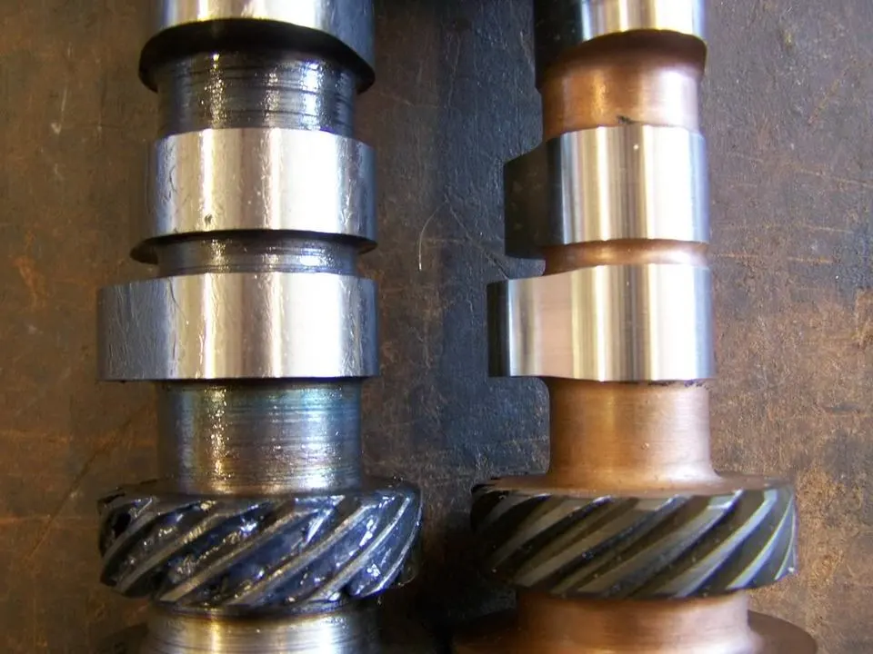

Most retrofit cams are ground on a reduced base circle...
There can be issues with the reduced base cams, especially in performance applications...
My suggestion...
Either run the expensive link bar hyd lifters (which allows use of a standard base circle cam), or use one of the following...
Hyd flat
solid flat
solid roller
all of those should fit without issue...
Here is a pic of a standard cam next to a reduced base cam....
(standard on the left, reduced on the right)
