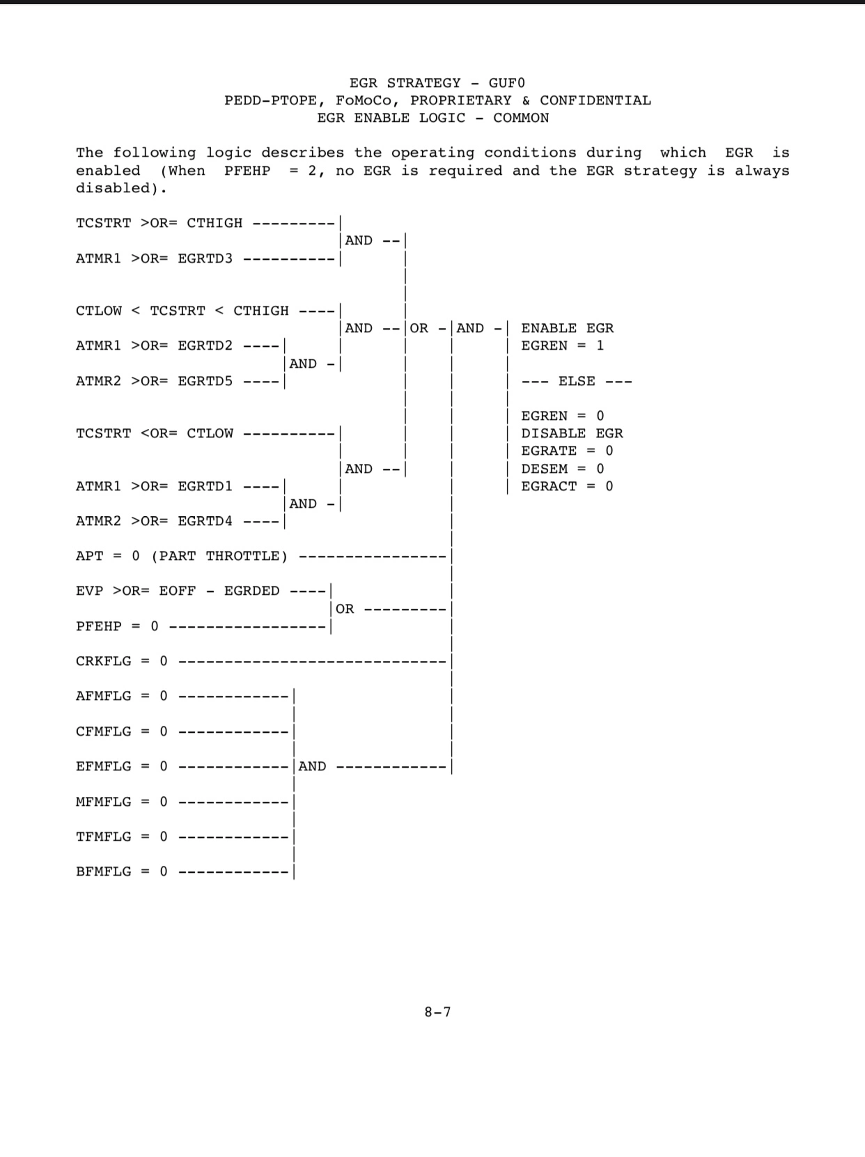

Here’s the actual EGR strategy from the A9x as written by Ford. We will ignore the “confidential and proprietary” statement and don’t ask questions ;)
This section is 30 or so pages long so I just snapped the most relevant. As you can see, throttle condition is one of the criteria.
APT of part throttle is 0. Idle would be -1 and 1 is WOT. (This is explained on a different page) The only allowable condition to allow the EGR to function is part throttle, otherwise the system self-disables until the 0 condition is met.
More importantly, LOAD is a bigger part of the equation as to when the EGR is functioning. Even at part throttle, as the engine loads up (like going up a hill) the egr is commanded to disable. It would take 5 pages to show this.
In other words, when you need power it shuts off.
Also, just to add. If the EGR is disabled on the A9x, it also disabled “decel fuel shutoff” and “manual trans shift fuel shutoff” from the programming as well.
This doc is almost 600 pages of ECU function.

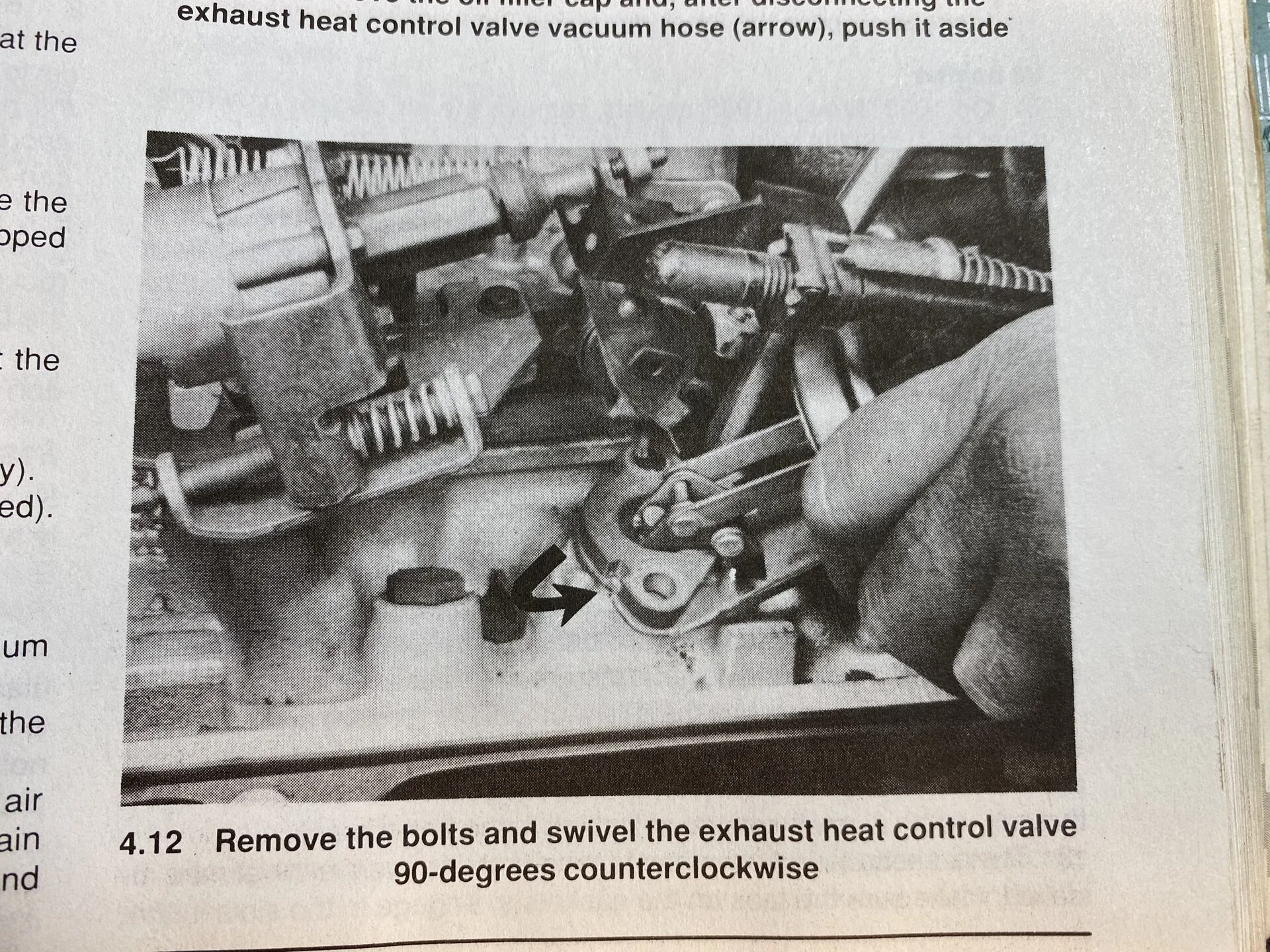

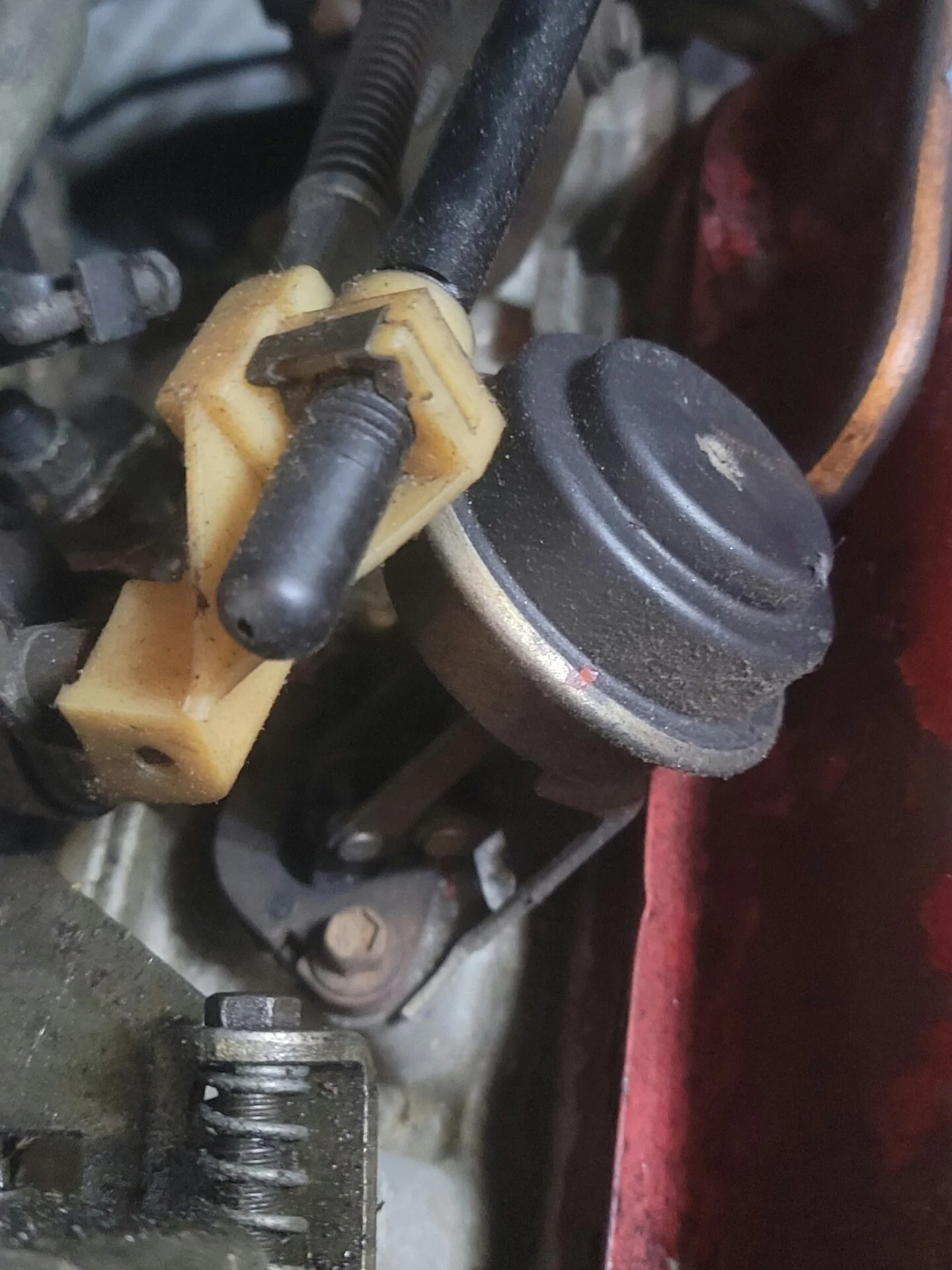

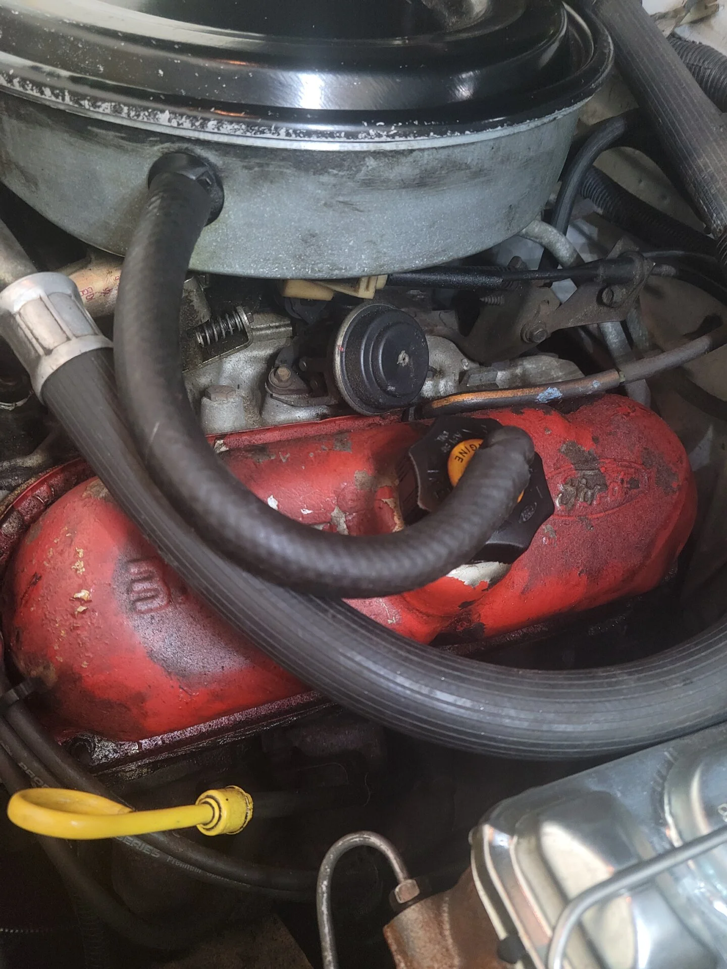

It’s labeled as an “exhaust heat control valve”
However I can’t find any additional reference to it.
This is out of my Haynes manual for the 1986 3.8
