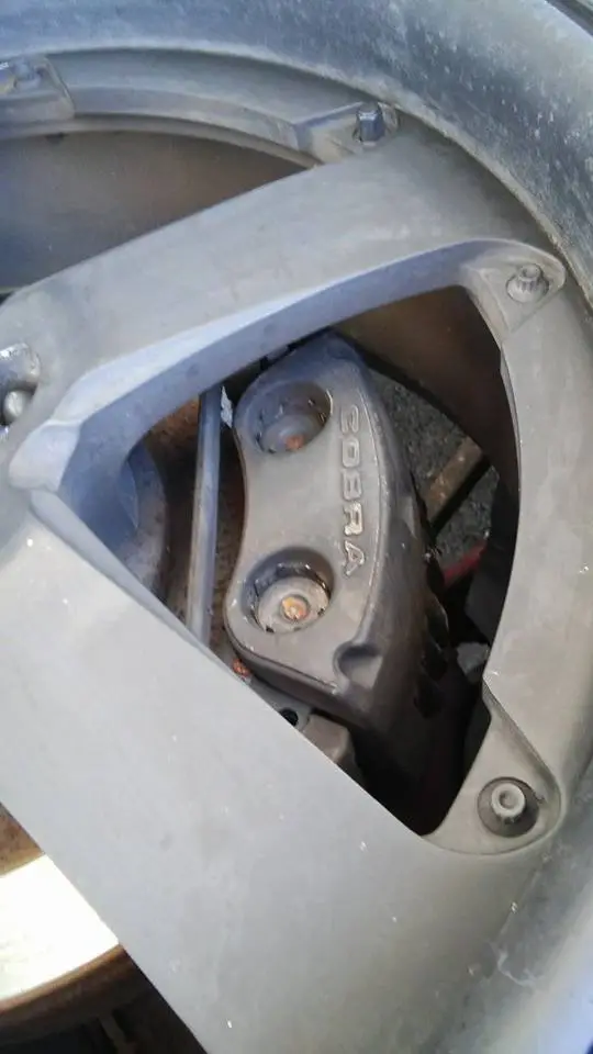

EDIT: Short version: It's such a wall of text, basically I'm trying to identify what year my brakes may be, my car is a 2000GT, and I guess just knowing if the 99-01 Cobra brakes were the same, that'd be enough. But my main reason for asking.. When I come to a stop, right at about 3-4 MPH, the brake pedal very gently vibrates a bit and gets slightly stiffer, then as the car comes to a complete stop, the pedal feel goes directly back to normal. This isn't intermittent, it's always, since I bought it, about 2,500 miles, no other issues, they perform very good in fact.
I bought this car about two months ago, mostly just because I spotted it at an incredible price, and I don't need to daily drive it. Normally I wouldn't go anywhere near such a heavily modified car, but what can I say, I haven't had a 'fun' car in nearly ten years, and when I test drove it, it just infected me.
So, I'm not expert, and I've only ever owned GT Mustangs, except for a Fox body LX I had way back.
So my question, this car (2000 GT Convertible) has Cobra brakes, but I have no idea what year they're from. They are definitely not the Cobra R brakes, and so I'm assuming 99 - 01 Cobra, and I just don't know if there's any difference. All I have is a picture, if it's not good enough I can take a few more pics later today. If there's anything else I can do to help identify, please let me know. Also I fully understand how... complicated I may have made things for myself by buying such a modded car without even being a novice mechanic. Basically, nothing is stock except below the heads, everything has been done. I'm still figuring things out as I go along. Sorry for rambling, here's the pics I have.
