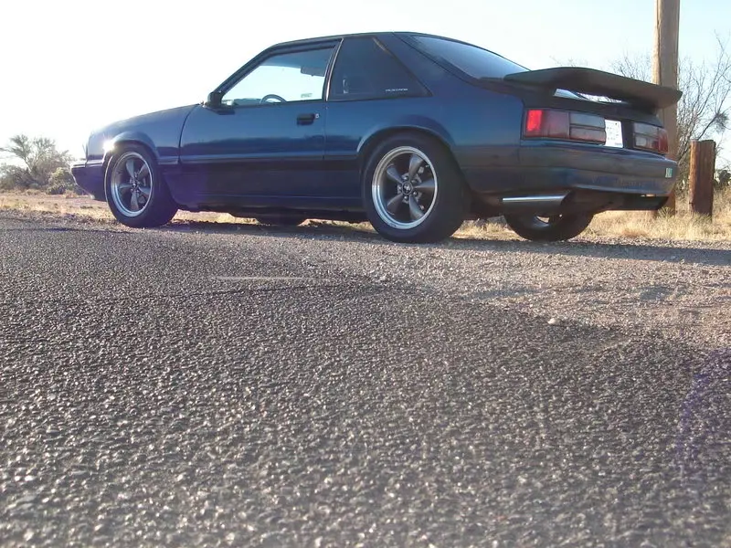

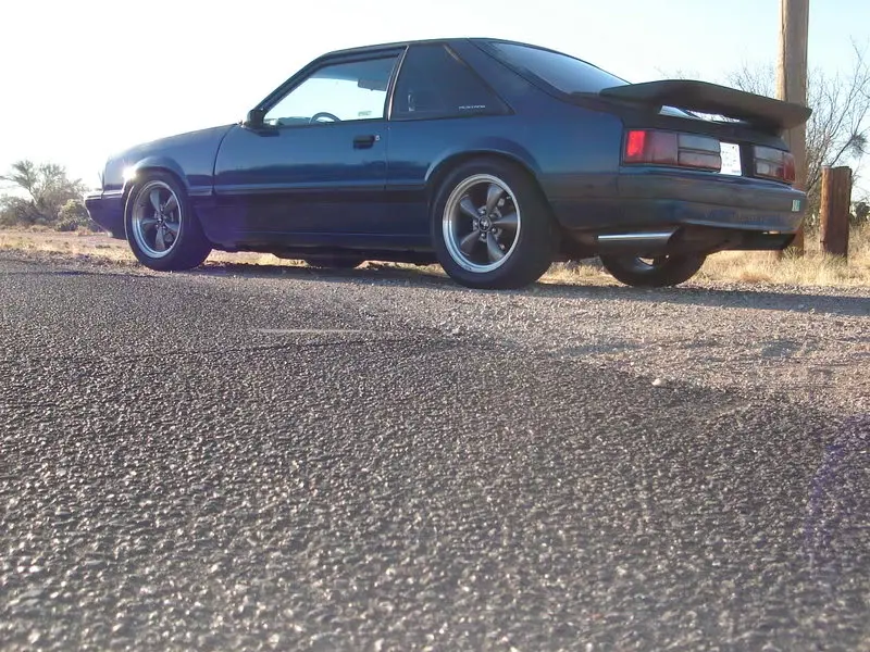

I've got the Eibach Sportlines on mine, and it sits pretty low. I think it looks great, but kinda sucks if someone wnats to ride in the back. There is really no trouble getting over speedbumps though.

Exactly why I dont like mine... When you load up people it gets bouncier than heck..:nonono:
