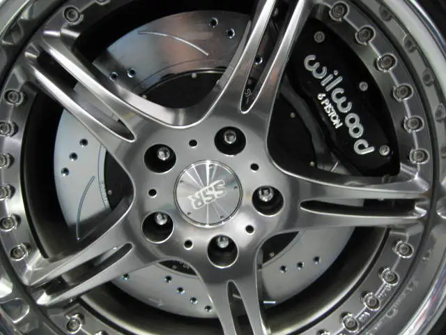

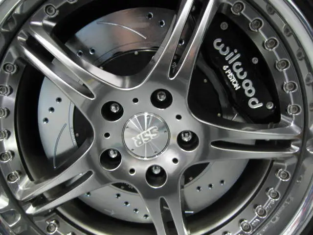

My vote is Wilwood too! :nice:

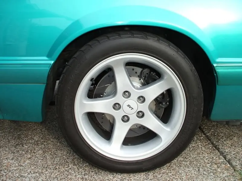

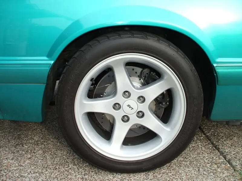

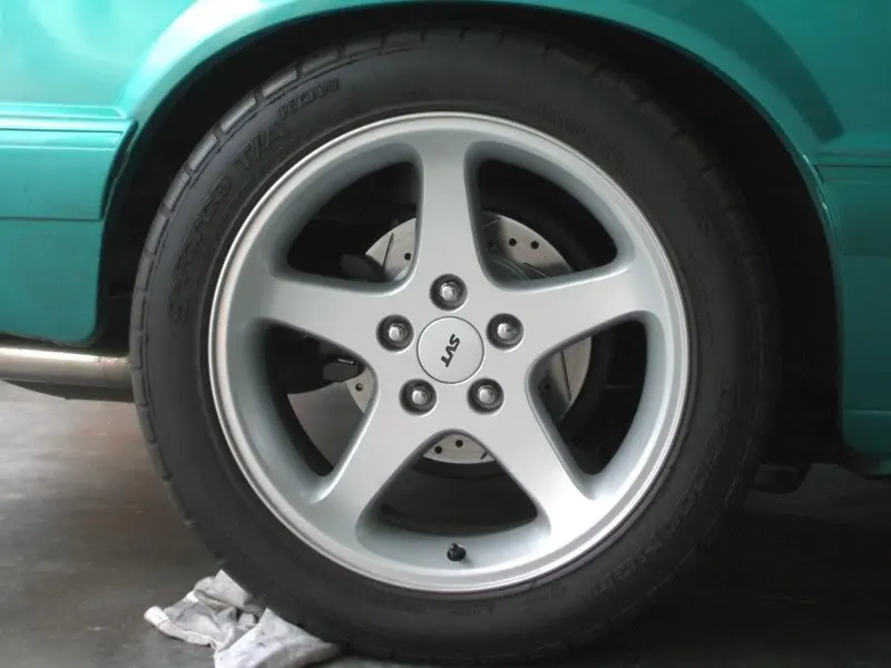

Fronts I went 5-lug conversion using 94-95 spindles, 03 cobra calipers, 13" cross drilled & slotted rotors.
For the rear I did 5-lug disks using stock fox axles, modified 94-95 caliper mounting brackets, and stock GT calipers and cross drilled & slotted rotors. Also installed a 94-95 master & booster. Spent way under the 3k you want to spend.

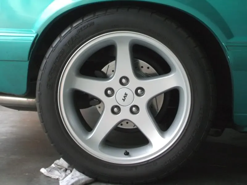

Cobra should be pleanty good all the way around. I can feel my seat belt holding me in for sure sometimes when I'm coming down from 130+ lol peaced it all together for about 1500. Calipers, and rotors were bought new. 95 Cobra booster. Bought the rear disc kit off ebay, and just got cobra brackets for the rear to fit. Everything was bought off E-Bay.
