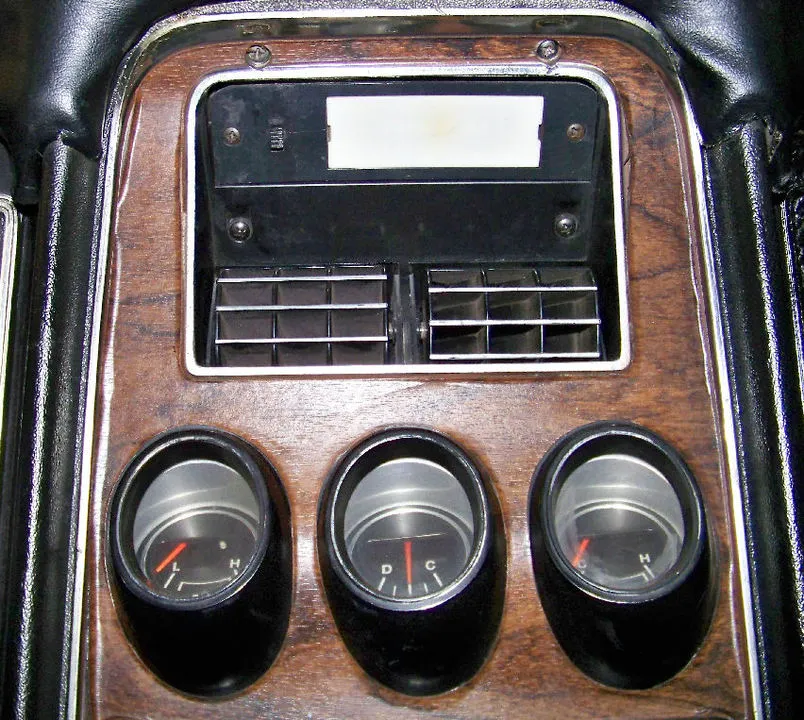

Here's the center console with all available options. The center light was an option, so if this was not originally on your car then it should have a piece of plastic there instead (as you mentioned). I believe the center vents are only provided on cars with AC, thus I assume yours does not have AC. I only have the light on the 72 Coupe Grande and the 73 Mach 1. The regular coupes have the block-out plastic piece. The only one with the gage cluster is the Mach.

Thanks for the great photo. I'm pretty sure the way my car was optioned that I didn't have the light. As far as under the hood, my main concerns are the strut tower braces and the hood latch. My appear to be some shade of blue. I'm not really sure, but they definitely don't look like they were black. The problem is, they may have been replaced due to front end collision many years ago.
