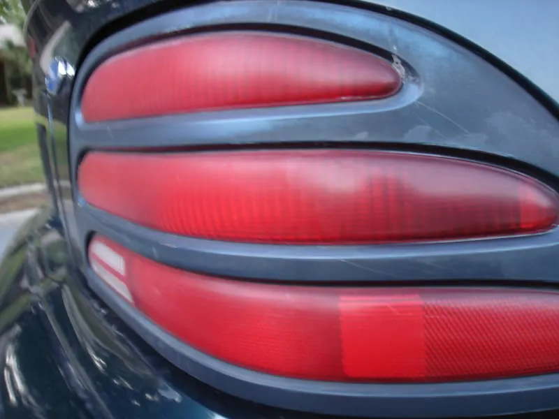

So the tail lights on my 95 Cobra are getting a little faded. There is some debate on how difficult it might be to repaint the housings.

Painting still doesn't help the cloudy plastic lense material. I masked the lense and used PlastX with a Powerball. It helped a lot but its not as clear as it should be.

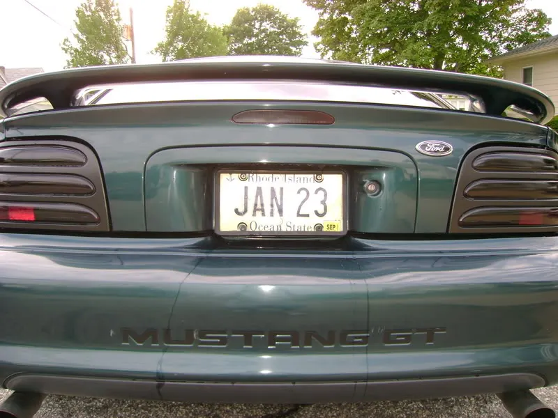

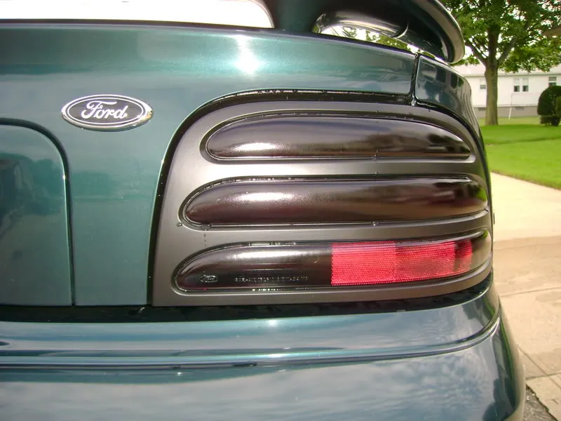

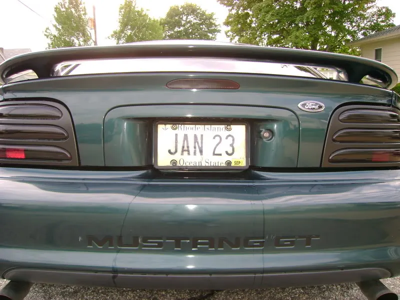

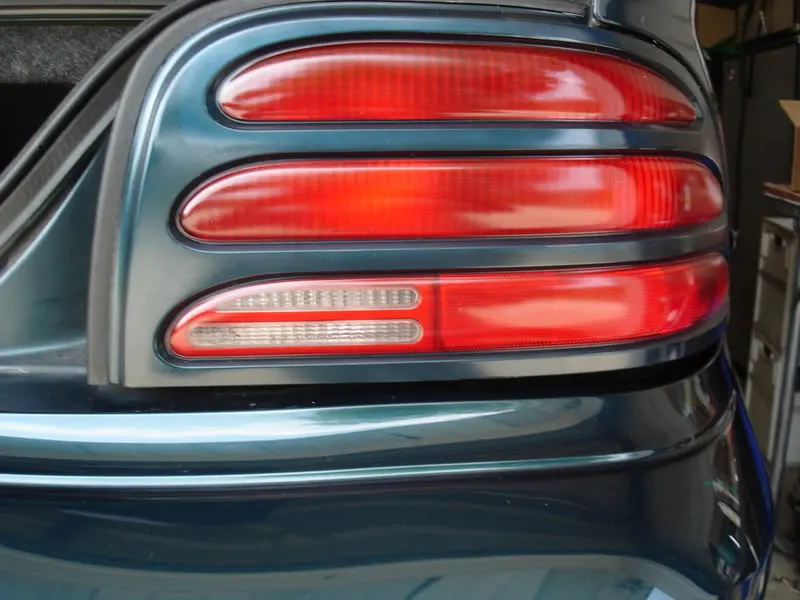

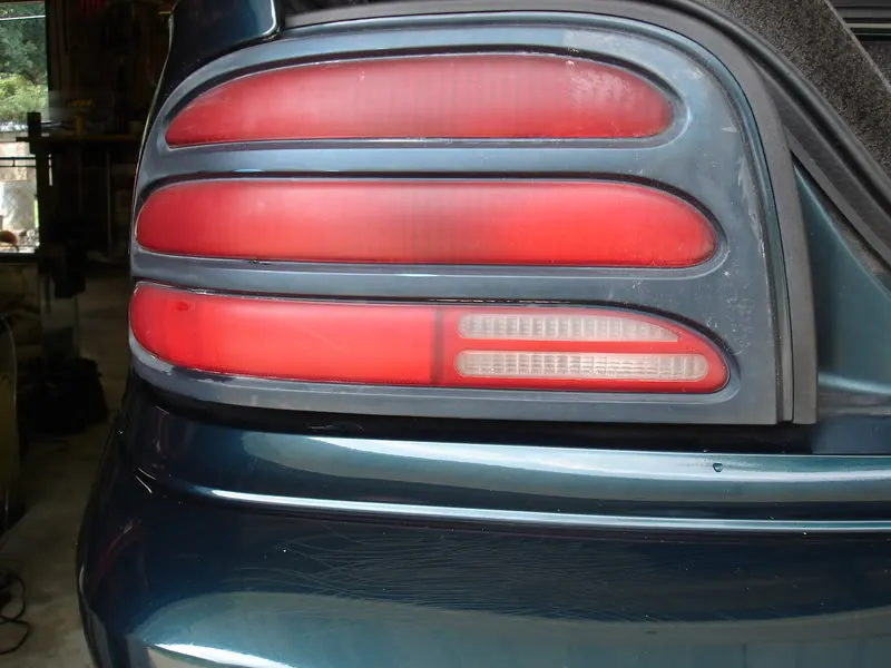

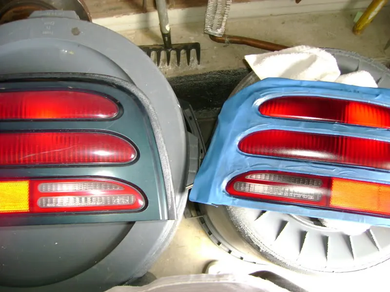

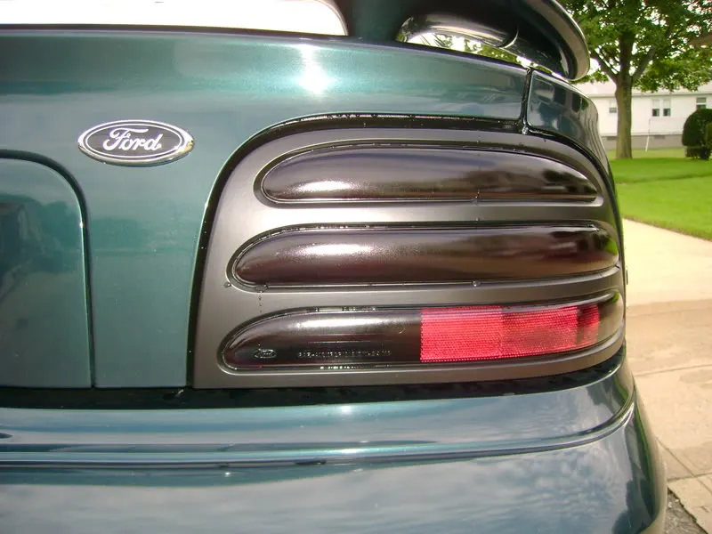

mine were cloudy... i just tinted them, and now u DEFINITELY cant tell... altho mine werent originally bad, they were just very faded as well as the green around the tail lights...

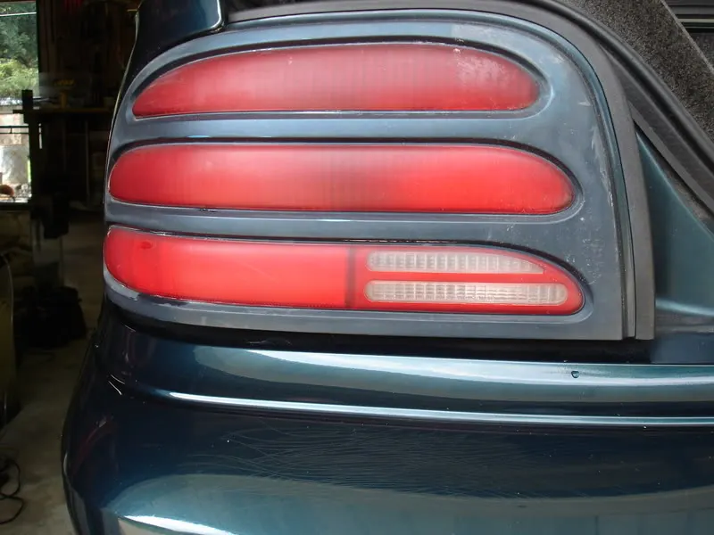

heres a before shot when i started to mask them off... what we did was masked off the entire trim, did the lenses first, then masked the lenses and sprayed the outside...
you get the idea...

HOW DO U TINT THE LENSES LIKE THAT!??? can u buy them tinted form anywhere
Like said Above you have to mask off and use VHT night shade.

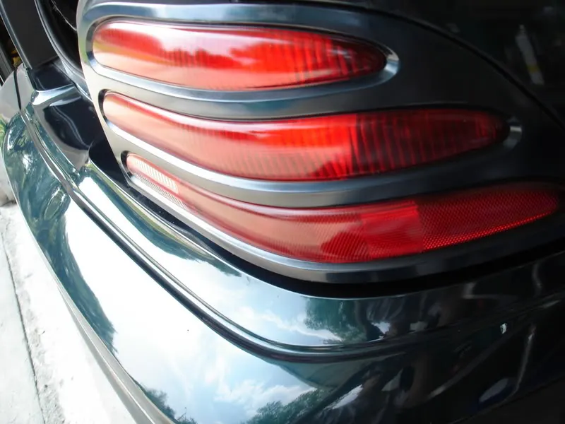

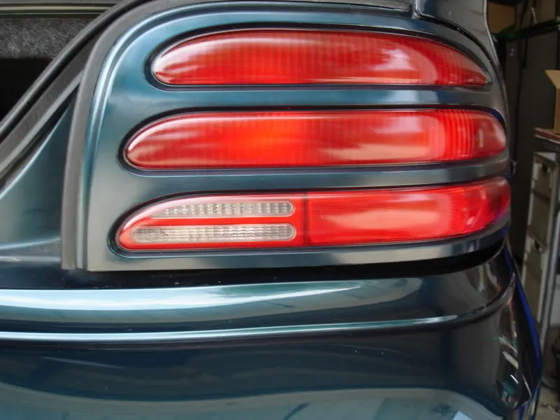

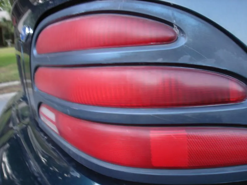

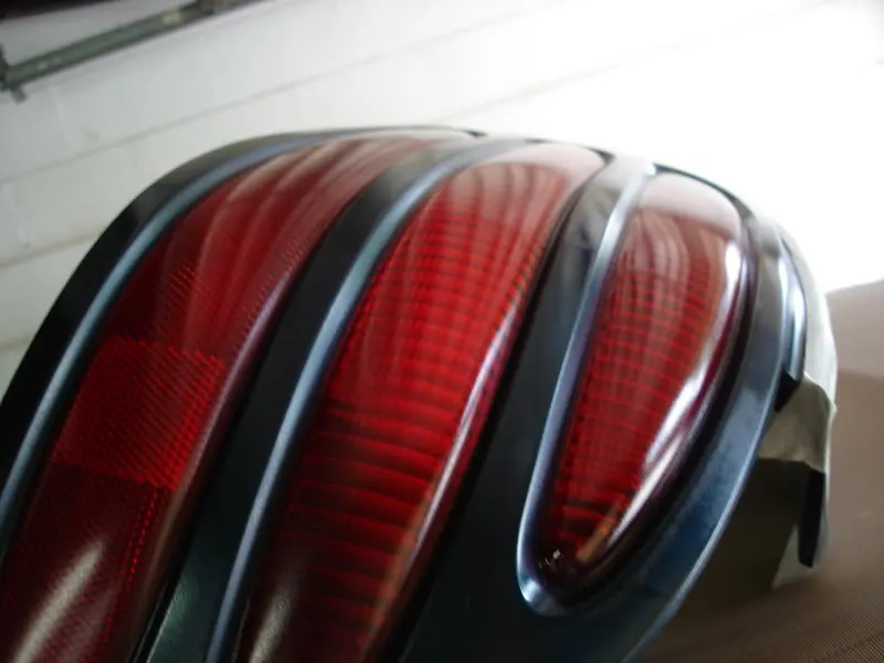

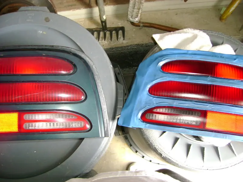

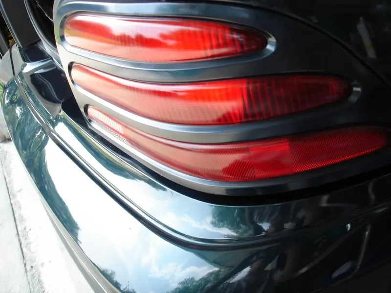

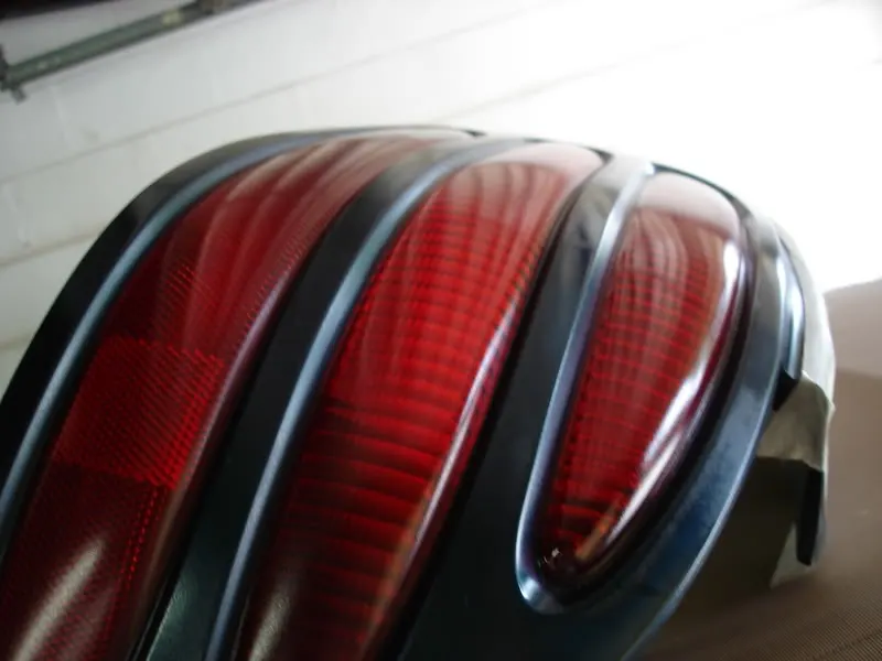

Heres myne
Heres after i wet sanded with 1000 grit sprayed with clear wet sanded with 1500 then 2000 grit.:nice: I only masked off the black trim.

I did as described above with my factorys.My 97's I sanded then painted with VHT Niteshdes then I put 4 coats of clear down wet sanded the clear with 1500 and then 2000.Then buffed them with poorboys ssr 2.5 then 1. Then a good coat of sealer.
