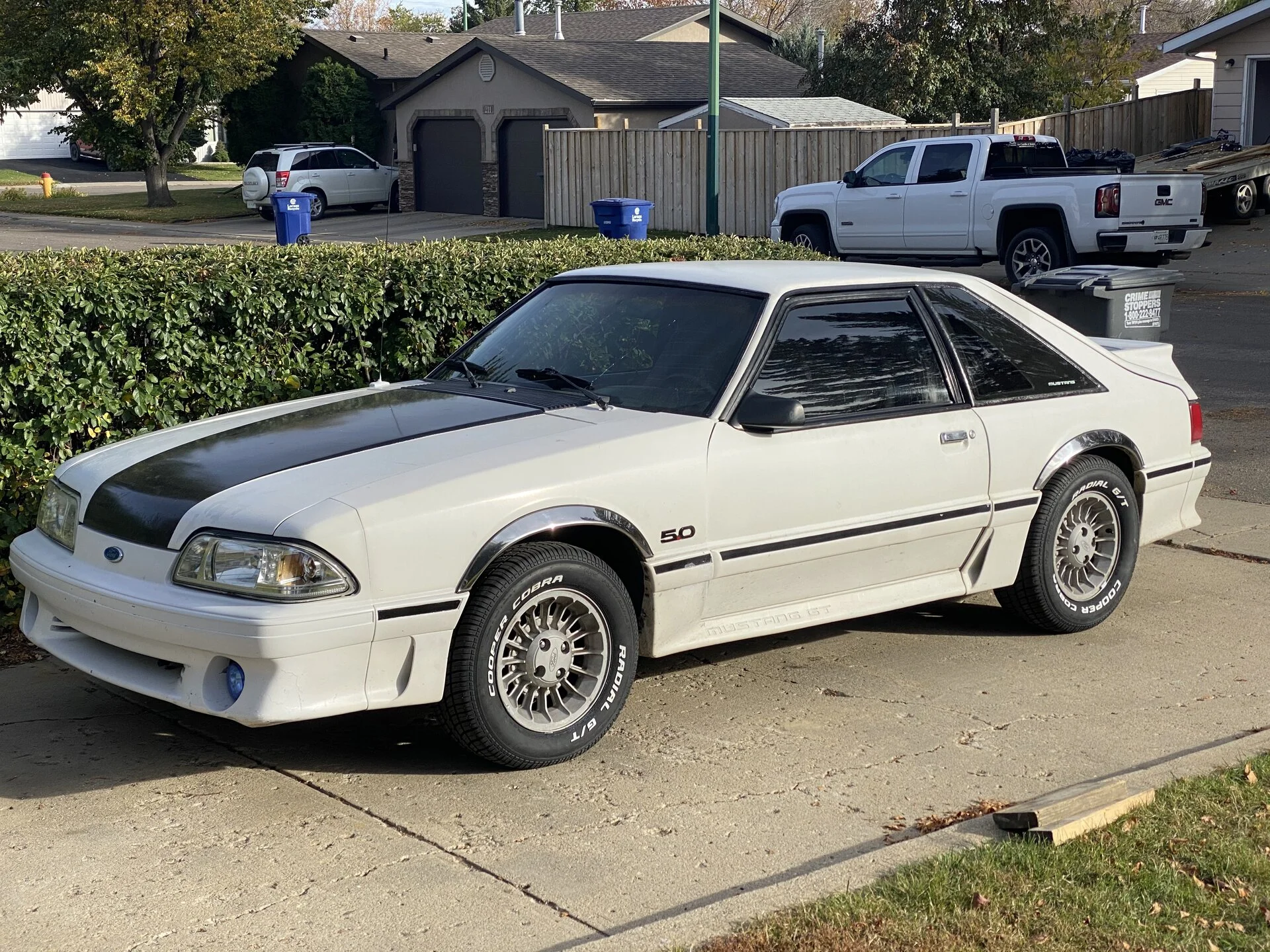

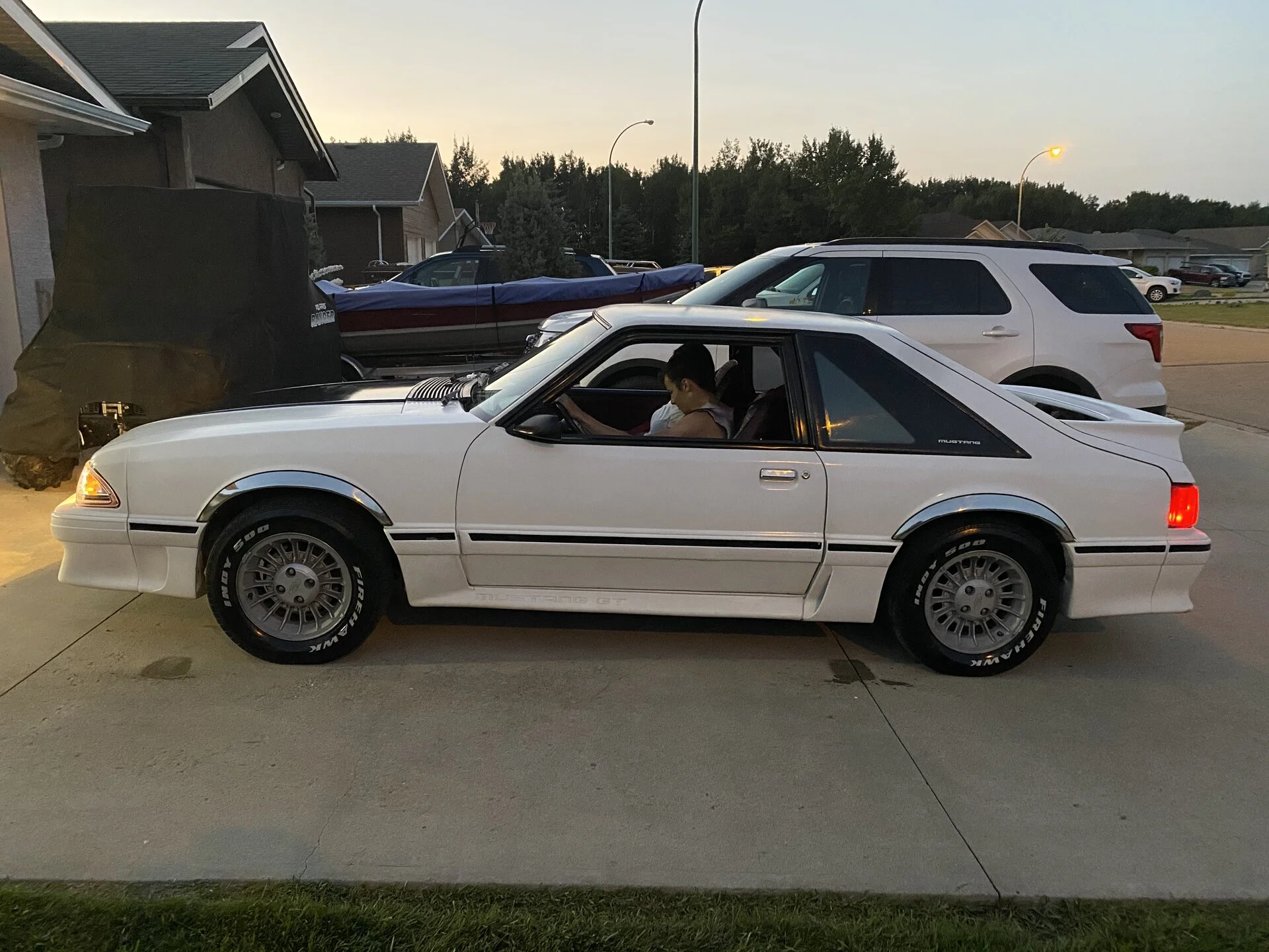

The car will be a daily driver. I don’t have to put 255 on if there going to cause problems, thats 27" tall and 10" wide, Cooper does make a tire in the 245/60/15, thats 26.6 tall and 9.6 wide. It looks good with the 235 it has now. Just wanted a little wider in rear. Here’s a couple pics
