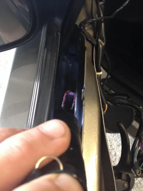

Inside the door, there are 2 steel window guides. One forward of the door and one at the aft. The forward one is missing the plastic guide and so as it turns out, the steel nub attached to the window is banging around in the track without the bushing and regularly falls off track. All the mustang outlets only sell the bushing kits for up to 1993 mustangs. No one seems to have the bushing for 94-04 mustangs. Surely there are a bunch of 94-04 mustangs that require new bushings> Can anyone help me with this?

Is yours accessable at the moment to where you can take a pic of one of them? I may be able to cross reference one for you if I knew the look of one. I have the same era but do not feel like taking my door panel off to see one. I know what they are, it is just some vary in thickness and OD, some are even square instead of round as they both work the same way.
Hi thanks guys. Yeah I called ford parts again. The guy saw the bushing I was looking for but ford has it listed with the window and not individually. It's the forward one that looks like a square. The rear one looks like a round disc. I'll go pull the panel again and try an get a pic
The guy really wanted to help but he hit a wall. There was no way for him to even get a part number for it. He thinks you probably have to order the whole window.
Anyhow, here is the bushing I need and also a pic of the square track it rides in. You can see how the one side of the ears is broke off
Yeah that sounds good. Maybe I don't need a new one. Just put the good side on the weight bearing side huh.
Looks like I have to remove the whole window to get that back on there too. I can't reach the thing to even put it on
