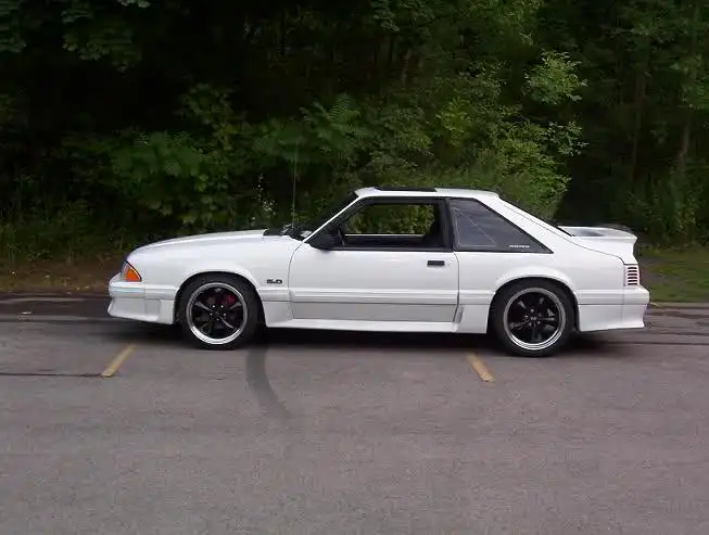

yeh, if you can avoid it, dont cut em. Mine is cut and I hate it. Rides like a damn log wagon. When you hit a big bump it sounds like the body is being ripped from the frame!! lol Im gonna get the eibach sportline when I get caught back up from Christmas. Heres a pic of mine though. coil and a half front and rear
