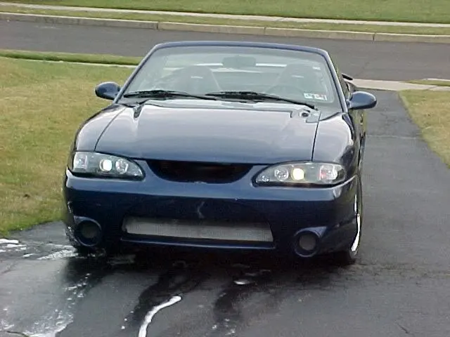

What kinda pics do you need? Here are a few pics I have hosted on the web, I can look for some more on my comp when I get home later.
you can sorta see how the exhaust hangs in this pic
Yea, they came with the kit (have SVO stamped in) and yea they are full length. They attach with: about 8 (I think) brackets under the car, a screw at each end in the wheel well, and molding (double-stick) tape at the top under the door.
You're gonna love the compliments you get :nice: Take your time putting it on and adjust things till its as far up as possible. When I first put mine on, i was in a hurry and also didn't tighten a couple joints as much as I should have, well over time things got damn close to the gound and scraped alot, so I had to get under there and put everything back to where it needed to be.
If you take your time and put it on nice and snug against the bottom of the car you wont have any clearance problems like I did.
I'll post up some more pics in an hour or so when I get home.
BTW...91LX_5L has the xenon front you are talking about.
