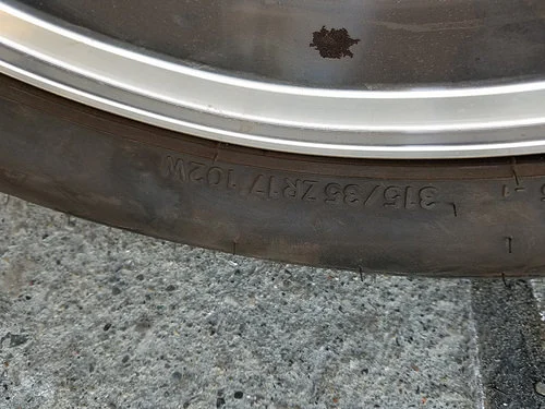

94-04 can fit a 10.5/11 inch wheel with a 315 or so tire pretty easy. Pending you stay at 26 inches tall.
Lots of combo's and possibilities. The new edges seem to be just a tad easier. Most combos will require a rolled inner fender lip if you're lowered at all.

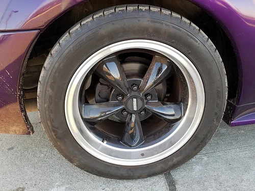

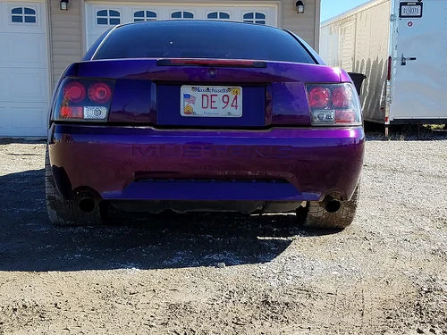

This is my '00 w/ 2002 GT drive train. No tubs. 315/35R17s. Plenty of room. You just have to get the back spacing correct.
