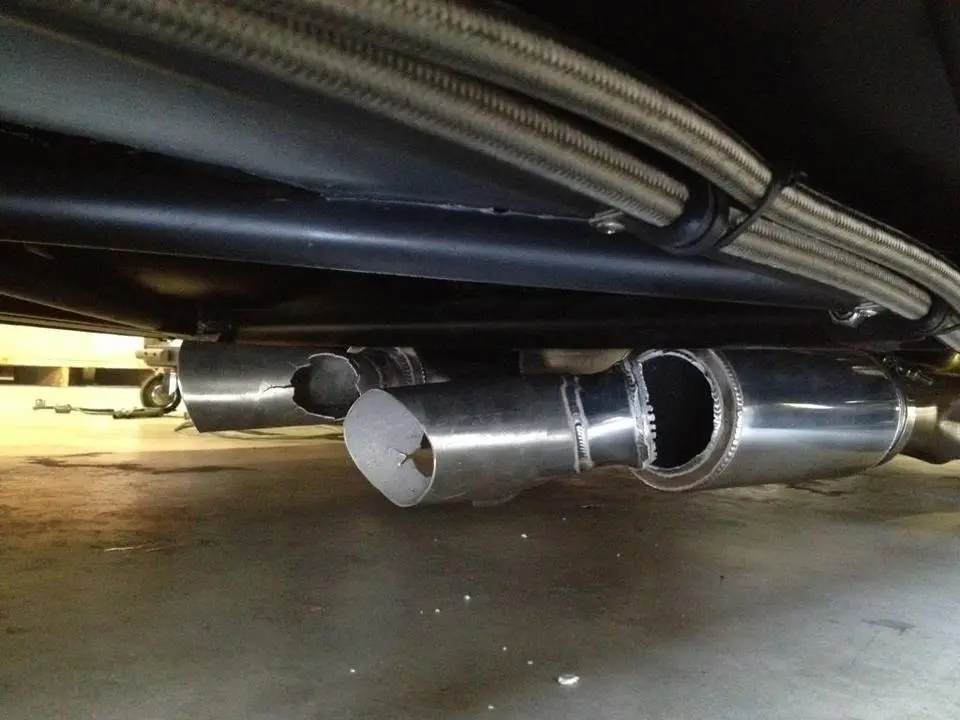

My supercharged 351W literally blew the 3.5" mufflers apart.
