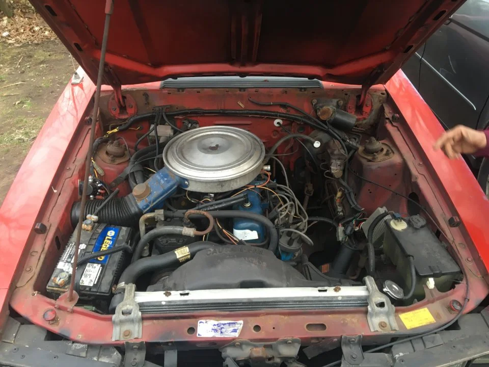

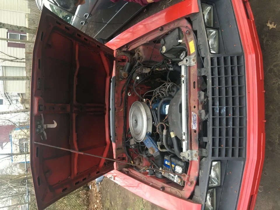

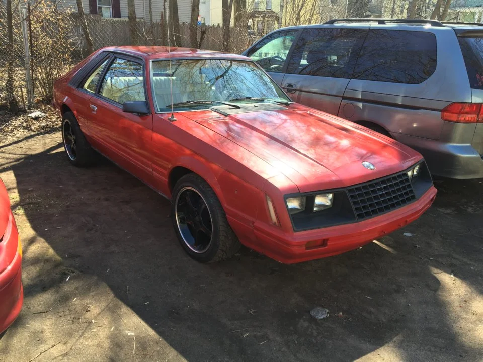

Hey, first time posting but I have a 79 v6 3.3 mustang and I don't know which directions I should go with it. I don't know if I should swap the engine or work on the v6 I currently have but if I do choose to work on it I don't know what to really do to it

Umm it's a straight 6 not a v6;)
Not sure of your question. Those motors suck,if you want better performance, switch it over to a v8. That requires a few extra changes and will cost some money. If you just want something to get you from point A to B and it just needs general maintenance and/or a few parts...that's the cheapest option.

Put a big badass motor in there! That is a fantastic starting point you have there, That i6 is great for an old work pick up truck that is rusted to hell.
That pretty little thing there needs some power. Go to the jy and do some serious picking, unless you already have a V8 lined up? You'll need a few things to upgrade to the bigger motor, the rest of the drivetrain for example. suspension upgrades will be important.
Take it to task, study a bit and see for how little money you can accomplish it. If all fails, sell me that car, I really like it.:D
A v8 will require k member, tranny, tranny mounts, might as well upgrade spindles and control arms, 8.8 rear, new drive shaft, yadda yadda yadda...
Best bet is to get a clapped out 87-93 and swap all the goodies over. Otherwise keep that straight 6 chugging along.

Whatever you do, keep the 79 front clip and interior. You just don't see those anymore.
