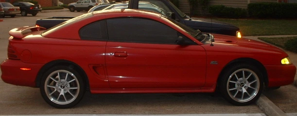

You can fit up to 275s safely on a 17x9" wheel, although I have heard a few who got 275s complain about tire rub.
With your body kit, I say definitely go with the cobra r replicas. That style of bullitt will not look good IMHO on a car with the xenon kit. What are your choices for backspacing? Offset is generally around 25mm for mustang wheels give or take. A good reference is AFS's website, they list their backspacing and offset there. If you are going to get 17X9 for the front and rear, I'd get the rears with a little less backspacing than the fronts, this will push the wheel out somewhat and help with the "tucked under" look our cars are notorious for.
