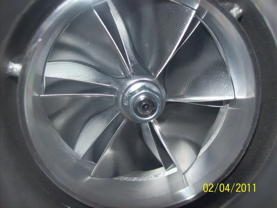

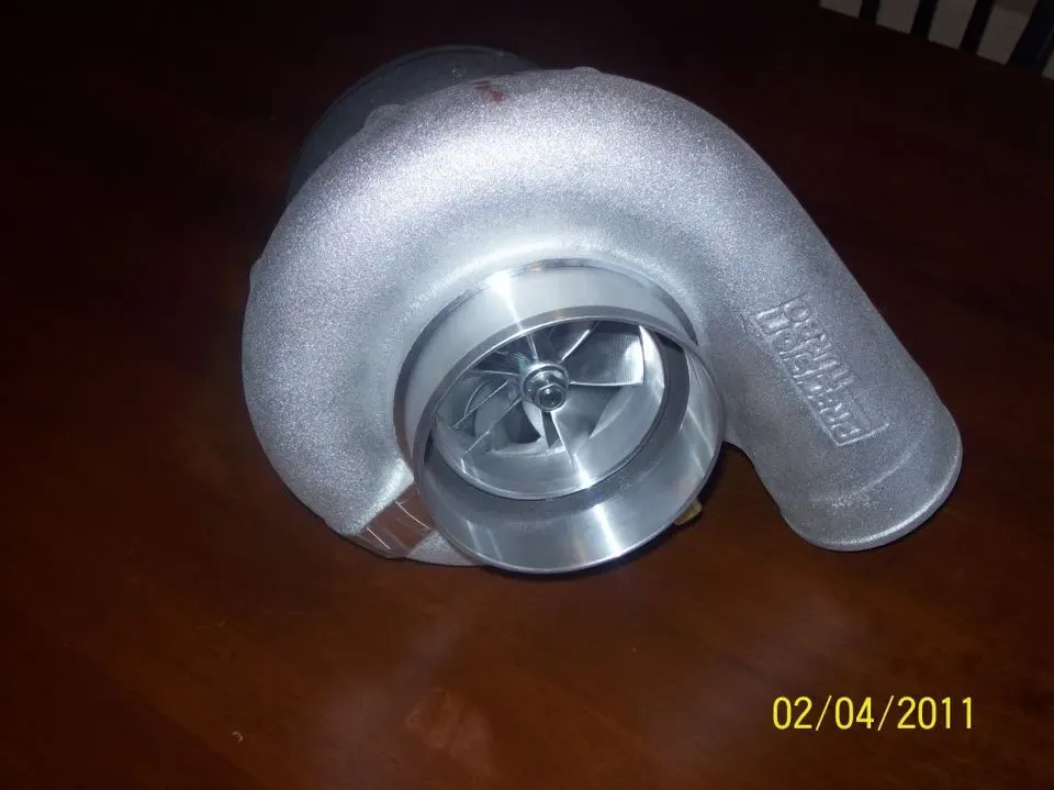

I bought a big 88mm about a year ago. After seeing guys run in the 7's with it I realized with a goal of 9.11et that was abit overkill haha. I sold it and the 70mm that was on the car last month and got this one. It will bolt right up.
That 88mm woulda req'd lots of fab, 5" dp, large injs, and more.
This one is rated at 400hp more than my 70mm

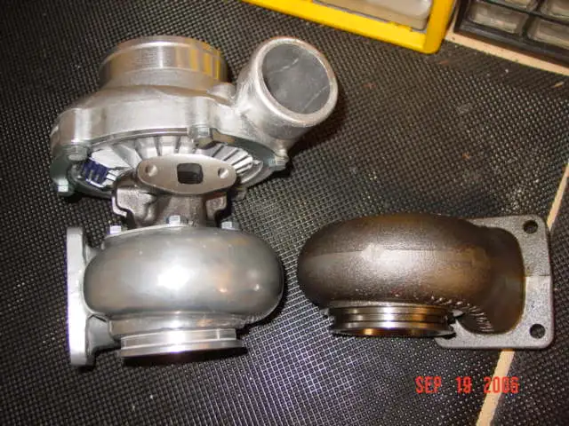

The exh housing will likely take 8-9 hours to get smooth, they are a bear!
Once they are smooth i will get them ceramic coated, I think the smooth look makes it look that much better. Most didnt even notice I did it on my last turbo, but I sure did!
It will be a process like this, this was from the MP turbo when I did it
Almost done sanding, comparison pic from untouched housing I had
Then coated
I also sanded the compressor side smooth, and all the lettering etc was gone so it didnt say MASTER POWER on it real big, then hand polished it to look chrome.
Only diff this time is I will coat both housings
Very nice! That does seem like a more reasonable turbo for your goal. What do you plan to trap?
Much more reasonable haha. I have seen guys go in the 8.70 range at 156-157 with this kind of turbo, but for an avg joe like me that will never happen. Alls I hope for is that 9.11et but even that is asking ALOT from this turbo. I would think the car will go 145-147mph no problem.
